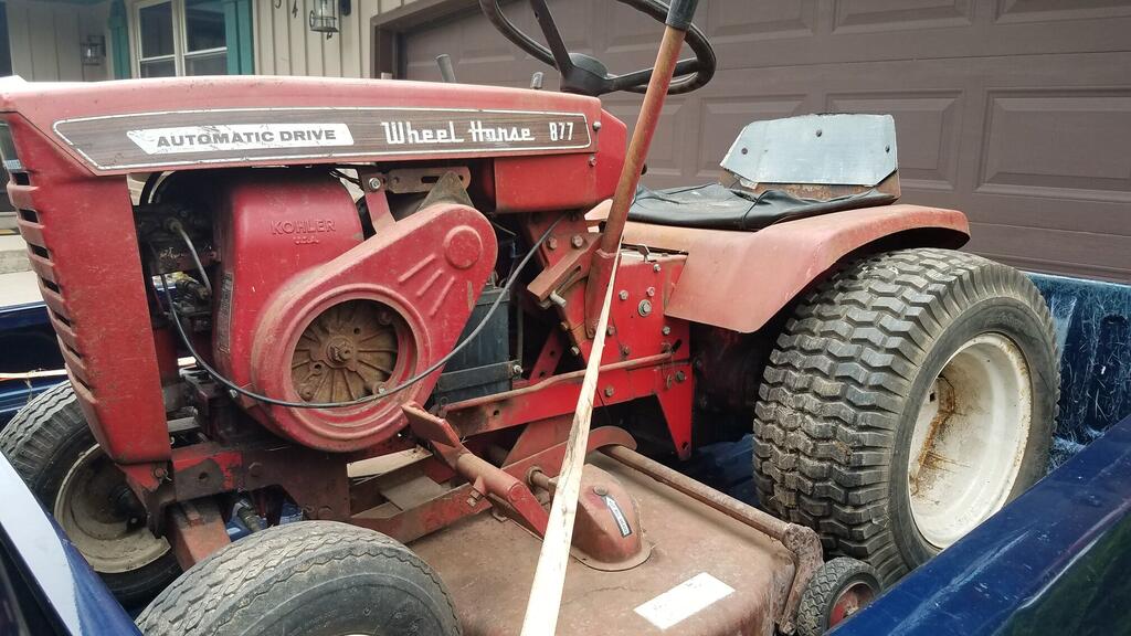

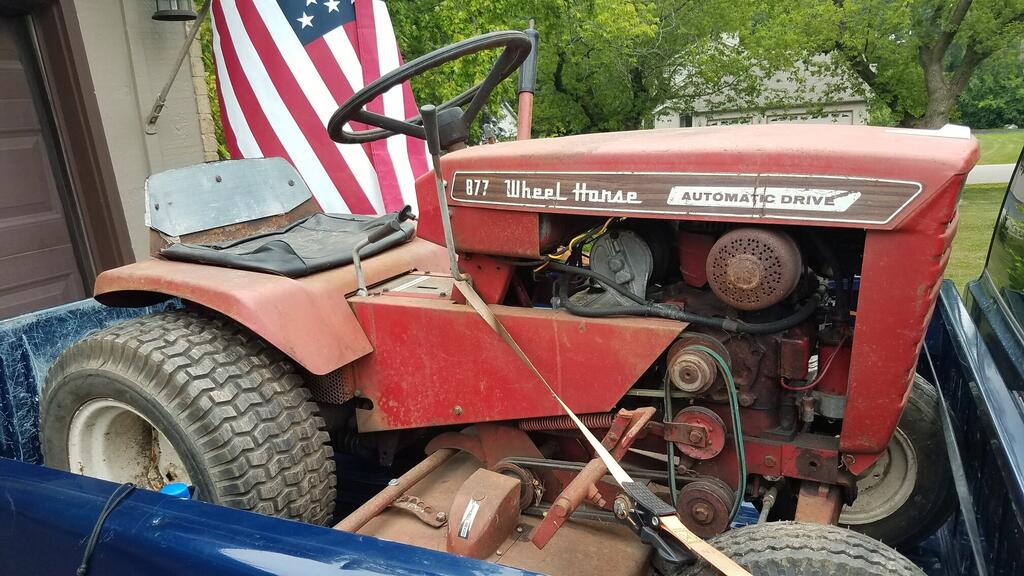

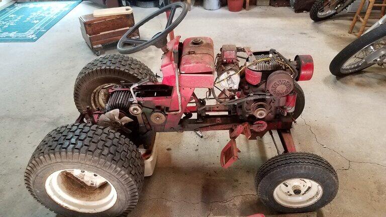

Crazyredhorse 296 #1 Posted July 12, 2021 Look what followed me home.more pics as I work on her.flags a nice touch heh 7 3 Share this post Link to post Share on other sites
AMC RULES 37,259 #2 Posted July 12, 2021 Nice W-H score. Love that model. Sure do miss mine. Share this post Link to post Share on other sites
squonk 47,990 #3 Posted July 12, 2021 I thought tractors in Wisc. didn't come with steering wheels? 1 Share this post Link to post Share on other sites
Crazyredhorse 296 #4 Posted July 12, 2021 bit bent but I do have one of those old 3 spoke foam wheels for cars I could mount.see what happens. Share this post Link to post Share on other sites

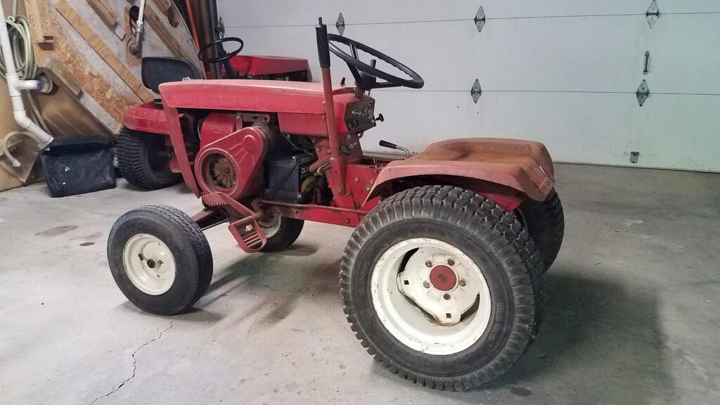

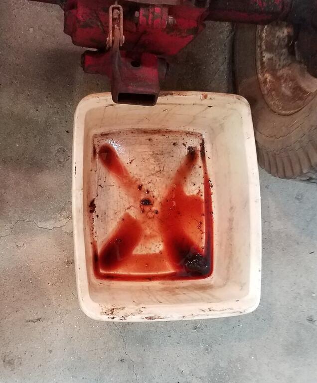

Crazyredhorse 296 #5 Posted July 14, 2021 so I've done a little work on it.for the most part it's in good shape.havent fired it yet but older gentleman I bought it from says it runs.needs some work on deck wheels n mounts.the only thing I'm seeing is its leeking around the axle hydro area seems on top more than bottom.but being I havent run it yet seems more than I want. going to give it a power washing so I can tell were its comming from.but other than all the surface rust looking good. Share this post Link to post Share on other sites
Crazyredhorse 296 #6 Posted July 17, 2021 Yea she runs!!!but gas leaking from pump and metal line from pump to carb.should I (rebuild if I can)pump or go with an electric pump what's your thoughts going to get a carb kit too while I'm there. Share this post Link to post Share on other sites
Crazyredhorse 296 #7 Posted July 17, 2021 never mind tighten the screws on pump n cut some rubber gas line to put in fittings of metal line and it seems to have quit leeking.but runs good n hydro seems ok. Share this post Link to post Share on other sites

Crazyredhorse 296 #10 Posted July 21, 2021 Been taking care of the little problems but shes starting to clean up.thinking I'll get everything working good in the fall tear it down start stripping it over winter fresh paint in summer.needs some new seals and gaskets in the rear end too.looking deck over the deck itself in nice shape but shaft though frame of it is sloppy and someone welded pulley to one of the drive shafts.see what I can do with that. 1 Share this post Link to post Share on other sites

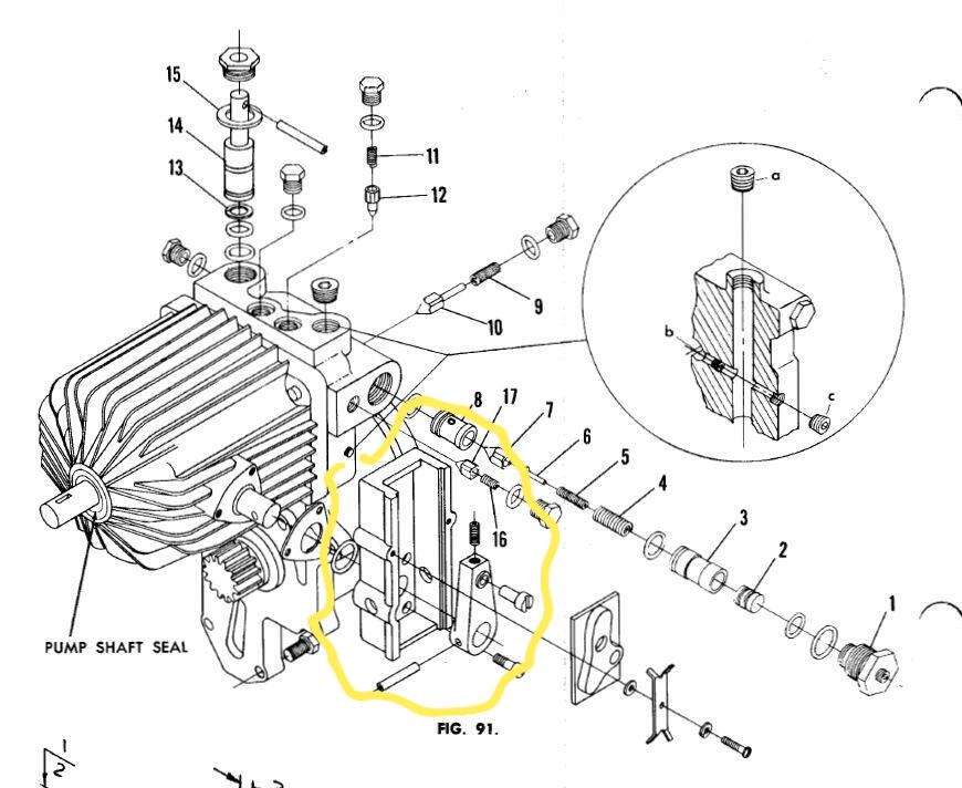

Crazyredhorse 296 #12 Posted July 31, 2021 So looks like I'll have to replace gaskets were hyd.pump attaches to axle and axle halves looking over info seems easy enough.guess I'll have to make gaskets says their discontinued.said to put p jelly on gaskets?should I use a gasket cement?silicone or somthing?is there any surprises I should watch for splitting these 2?thanks in advance guys Share this post Link to post Share on other sites
pfrederi 21,096 #13 Posted August 1, 2021 16 hours ago, Crazyredhorse said: So looks like I'll have to replace gaskets were hyd.pump attaches to axle and axle halves looking over info seems easy enough.guess I'll have to make gaskets says their discontinued.said to put p jelly on gaskets?should I use a gasket cement?silicone or somthing?is there any surprises I should watch for splitting these 2?thanks in advance guys The case gasket is 5999 (Lowell has them) Pump to tranny is 5955 you can use the later version 102759 still available. Do not use silicone RTV little chunks of that can come off inside and cause big issues. Really do not need anything I sometimes use a light spray of Permatex High Tack aerosol. Share this post Link to post Share on other sites
Crazyredhorse 296 #14 Posted August 1, 2021 Thanks shes leeking pretty good. hoping no cracks or anything.started tearing it down enough to power wash it real good. take off rear end then so I can look it over good.can only work on it about 4 hrs at a time till back starts hurting. but I'll get there.put the tins in basement were I can strip in a cool place. Share this post Link to post Share on other sites

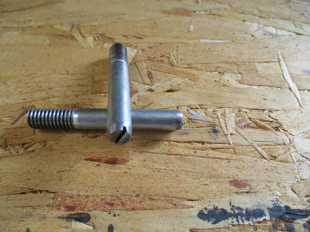

pfrederi 21,096 #16 Posted August 3, 2021 Make yourself two aligning pins. (3/8 NC bolt head cut off grind a bit of a taper to it and cut a cross slot) Remove two bolts holding tranny to frame end. Put in the aligning pins then remove the other 2 bolts and roll the transaxle/pump unit back. The linkage ball will come out of the plastic slider as you roll it back. (Lowell has the slider) Share this post Link to post Share on other sites

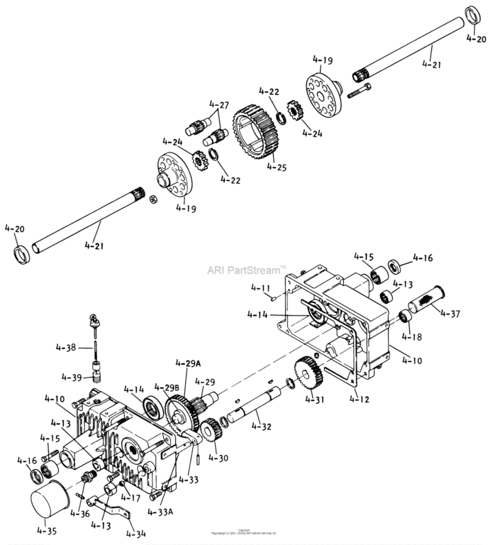

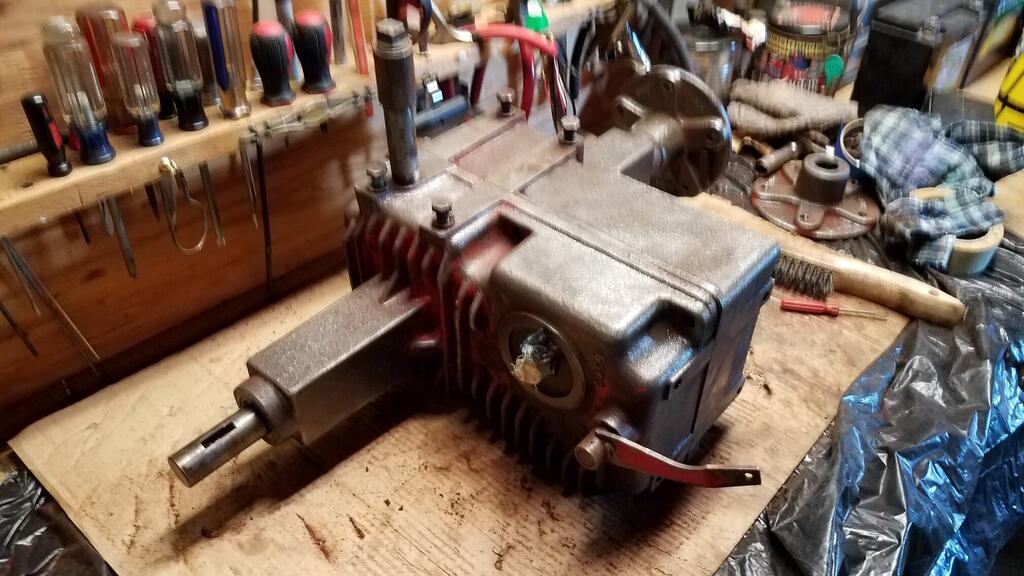

Crazyredhorse 296 #22 Posted September 4, 2021 (edited) ready to put tranny back together but have a question. on this dia shows a thrust washer 4-29b but if you look at sunstrand rebuild dia on this site for my year doesn't show one mine didnt have one.and shows some wear on case and gear there.does anyone know if it needs one on this.1967 877 or will 4-29B fit it? this diagram is from later model btw Edited September 4, 2021 by Crazyredhorse Share this post Link to post Share on other sites
Crazyredhorse 296 #23 Posted September 29, 2021 Back together. been stripping this rusted cruddy rear end for weeks almost ready for paint. just doing the regal red but going to use some hardner.shoul go little faster once the rear end is done.shes heavy and hard to work with. 1 Share this post Link to post Share on other sites
