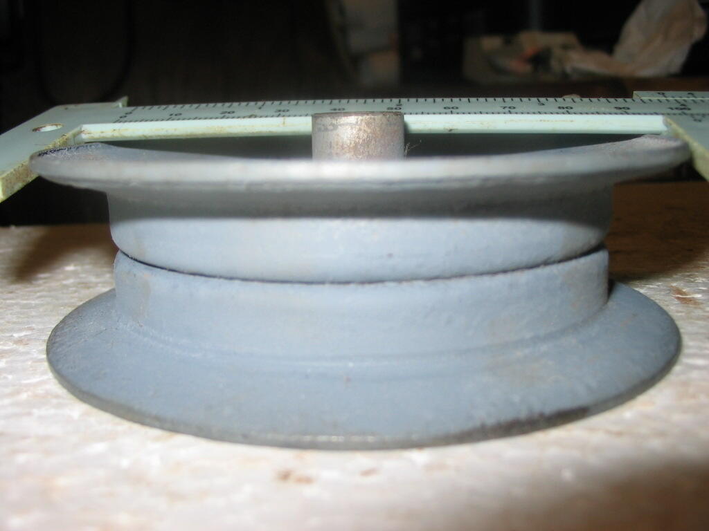

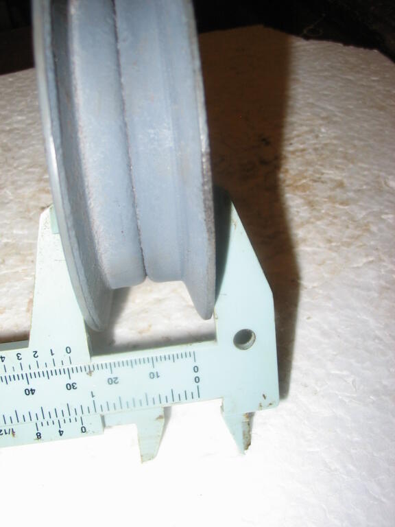

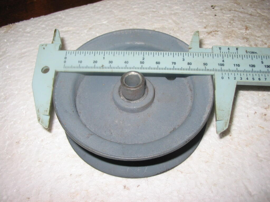

daveoman1966 3,884 #7 Posted July 12, 2021 4 hours ago, GEOD998 said: Can anyone recommend a replacement for a 78-8250 idler pulley.Its on a 0538SS02 deck hanging on a 244H, and I'm not I have the OEM Idler pulley for a 38" deck. Here it is. Bearing is smooth with no wobble or drag. It is 4" dia and 1-1/8" with on a 3/8" dia offset center shaft. Yours for $25...shipped. ps..the NEW pulley is over $70 bux. 1 Share this post Link to post Share on other sites
