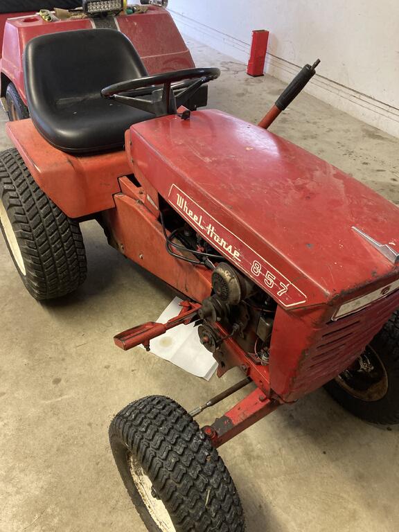

Ghost1 1 #1 Posted July 11, 2021 Greetings all. Just found forum and was hoping I can get some guidance about a battery issue. I recently purchased an 857 and after a few days had to charge battery.Scan2021-07-11_121632.pdf This morning I noticed a puddle of battery acid setting under mower. I found schematic and everything seems to be connected correctly. Is there a way to test regulator? Share this post Link to post Share on other sites

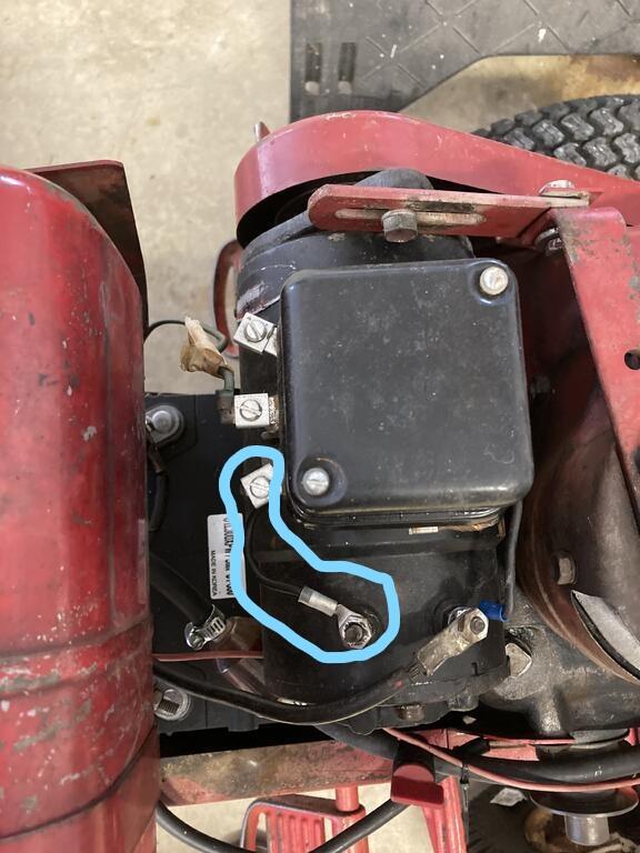

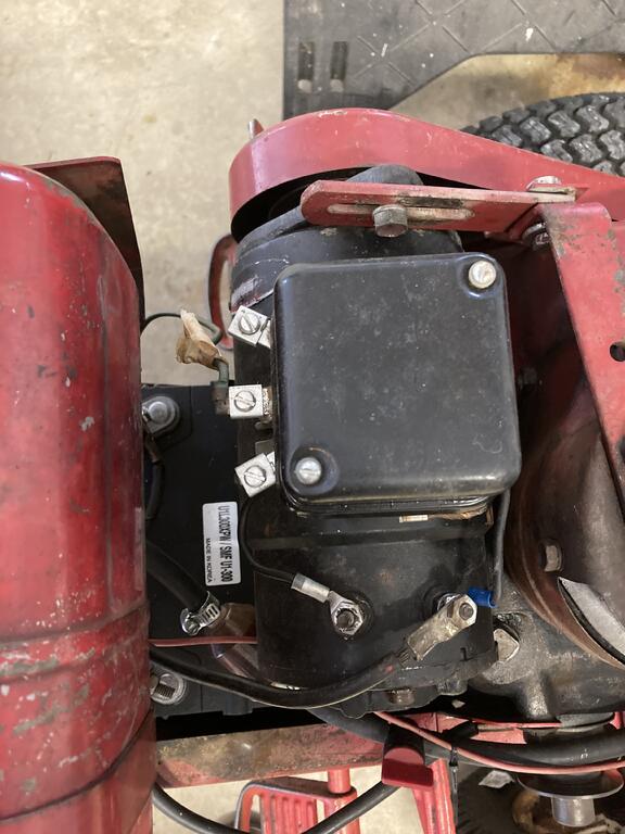

squonk 48,078 #2 Posted July 11, 2021 You need to replace that cable going to the generator regardless of what may be the issue. That poor connection could be causing higher than normal amperage to be flowing. It take more current to get the job done when the voltage is low due to shoddy wires 2 Share this post Link to post Share on other sites

Ghost1 1 #4 Posted July 11, 2021 Thanks squonk. Is this the wire your're referencing? Share this post Link to post Share on other sites

squonk 48,078 #10 Posted July 11, 2021 27 minutes ago, Ghost1 said: Thanks squonk. Is this the wire your're referencing? No. That big black ugly one next to it! Share this post Link to post Share on other sites

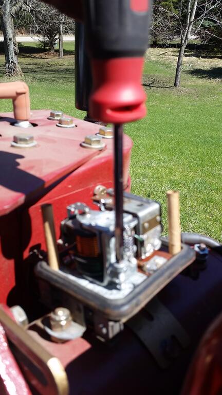

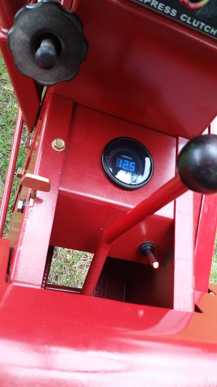

WHX?? 58,076 #19 Posted July 15, 2021 (edited) There is a way to adjust the max charge voltage on the regulator. I adjust to 13.6 six volts max on the DMM with engine running at 3600 rpm. Some tractors I have a voltmeter installed to monitor. You can get cheap 1" round voltage meter that you can temporary wire in to monitor until you are sure you have the regulator and other wiring issues dialed in. I would also suggest checking and cleaning the contacts in the regulator. As always check all grounds including that little ground strap that bypasses the rubber reg. mounts. Here is some info that might help. My Bad... 1 Checking a Mechanical Voltage Regulator.pdf DELCO-REMY_SERVICE_BULLETIN.pdf Delco_Remy_Generator_Regulators.pdf Edited July 15, 2021 by WHX24 My Bad 1 Share this post Link to post Share on other sites
