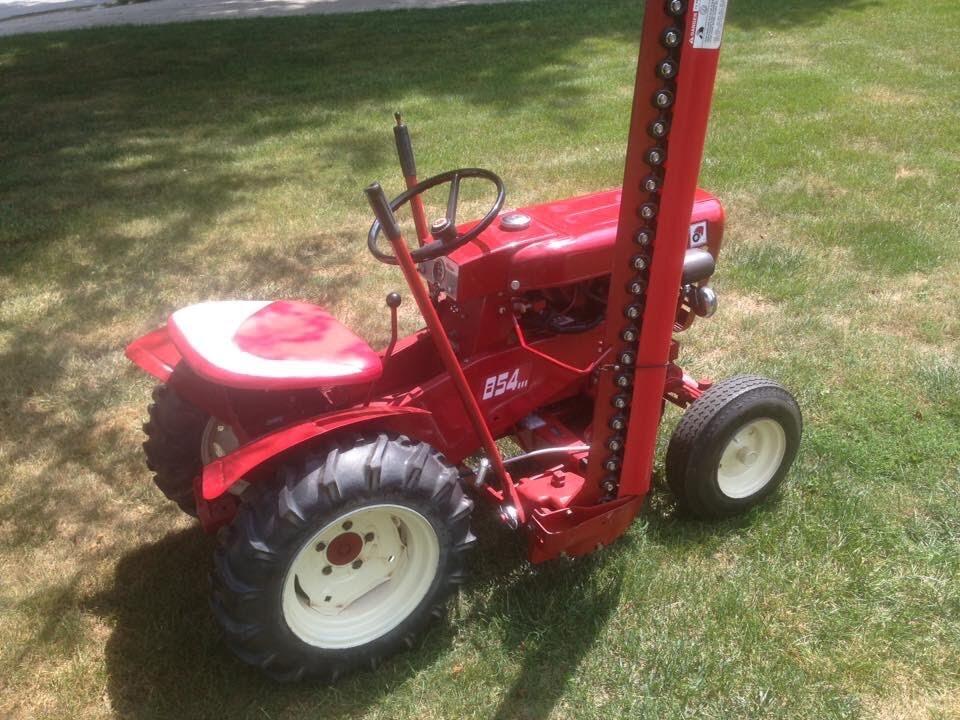

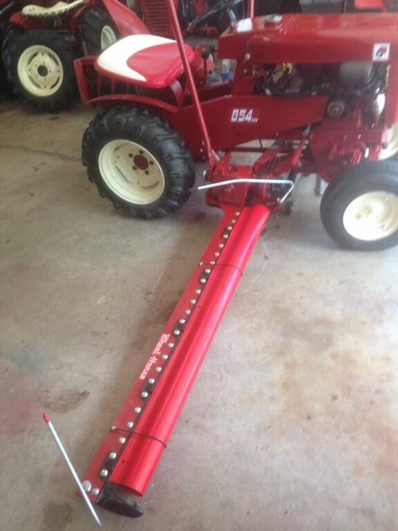

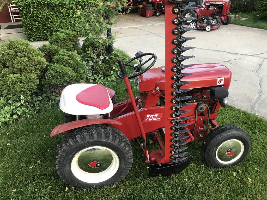

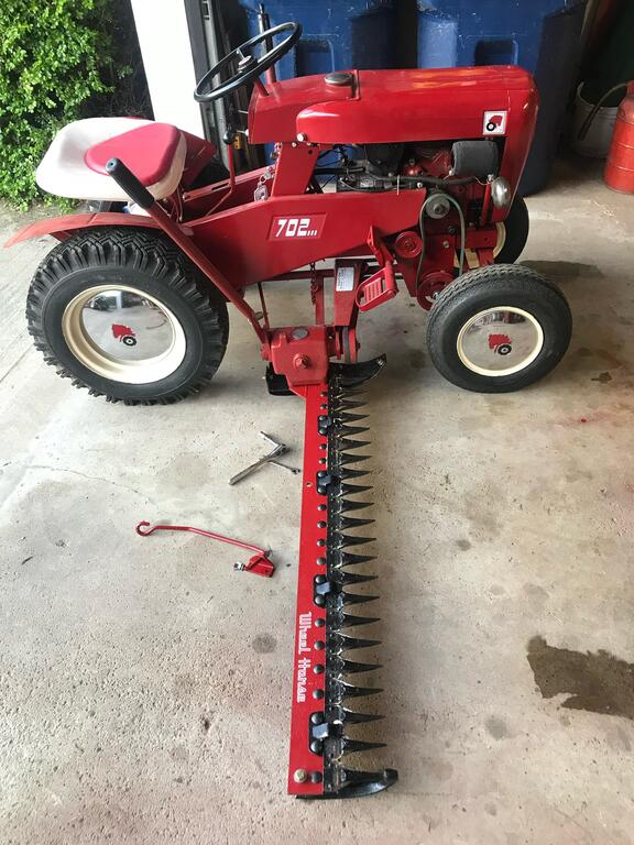

Lane Ranger 12,142 #3 Posted July 11, 2021 (edited) 7-1311 Wheel Horse sickle will adjust to fit on short frame tractors. 42 blade is a better one for smaller hp motors. The U connection rod in back that attaches to frame at transmission link should move in and out to adjust length. I had my old 50 inch 7-1311 on my 702 and 854 and mounted fine. Edited July 11, 2021 by Lane Ranger 3 Share this post Link to post Share on other sites
Racinbob 13,213 #4 Posted July 11, 2021 2 hours ago, Lane Ranger said: 7-1311 Wheel Horse sickle will adjust to fit on short frame tractors. 42 blade is a better one for smaller hp motors. The U connection rod in back that attacked to drone at transmission link should move in an out to adjust length. I had my old 50 inch 7-1311 on my 702 and 854 and minted fine. I was wondering about that Lane. I was thinking the one I had would do that but that's been over 20 years ago so I wasn't sure and I don't recall it ever being mentioned here. Now it has been 1 Share this post Link to post Share on other sites
