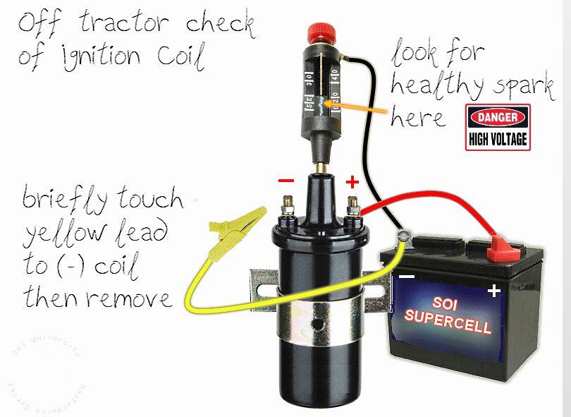

pfrederi 20,891 #4 Posted July 11, 2021 Primary (small + to small -) should show 3-5 ohms Secondary test center terminal to small - should show 6k -10k ohms If you have a spark plug tester you can try the the pictured test (I just had a coil issue it had resistance readings close to above but wouldn't generate a spark on the machine or in the pictured test.... There is no practical test for condensers except to disconnect it and see of spark returns... Share this post Link to post Share on other sites

Handy Don 16,972 #8 Posted July 11, 2021 1 hour ago, pfrederi said: Just adding that the spark should happen as the yellow wire is removed from the negative coil terminal, not when it is touching! 1 Share this post Link to post Share on other sites
