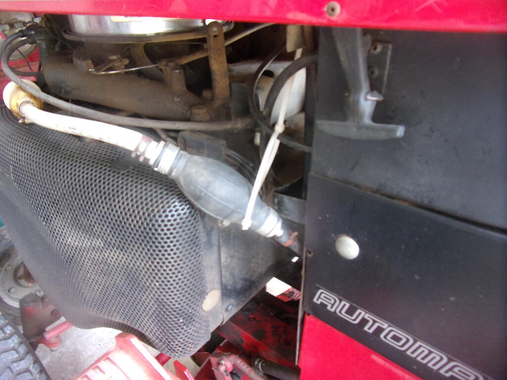

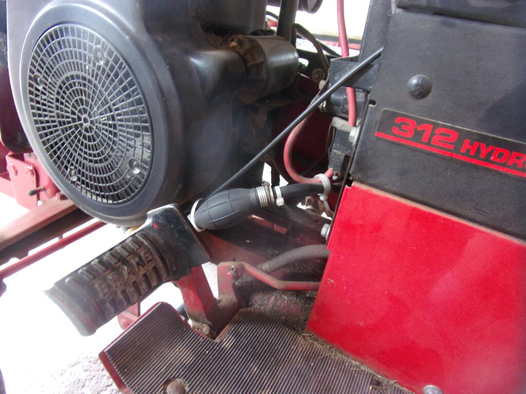

clueless 3,438 #5 Posted July 10, 2021 I've got the marine primer bulb on all three of my under the seat gas tank WH's, best $10.00 thing I every did for them. I have them connected to the fuel line under seat and zip tied. Lift the seat about 4 or 5 good squeezes and they fire right up even the 312. On the one I plan on using every week or two about 1 o 2 squeezes, on the ones I don't plan on using for a long period of time I turn of the fuel at the tank and run it till it stops, don't forget to turn your key off after it stops are when you go to start it again you will have a dead battery and at least 150 hr or more added to your hour meter trust me . When I go to use it again open up the fuel line about 8 good squeezes and she fires right up . 1 Share this post Link to post Share on other sites

Tgalo 128 #9 Posted July 10, 2021 3 hours ago, Ed Kennell said: I have added the primer bulb to all my tractors and now they all start instantly Where do you put it that its not noticeable? Share this post Link to post Share on other sites

Ed Kennell 47,266 #13 Posted July 10, 2021 53 minutes ago, Tgalo said: Where do you put it that its not noticeable? I do not attempt to hide mine. I put them between the steering column and the engine where I can reach thwm from the seat. 1 Share this post Link to post Share on other sites
