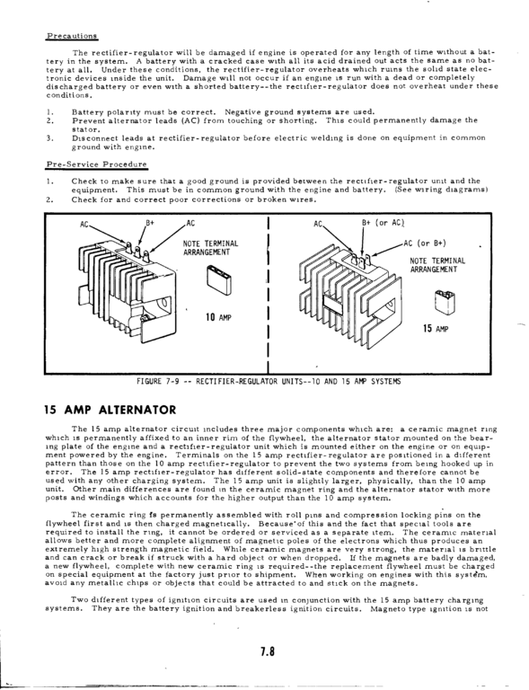

Uxtractor 8 #7 Posted July 8, 2021 Found this photo on site in the Kohler manual ,might be ready by fall . Thanks everyone Cheers Mike 1 Share this post Link to post Share on other sites
