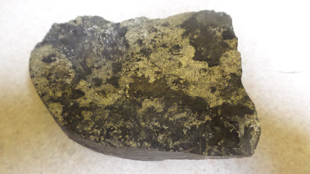

bc.gold 3,406 #51 Posted July 25, 2021 On 7/22/2021 at 4:10 AM, bc.gold said: The rock is mainly composed from Alluvial Gold Dust, gold ground so fine by the glacier it no longer reflects light as gold flakes would but appears as a brown powder when the rock is ground up in a mortar or ball mill for processing. This type of gold is often over looked. Managed to break the rock on a gold seam. 1 Share this post Link to post Share on other sites

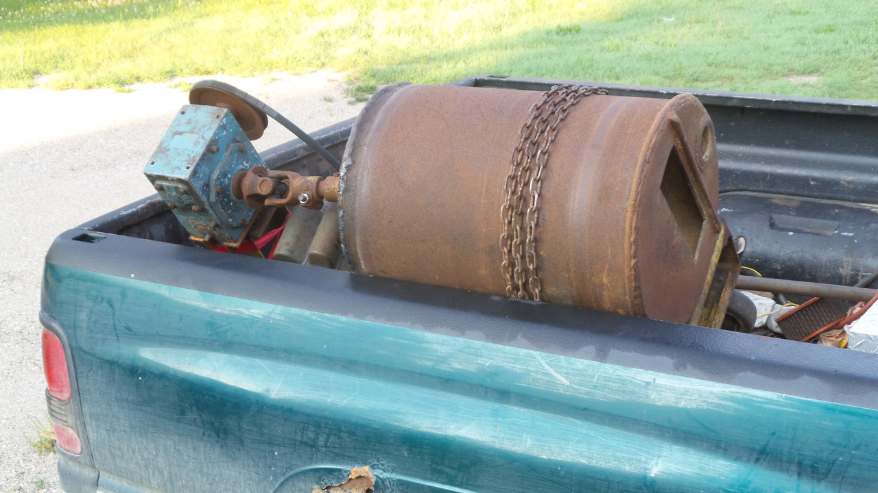

bc.gold 3,406 #53 Posted July 25, 2021 On my return to BC another trip to Vancouver Island this time to Victoria to pick up a small jaw crusher which will crush rock to 3/8" minus feed stock for my home made ball mill. Yesterday I managed to break the rock into fist sized pieces that I'll load into the mill later today. ` Share this post Link to post Share on other sites

bc.gold 3,406 #55 Posted July 25, 2021 (edited) Couple more hours in the ball mill that rock is coming out as powder with the precious liberated. Edited July 25, 2021 by bc.gold 1 Share this post Link to post Share on other sites

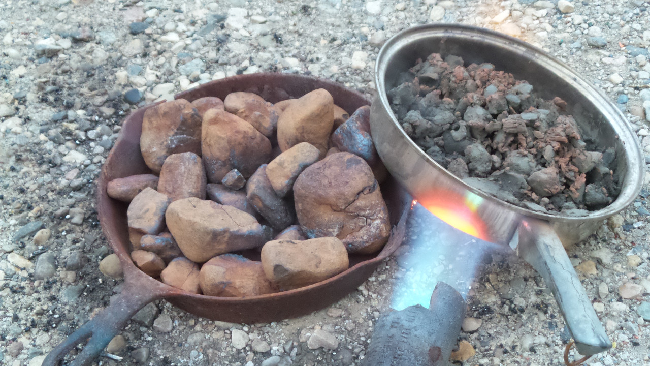

bc.gold 3,406 #58 Posted July 26, 2021 5 hours ago, Dan.gerous said: Can't get any information on the rivers past history regarding gold, but will keep digging as the internet is bound to divulge something. Worth a look once we free up some time 🙂 - nothing to lose and everything to gain.... Some of the rock was incomplete, I fired this rock to loosen it up before going back into the mill some of the sulfur has burned off notice the color change. 1 Share this post Link to post Share on other sites

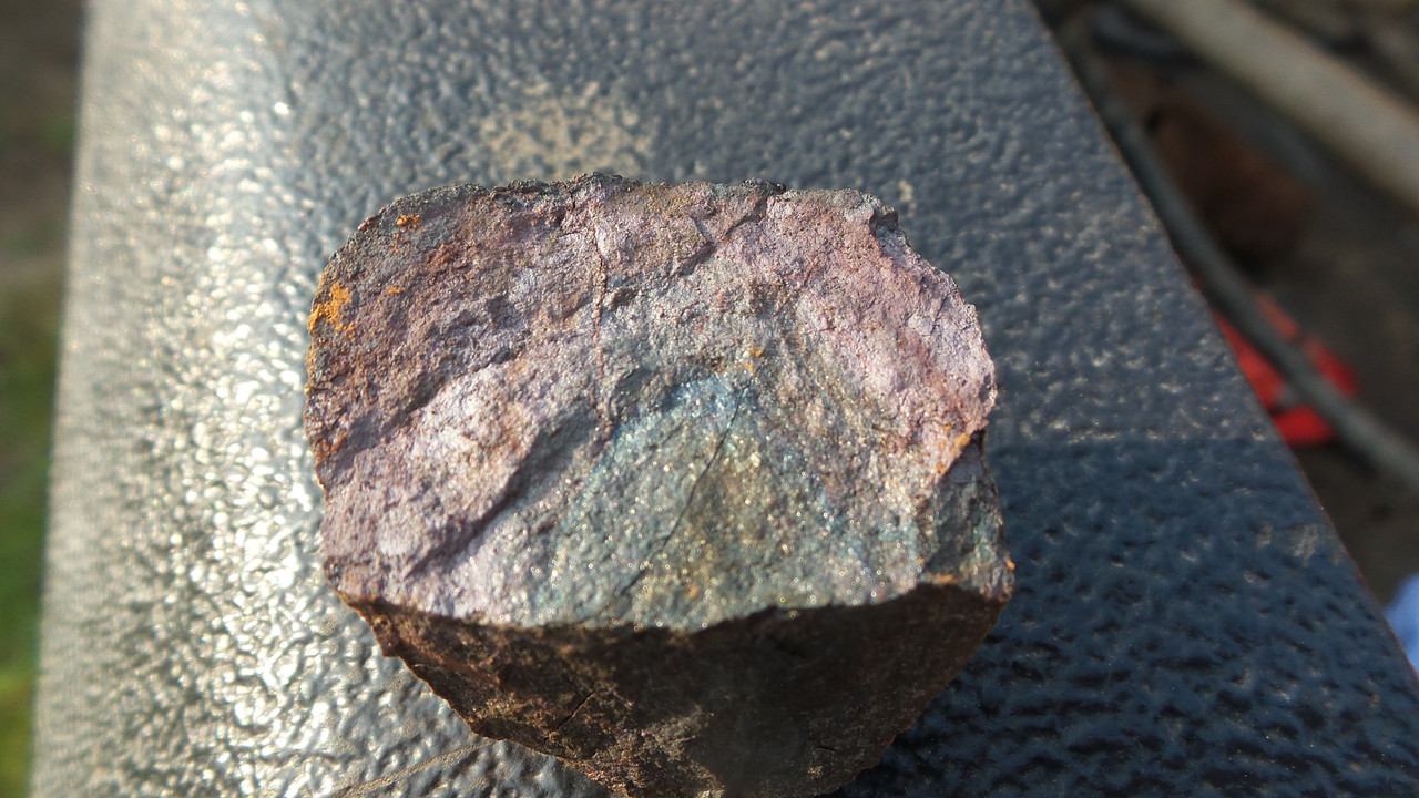

bc.gold 3,406 #59 Posted July 26, 2021 (edited) Firing the rock made some fissures, this small piece shows purple a good sign for gold.Below the incinerated powder still needs more work. Edited July 26, 2021 by bc.gold Share this post Link to post Share on other sites

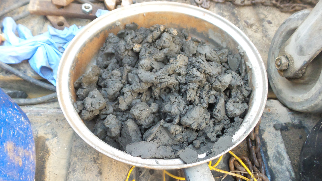

bc.gold 3,406 #60 Posted July 26, 2021 (edited) Some incomplete milled material went back into the mill, top pan after incinerating is red like rust. Bottom pan just came out of the mill and it has a brown color to it. Short tube video, aqua regia at work. Edited July 26, 2021 by bc.gold Share this post Link to post Share on other sites

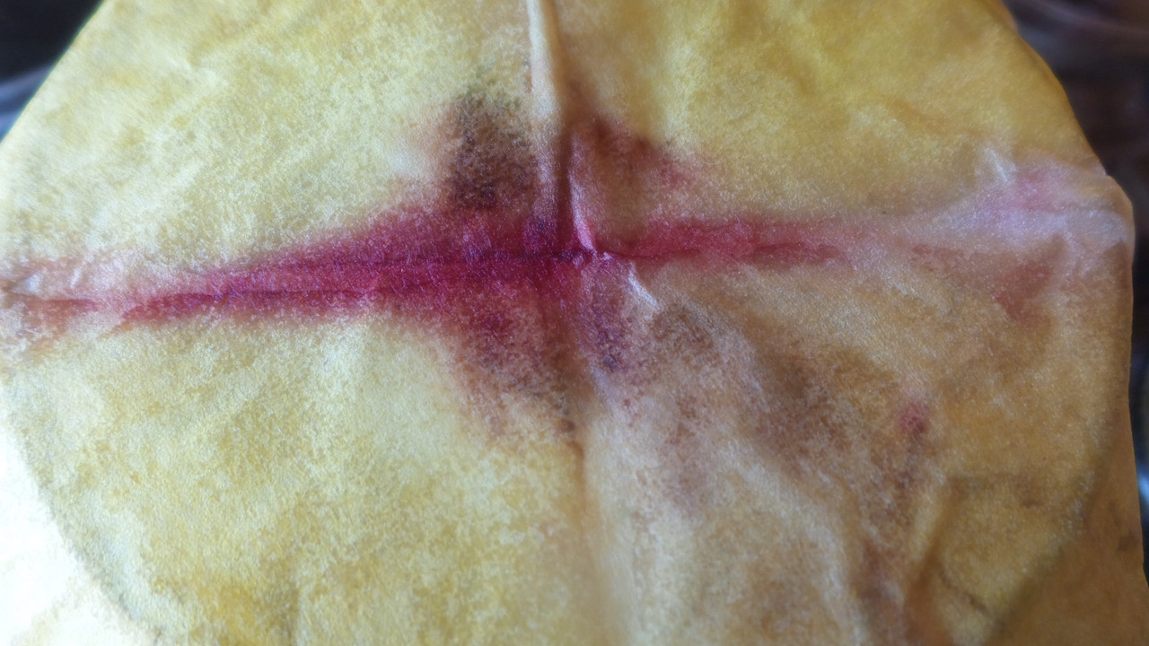

bc.gold 3,406 #61 Posted July 27, 2021 Pt/Au float. Share this post Link to post Share on other sites

bc.gold 3,406 #65 Posted August 4, 2021 Very little gold in that rock, tested positive for palladium. Share this post Link to post Share on other sites
