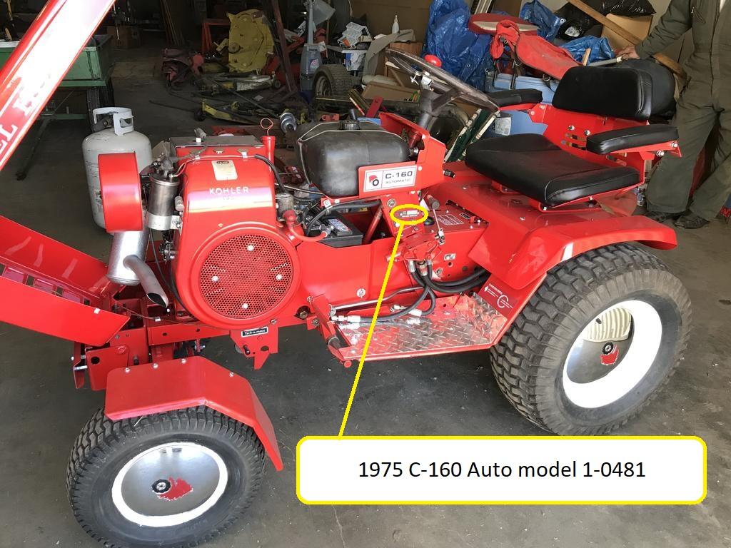

gwest_ca-(File Mod) 12,321 #4 Posted July 5, 2021 5 minutes ago, doug mahon said: I’m guessing switch isn’t available anymore What is the long model number off the ID plate? Share this post Link to post Share on other sites

doug mahon 1 #7 Posted July 6, 2021 Where do I find that plate?? Share this post Link to post Share on other sites

gwest_ca-(File Mod) 12,321 #10 Posted July 6, 2021 2 1 Share this post Link to post Share on other sites
