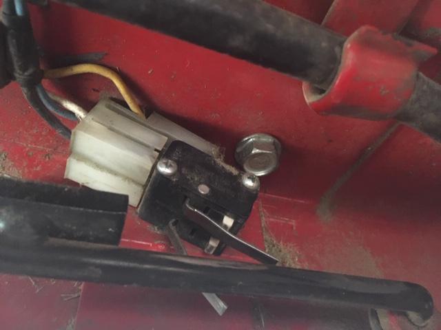

1988WheelhorseUser 1 #1 Posted July 4, 2021 Hello, I am new to the forum, and would like to ask for some help sourcing a replacement (neutral safety) switch. The original two contactor switch needs replaces, the contactors have become loose after 30 years of use and no longer make contact with the microswitch when the brake pedal is depressed (image attache). The tractor is a 1988 Wheelhorse 257-H (model 2217KE01). The original owners manual has a wiring diagram that calls this switch Neutral Switch N.O. The OEM part 111332 (Toro Parking Brake Safety Switch) has a single microswitch, however the switch on my 1988 Wheelhorse tractor has a two prong switch, there are two contactors. I am unable to find the replacement part number that would be identical to the original part. Any help would be greatly appreciated to help me source the replacement part. Thanks, Ed Share this post Link to post Share on other sites
Maxwell-8 4,371 #2 Posted July 4, 2021 Those look liek to seperate switches screwed together Share this post Link to post Share on other sites
gwest_ca-(File Mod) 12,321 #3 Posted July 4, 2021 Yes 2 part number 111332 switches fastened together. The parts illustration at Toro shows only one switch in the illustrated parts list but the parts list shows a quantity of two for this model. Very popular switch used in different ways on many models. Garry Adding - have a better detailed wiring I will replace the one above with when I get a few minutes. DONE Share this post Link to post Share on other sites

1988WheelhorseUser 1 #5 Posted July 4, 2021 1 hour ago, gwest_ca said: Yes 2 part number 111332 switches fastened together. The parts illustration at Toro shows only one switch in the illustrated parts list but the parts list shows a quantity of two for this model. Very popular switch used in different ways on many models. Garry Adding - have a better detailed wiring I will replace the one above with when I get a few minutes. DONE Thank you for your help. This now makes more sense that there are two identical switched side by side. Your additional details are appreciated. 1 Share this post Link to post Share on other sites
WHX?? 57,277 #6 Posted July 5, 2021 Check on parts tree or even perhaps a Toro dealer. They may be available yet. Share this post Link to post Share on other sites
Handy Don 16,915 #8 Posted July 6, 2021 Welcome. These switches are very inexpensive and widely available on the jungle site and the bay. Share this post Link to post Share on other sites
