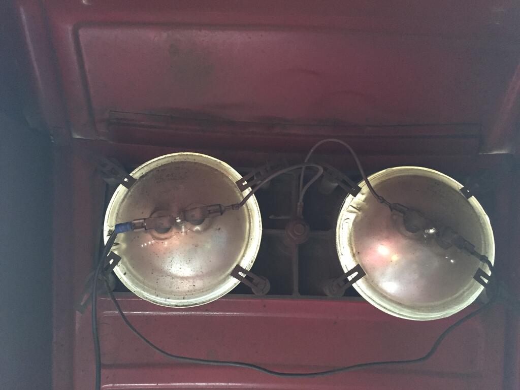

SylvanLakeWH 31,718 #2 Posted July 4, 2021 Mine are just held on by clips. 1982 C105. May want to redo and reinforce your ground to the frame, as the Black Hoods have a floppy hood that makes for less than ideal ground… 2 Share this post Link to post Share on other sites

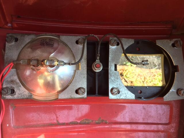

Thor27 891 #4 Posted July 7, 2021 (edited) Looks like the 80 and 81 tractors have bolts in retainers, 82 on used the push in clips like Jim's picture.. Edited July 7, 2021 by Thor27 Add pics from phone 1 Share this post Link to post Share on other sites
tunahead72 2,635 #5 Posted July 7, 2021 Hmmm... The headlights on my '81 C-105 look exactly like the ones in Jim's photo, with the clips. 1 Share this post Link to post Share on other sites
Thor27 891 #6 Posted July 7, 2021 I got that info from the IPLs on partstree, don't consider it carved in stone... I should have put a disclaimer. The one in my pic is an '80, I prefer that style since the light can't rotate. 1 Share this post Link to post Share on other sites

gwest_ca-(File Mod) 12,352 #9 Posted July 7, 2021 1980 B-Series and C-Series used the 4 part number 108054 plates. 1981 C-Series used the 4 part number 108054 plates. 1981 B-Series used the 8 part number 108911 spring clips. 1982-1984 C-Series used the 8 part number 108911 spring clips. 108054 plates were replaced by 108911 spring clips for service parts replacement and still available July 7, 2021 Garry 2 1 Share this post Link to post Share on other sites

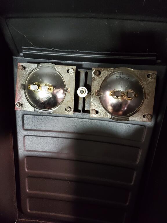

Bill Winn 157 #10 Posted July 7, 2021 (edited) My c175 is an 80 or 81 and this is what my mounts look like. As a keen observer can see, I am in need of replacement lights. Is there a modern equivalent to the 4411 in LED format that actually shines a spotlight beam? Bill Edited July 7, 2021 by Bill Winn 1 Share this post Link to post Share on other sites
