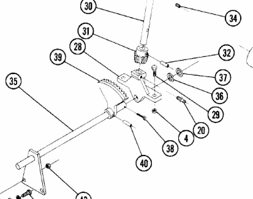

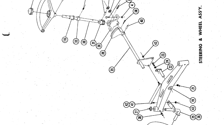

adsm08 5,130 #1 Posted July 4, 2021 So the steering slop on my 855 has finally gotten bad enough that I need to do something with it. I've figured out everywhere I have slack on the system, and most of it is between the fan gear and the horizontal shaft. The tie rods account for a bit more, and will be dealt with in due course, but they are minor compared to the fan gear to shaft connection. Looking at the tractor and the parts diagram it looks like all that holds those two pieces together is a roll pin. I'd like to slightly enlarge the hole and put a bolt in it instead. With the deck off and the steering turned to the right spot I can access it to do the work, but I think it would make things easier to take it out and work on the bench. So, um, how does it come out? I know there is supposed to be a cotter pin at the end of the shaft, but I haven't found it yet, and I'm not convinced I'll get all the forward movement I need to clear the frame. Share this post Link to post Share on other sites
gwest_ca-(File Mod) 12,483 #2 Posted July 4, 2021 36 and 37 are shims held to the end of the shaft by 38 cotter pin. Adding more shims will pull the fan gear back to the pinion gear. You do not want 0 backlash but a bit of clearance through the full travel of the fan gear. Casting 28 is easily broken so be careful. 2 Share this post Link to post Share on other sites
adsm08 5,130 #3 Posted July 4, 2021 (edited) 1 hour ago, gwest_ca said: 36 and 37 are shims held to the end of the shaft by 38 cotter pin. Adding more shims will pull the fan gear back to the pinion gear. You do not want 0 backlash but a bit of clearance through the full travel of the fan gear. Casting 28 is easily broken so be careful. Pinion to fan gear backlash is correct. Steering turns easy and the fan gear starts to move right away. However I can turn the steering wheel over 1/4 turn before the wheels start to turn, and most of that slop is observable as being between parts 35 and 39. I can't see it directly yet but I am fairly certain that the hole in 35 that pin 40 goes through is egged out. The parts callout lists 40 as being a 5/16 diameter roll-pin. My plan was to remove it, upsize the hole to 3/8 if it isn't already, and install a grade 3 bolt in place of the pin. Grade 3 should be softer than the shaft, so any future wear should mostly be on the softer metal of the bolt, which would be easier to replace than the pin. A bolt I can unscrew easily, this roll pin will have to wait until Tuesday when I can get back into the shop to get my slide hammer, unless I can get the shaft out. Edited July 4, 2021 by adsm08 Share this post Link to post Share on other sites
squonk 48,072 #4 Posted July 4, 2021 Loosen upper bushing behind gas tank and lift upper steering shaft out of # 28. Remove cotter pin and shims. Take out bolts holding #28 to frame. disconnect tie rods at front of shaft. Pull shaft rearward until front of shaft clears front frame bearing. Shaft is in your hand ready for the bench. 1 1 Share this post Link to post Share on other sites
adsm08 5,130 #5 Posted July 4, 2021 6 hours ago, squonk said: Loosen upper bushing behind gas tank and lift upper steering shaft out of # 28. Remove cotter pin and shims. Take out bolts holding #28 to frame. disconnect tie rods at front of shaft. Pull shaft rearward until front of shaft clears front frame bearing. Shaft is in your hand ready for the bench. That's the info I'm looking for. @squonk to the rescue again. Thanks. 1 Share this post Link to post Share on other sites

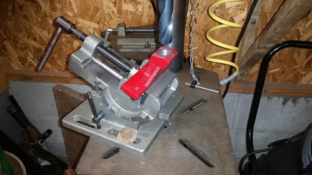

adsm08 5,130 #7 Posted July 8, 2021 (edited) Picture time! As predicted, the hole in the shaft was egged out, and not just a little. This is a 15/16 drillbit The ultimate fix was to drill all three holes, the one in the shaft and both sides of the fan gear, to 21/64 and tapped for a 3/8X16 thread. Then ran a short bolt in from each side, spaced out with washers since each bolt is a bit more than half the length, and secured with red (because what other color will you use on a WH?) thread locker to guard against vibrations. Not a lick of play now and the steering is much tighter. Gonna order some tie rod from Lowell when he gets back, and that out to about do her. Edited July 8, 2021 by adsm08 1 Share this post Link to post Share on other sites

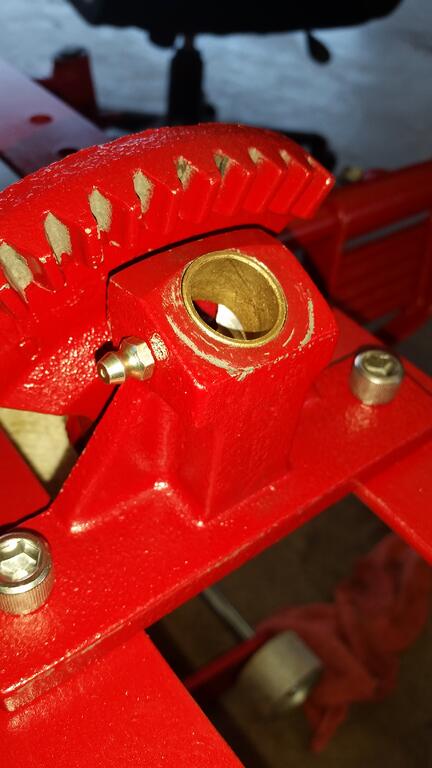

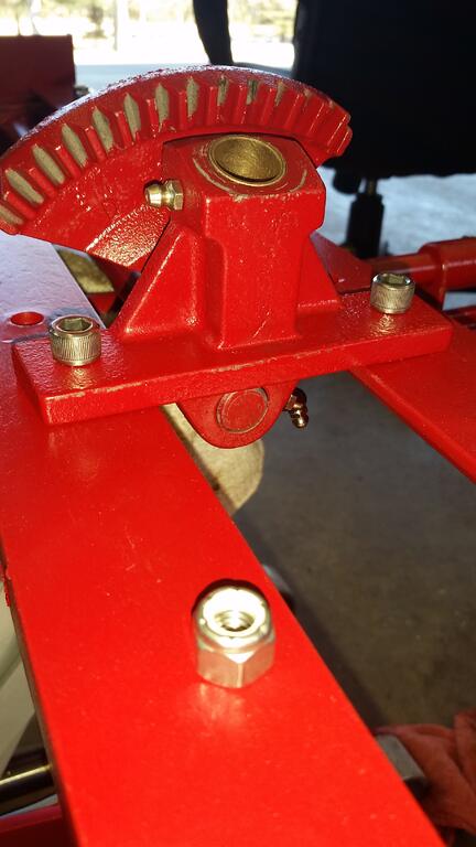

oliver2-44 11,734 #16 Posted July 14, 2021 So is there wear/slop in the horizontal hole in part#28 that is allowing the horizontal shaft to walk around out at the end. i seem to recall some have drilled out part #28 and put a bushing in the vertical hole for the steering wheel shaft and a bushing in the horizontal hole as well. Seems @WHX24 has bushed some of these! 1 Share this post Link to post Share on other sites
adsm08 5,130 #17 Posted July 15, 2021 (edited) 2 hours ago, oliver2-44 said: So is there wear/slop in the horizontal hole in part#28 that is allowing the horizontal shaft to walk around out at the end. i seem to recall some have drilled out part #28 and put a bushing in the vertical hole for the steering wheel shaft and a bushing in the horizontal hole as well. Seems @WHX24 has bushed some of these! No, I'm good and tight at 28, I had to lube it and still hammer the shaft out of 28. My walking play is at the front of the tractor, near part 19, where there is no support, and seems to never have been. Edited July 15, 2021 by adsm08 Share this post Link to post Share on other sites

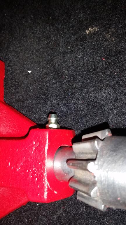

WHX?? 58,069 #18 Posted July 15, 2021 (edited) I have drilled and bushed out a couple. I used a cut down bronze oil lite bushing and just used red loctite to hold it in. Oddly many of the tractors I have restoed this point (the bottom of 28) and the front end were good. I have added a zerk to the bottom end but probaly not nessecsary. I have also done this if the socket on 28 is wallowed. Sloppy steering is a personal pet peeve. Although I see your line of thinking on the bolt not big on the idea of a bolt. I have ripped into too may tractors that this was done on and it never seemed to work and I deemed it as a farmer fix. I believe an accurate sized hole and a 3/8 roll pin is the proper fix. Edited July 15, 2021 by WHX24 1 Share this post Link to post Share on other sites
