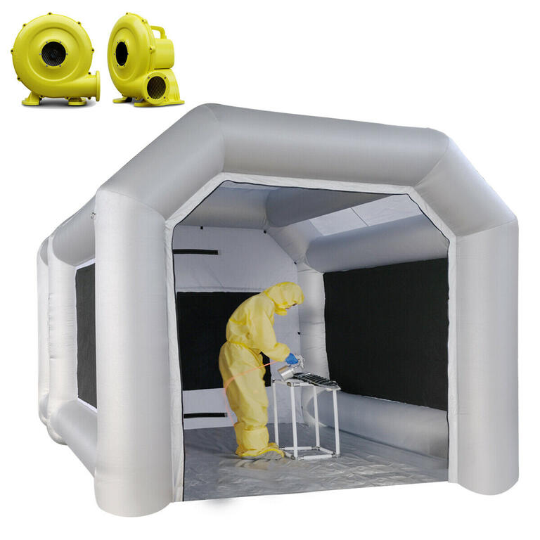

rmaynard 17,634 #1 Posted July 2, 2021 Has anyone had any experience, good or bad, with an inflatable paint booth similar to the one shown? 4 Share this post Link to post Share on other sites

ranger 1,862 #3 Posted July 2, 2021 22 minutes ago, rmaynard said: Has anyone had any experience, good or bad, with an inflatable paint booth similar to the one shown? Nice idea, but you don’t want to have a power cut/outage just after applying the final coat of black on the roof of your Show Car! 😢 It would be bad enough having the compressor stop, the lights go out, but to have the building collapse onto your fresh paint*********** 4 1 Share this post Link to post Share on other sites
rmaynard 17,634 #4 Posted July 2, 2021 (edited) That's always a question that is asked. Some guys build a cheap PVC frame to hold it up just for that reason. Others run the blowers with a generator. In my area power failures are rare. I would be inclined to try the PVC method. That would also allow me to hang additional lighting. Edited July 2, 2021 by rmaynard 3 Share this post Link to post Share on other sites

BHunter 1,702 #8 Posted July 2, 2021 I know they have really good airflow. I used one 20 years ago when i was working for a mobile painting company. We set it up in the back lot of the car dealerships and sprayed small jobs. We used a generator to power it. They sell indoor and outdoor models. Make sure you get the right one for what you are doing. Id like to see how these new booths compare to the old one I used. 2 2 Share this post Link to post Share on other sites

rmaynard 17,634 #18 Posted July 3, 2021 (edited) Another concern that I have is about setting up inside of a building. Since the air filtration is done by putting positive pressure on the inside of the booth with the filtration fan. All paint fumes are exited through the window/side filters. Once exited, the fumes are now inside of a closed building causing those fumes to build up and be recycled back into the booth if not exited from the building by an exhaust fan large enough to change the air frequently. This would be especially bad if you are using paints with isocyanates. Having thought about this, I don't think that I would be using the booth anywhere but outside, and away from anywhere that humans would be able to breath the exhausted fumes. Fresh air face masks seem like a necessity as well. This could get expensive. $$$ $$$ Edited April 13, 2023 by rmaynard Share this post Link to post Share on other sites

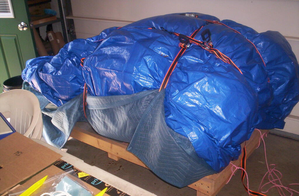

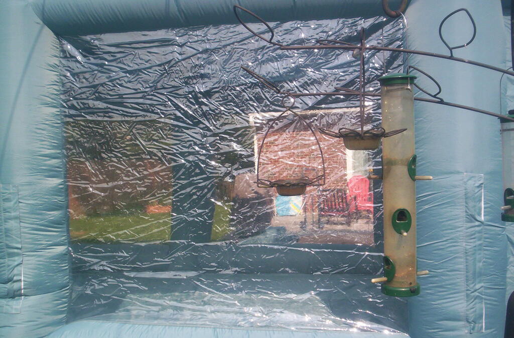

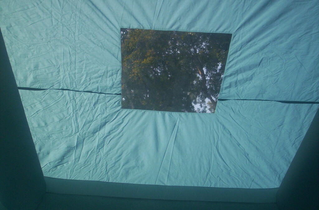

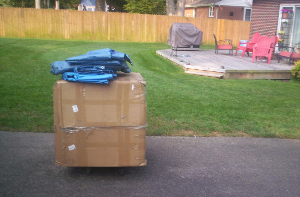

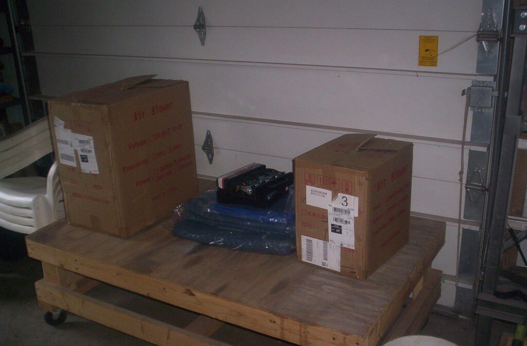

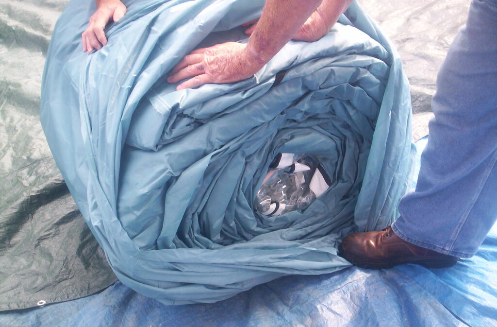

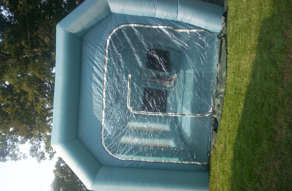

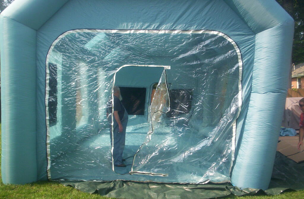

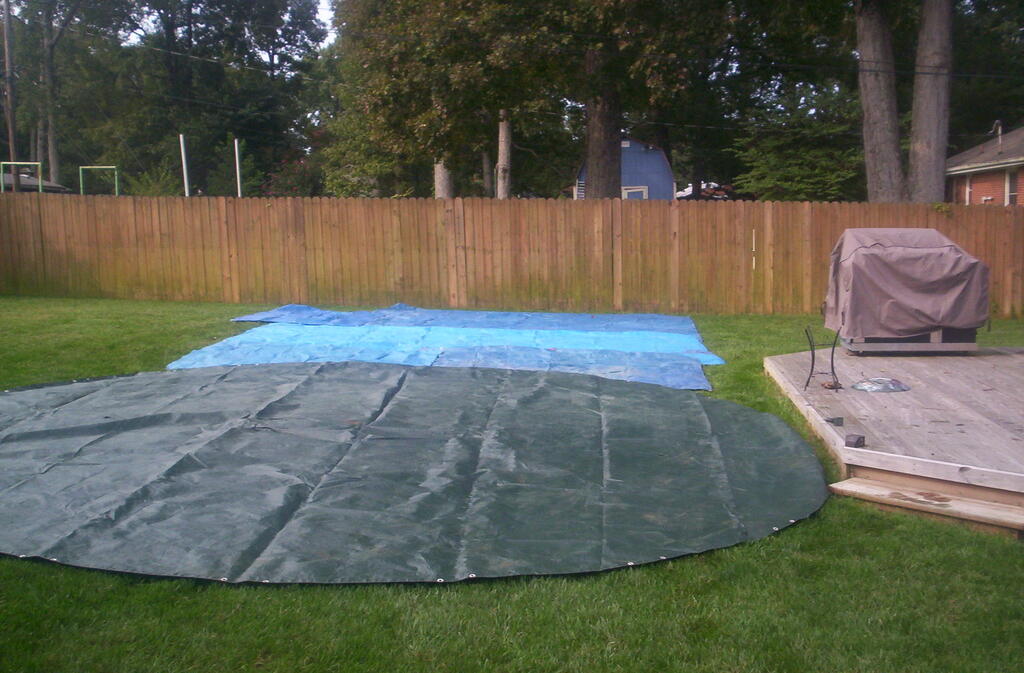

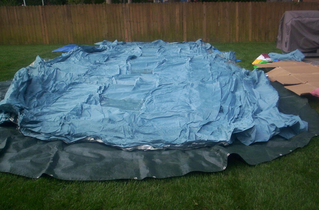

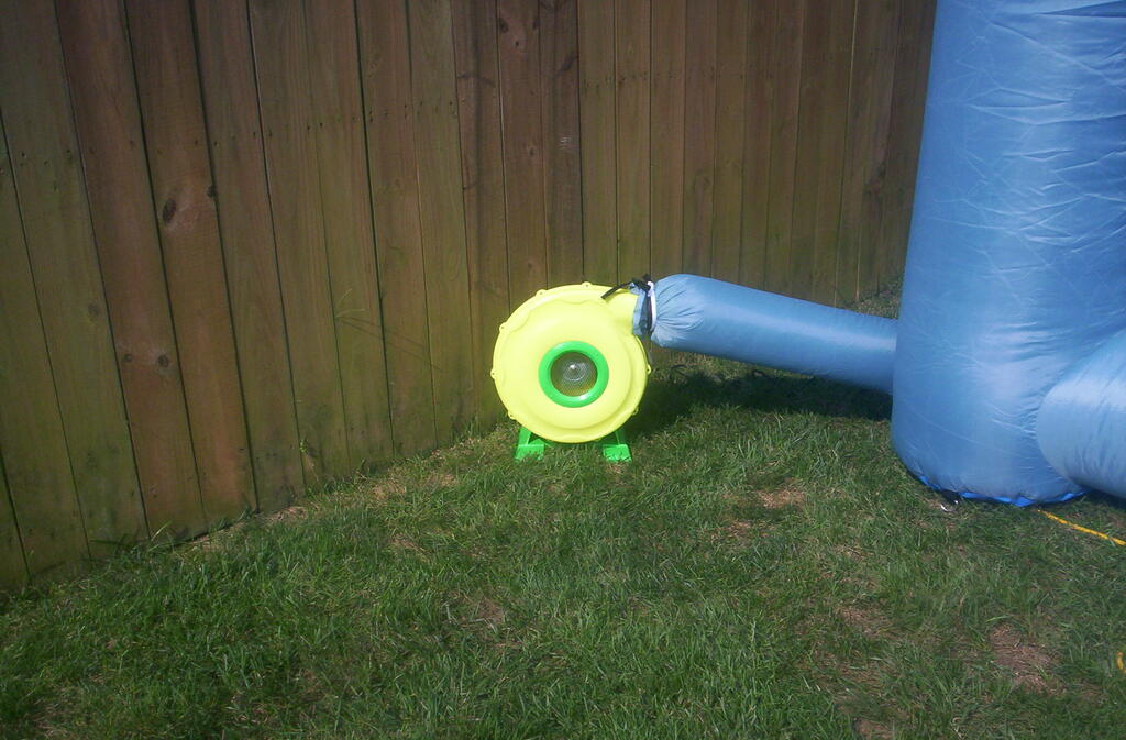

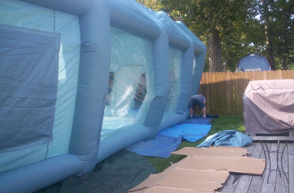

elcamino/wheelhorse 9,363 #23 Posted September 12, 2021 Spent a fun (?) day at my brother's with the inflatable paint booth today. Outside dimensions are 39 and a 1/2 feet long , 16 feet wide and 13 feet tall. Comes with 2 blowers , one to inflate and one to move air inside( both were made on the cheap. Directions leave a lot not printed . Took about 25 minutes to inflate after we figured out that there were 4 areas that needed to be zipped up and then sealed with the Velcro flaps . Took 4 people to set up . a learning experience for sure. Even came with a bag for storage , no way would it ever go back in the bag . When we deflated and let sit , it ended up on a mobile platform about 4 feet wide by 6 feet long. He thinks he got a bargain at $1,300.00 , I am not sure about that. Instructions did state not to set up in the rain . We will see how it works out when he paints the 55 Cheby pickup. Sorry the pictures are not in order , dag gone Windows 10 ! 1 Share this post Link to post Share on other sites
