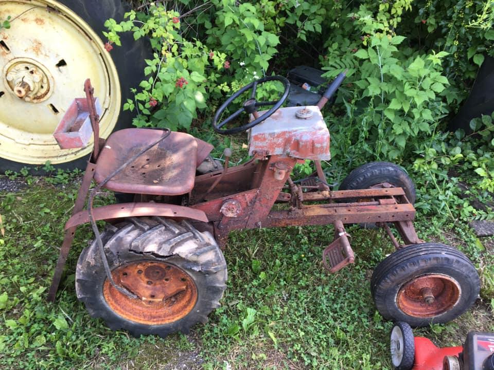

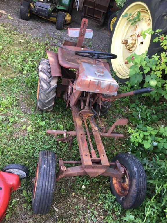

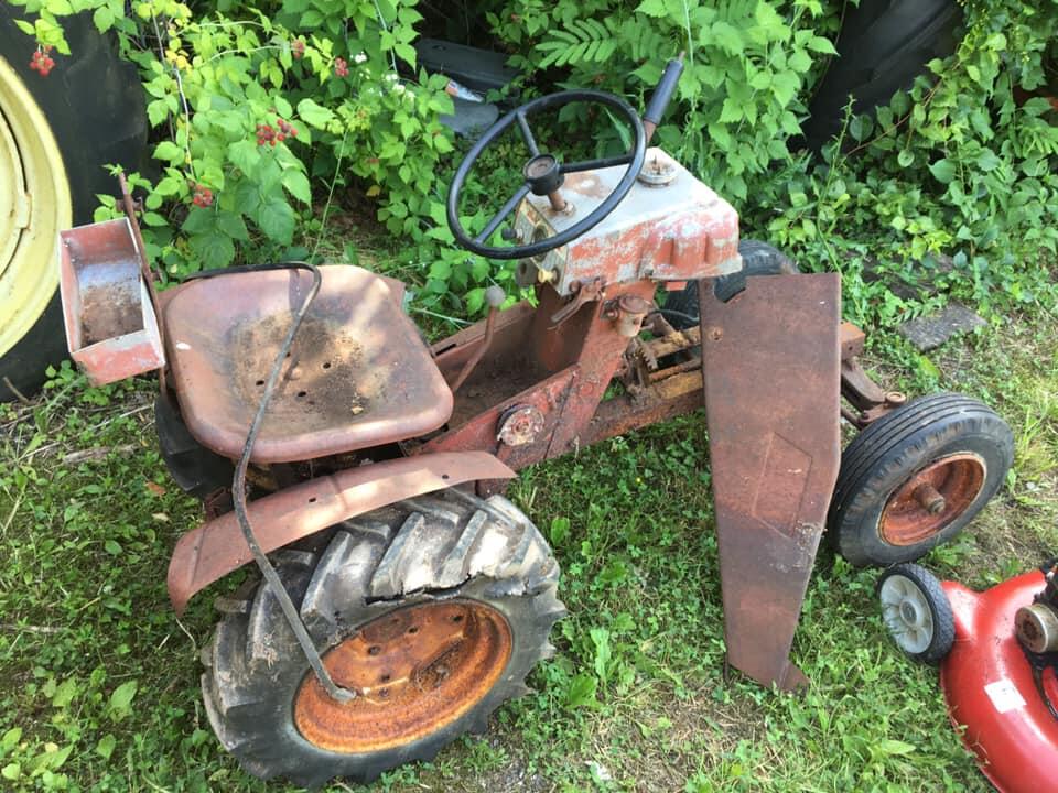

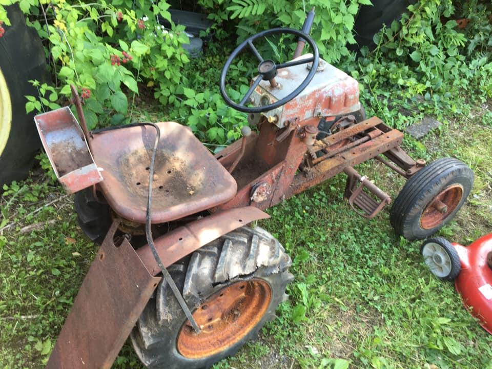

Preston88 10 #1 Posted July 2, 2021 I need help identifying my tractor. Alot of people say 701 and others say 702. Hopefully someone can tell me exact model. 1 Share this post Link to post Share on other sites

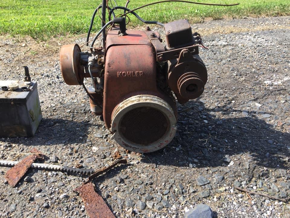

Racinbob 13,040 #2 Posted July 2, 2021 Not a 701 or 702. The front axle and steering wheel says a 1963 model. With the Kohler most likely a 753. But............the double starter and engine pullies indicate it's from a 701. Not the engine that came on a 1963 model. I'd say the tractor is definitely a 1963 but the engine is a 1961. 3 Share this post Link to post Share on other sites
Achto 32,095 #3 Posted July 2, 2021 6 hours ago, Preston88 said: I need help identifying my tractor. Alot of people say 701 and others say 702. Hopefully someone can tell me exact model. Definitely not a 701. Wrong dash, wrong steering fan gear, wrong front axle. The front axle and steering linkage is also wrong for it to be a 702. My best guess would be that your tractor is a 753 with a 701 engine. 2 Share this post Link to post Share on other sites

WHX?? 57,389 #7 Posted July 2, 2021 (edited) Thinking it started life as a 702 but someone definitely had their way with her. No matter still some potential there. Yes keep us posted on what you do with her. Edited July 2, 2021 by WHX24 Share this post Link to post Share on other sites

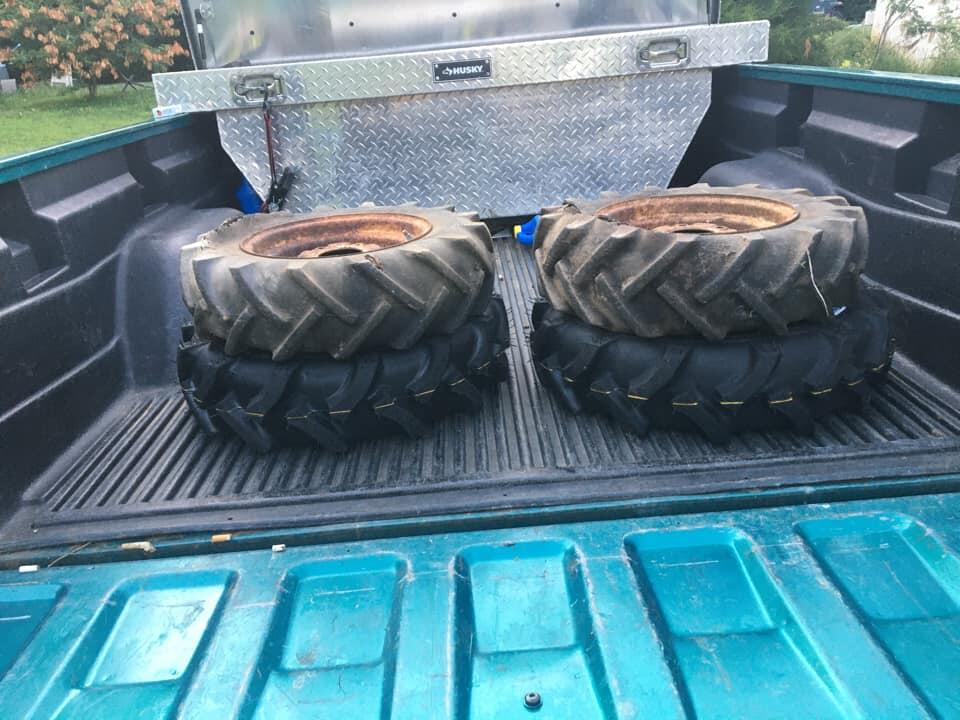

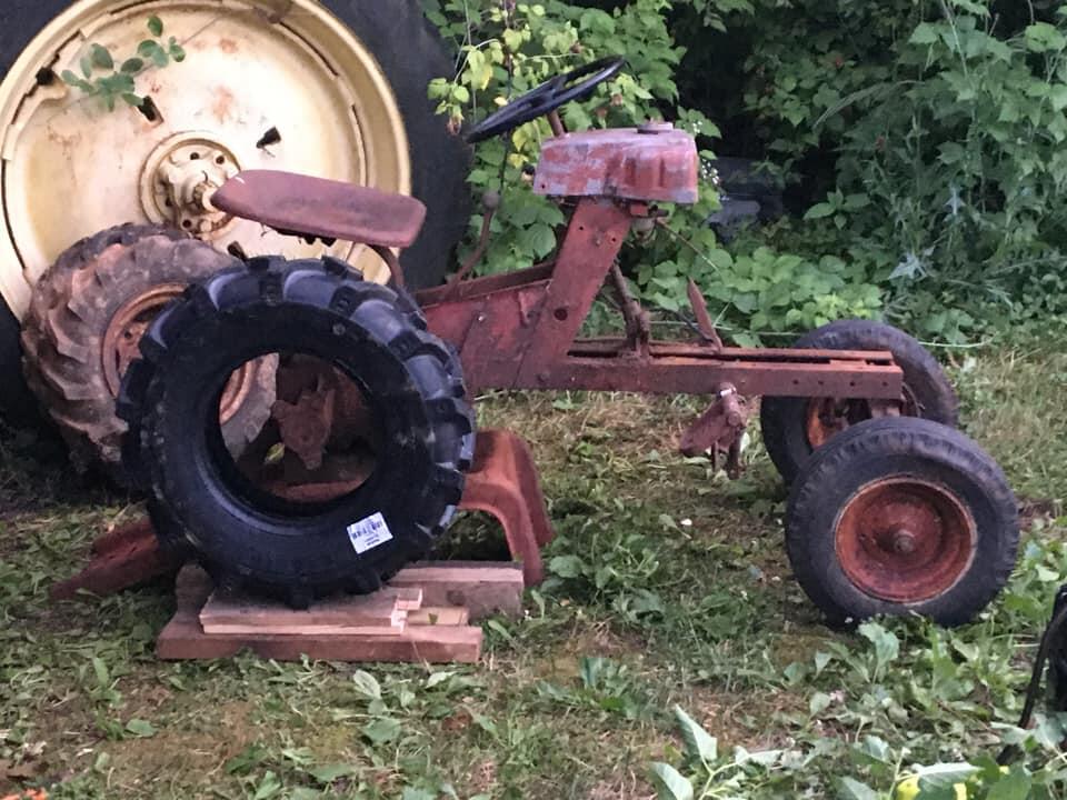

Preston88 10 #8 Posted July 2, 2021 Well I dont have any intentions on keeping it original :/ It was free and I just need something to run wood around the property and dump yard debri and trimmings up in the woods. Im only in the project $170 bucks for new tires and belt. I traded the seized kohler for a running engine. Just need to align the motor and drill some new mounting holes. Everything else is freed up. Trans shifts in and out of gear steering moves and brake/clutch are freed up. Just some sanding and oiling pedal and steering controls. 1 Share this post Link to post Share on other sites
Preston88 10 #9 Posted July 2, 2021 Most likely only have to spend an additional $50 to get it moving. 1 Share this post Link to post Share on other sites

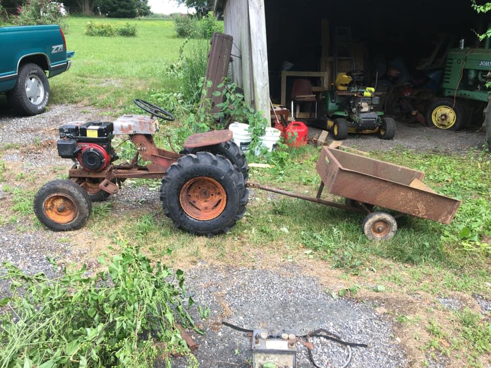

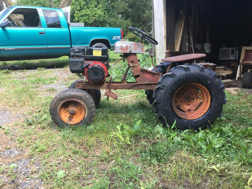

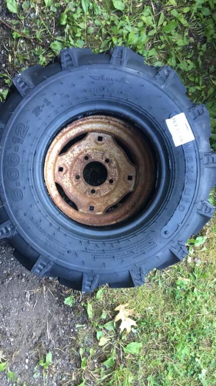

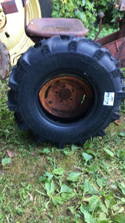

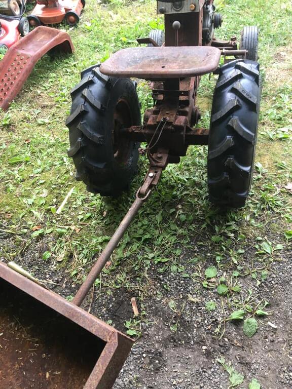

Preston88 10 #11 Posted July 3, 2021 these tires are beefy had to remove the fenders. 2 Share this post Link to post Share on other sites
Preston88 10 #14 Posted July 3, 2021 Update front tires came in after working on this today. Ill get those mounted Tuesday. I did free up the right side pedal controls. I have an idea how to set that right pedal up for a throttle with return springs. Total cost invested $185 and ill get all the return springs and the throttle cables and hardware from a bike brakes system which will probably cost $0. 1 Share this post Link to post Share on other sites
