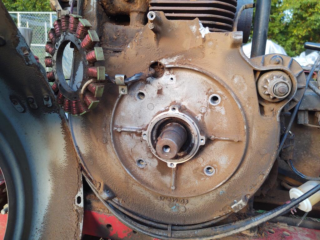

TC10284 114 #1 Posted June 30, 2021 I am trying to replace the bearing plate on my Kohler M12. I have removed all the bolts that I can see and I can wiggle and wobble the plate, but I cannot pull it off. Am I missing something? Share this post Link to post Share on other sites

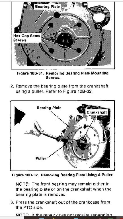

Gregor 4,848 #3 Posted June 30, 2021 You don't say why you want the plate off. Are you doing a rebuild on the motor? If so, maybe you can disconnect the rod, and drive the crank out from the PTO side, bringing the bearing plate with it. Just a thought. Share this post Link to post Share on other sites
pfrederi 20,889 #4 Posted June 30, 2021 You have to use a puller using the mounting holes for the stator. i had to buy some really long 10-24 bolts to get it hooked up Share this post Link to post Share on other sites

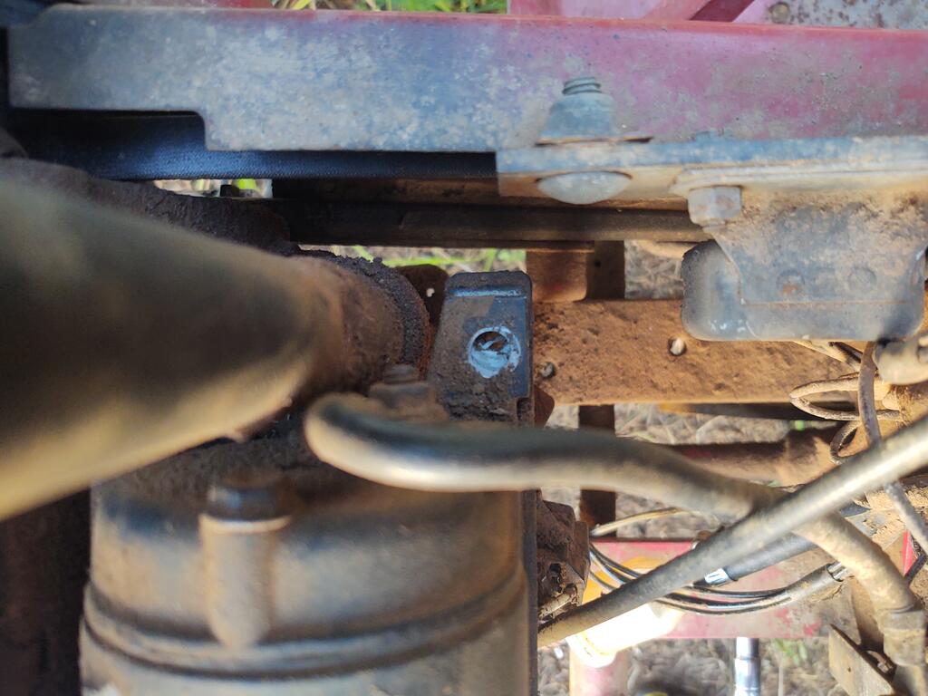

TC10284 114 #5 Posted June 30, 2021 6 hours ago, Gregor said: You don't say why you want the plate off. Are you doing a rebuild on the motor? If so, maybe you can disconnect the rod, and drive the crank out from the PTO side, bringing the bearing plate with it. Just a thought. The ignition coil mount is broken. Share this post Link to post Share on other sites

richmondred01 2,383 #10 Posted June 30, 2021 Confirming pfrederi statements, additionally remove the starter and it will be more manageable. Be careful removing the starter keeping it together. Last thing you want is fool with the brush springs. 1 Share this post Link to post Share on other sites

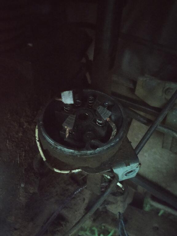

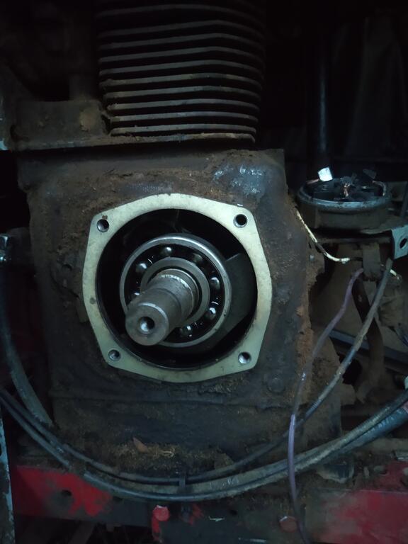

TC10284 114 #11 Posted July 1, 2021 OK, so I got the bearing plate off with a little effort from a short prying tool. Nothing was damaged thankfully. My next issue/question is: The bearing assembly did not come off with the plate. The replacement plate I have has this bearing assembly in it. Which is easiest to remove, or what is the best way to handle that situation? Also, I see what you mean about removing the starter. It came apart even though I tried hard to keep it together, and yes, I am going to have to fool with brush springs. I didn't lose any parts to it though. Any tips for that? Share this post Link to post Share on other sites
oliver2-44 11,632 #13 Posted July 2, 2021 On 6/30/2021 at 8:23 PM, TC10284 said: Also, I see what you mean about removing the starter. It came apart even though I tried hard to keep it together, and yes, I am going to have to fool with brush springs. I didn't lose any parts to it though. Any tips for that? the Kohler manual shows how to make a little simple sheet metal jig to hold the brushes for reassembly. It works great 2 Share this post Link to post Share on other sites
TC10284 114 #14 Posted July 2, 2021 (edited) On 7/1/2021 at 11:31 PM, oliver2-44 said: the Kohler manual shows how to make a little simple sheet metal jig to hold the brushes for reassembly. It works great Thanks! Any advice on removing that bearing assembly off the crank? Edited July 4, 2021 by TC10284 Share this post Link to post Share on other sites
squonk 47,422 #15 Posted July 2, 2021 (edited) Something similar to this : Edited July 2, 2021 by squonk Share this post Link to post Share on other sites
TC10284 114 #16 Posted July 7, 2021 Got the bearing assembly off and the replacement bearing/bearing plate installed. I need to get the flywheel back on and then the starter brushes reset and then reinstalled. Share this post Link to post Share on other sites

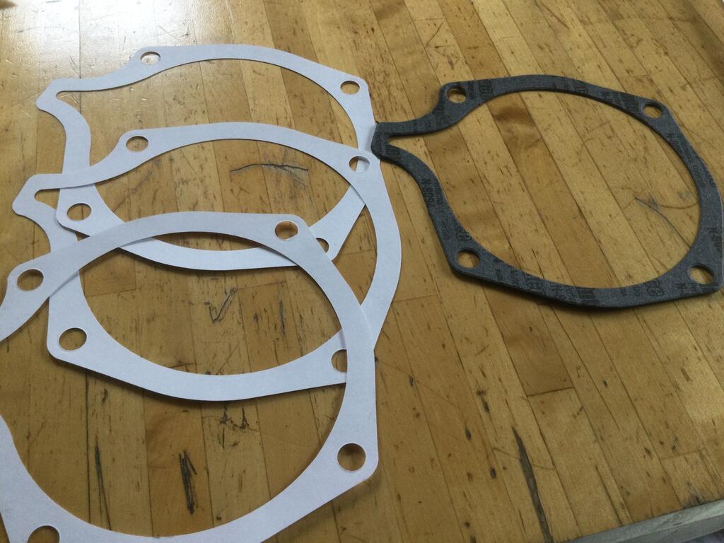

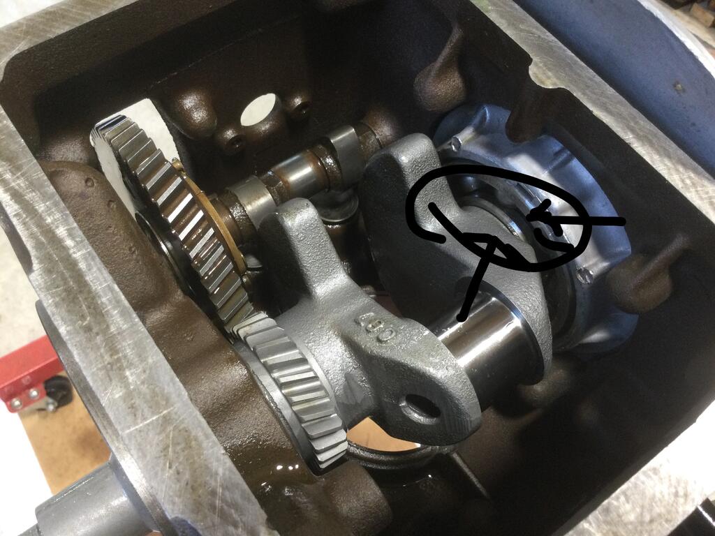

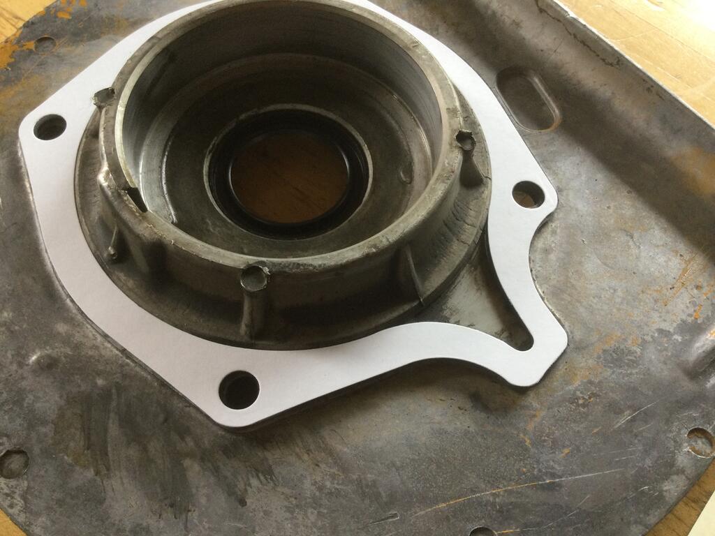

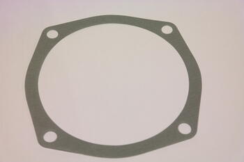

richmondred01 2,383 #21 Posted July 8, 2021 (edited) Feeler gauge the last photo .003-.020 adjustments to the aforementioned gap is done via the white paper shims. I personally like to get all my rebuilds around .010-.012. If you didn’t check this I recommend you do. The pan will need to be removed. Chances are you will also need a new pan gasket. If are aren’t within the .003-.020 tolerance you will need to pull the bearing plate and correct the situation. The black gasket is used closest to the block. *** note*** The magnum bearing plate is torqued to 115 inch pounds whereas the the k plate is 35 foot pounds All the best. Edited July 8, 2021 by richmondred01 2 1 Share this post Link to post Share on other sites

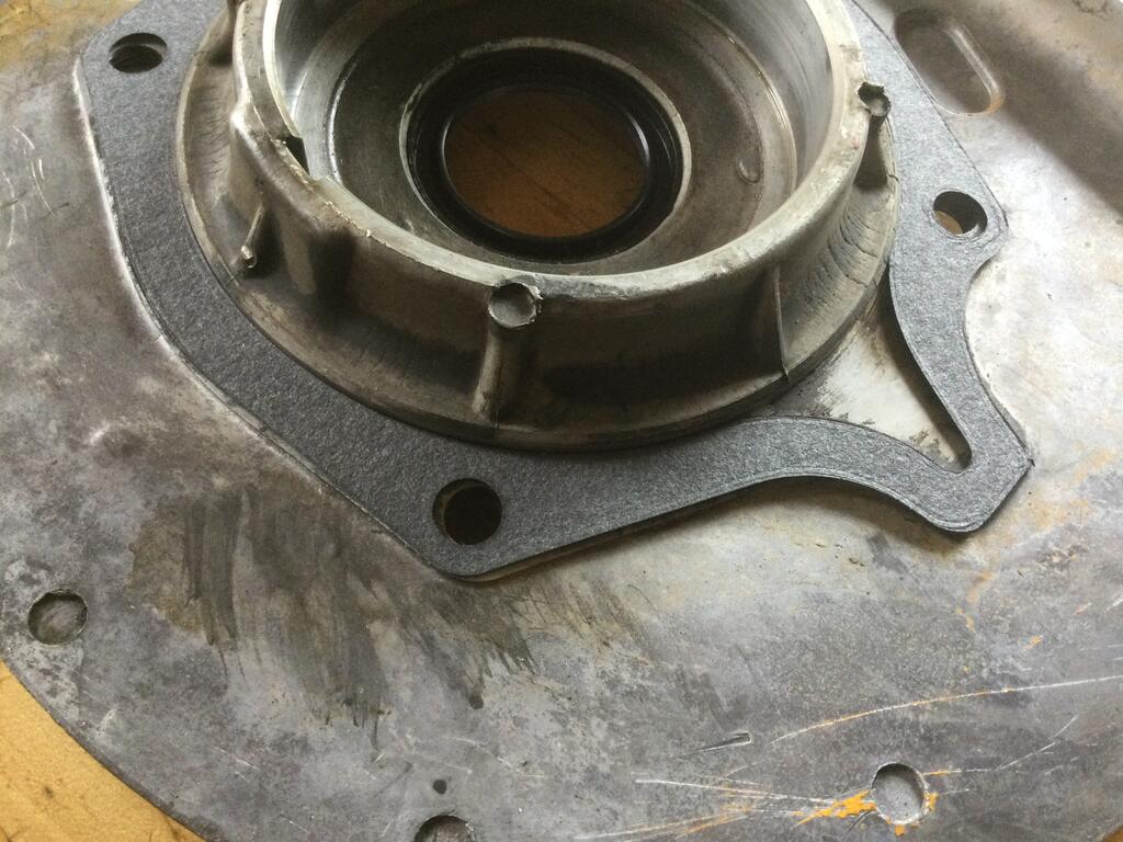

TC10284 114 #22 Posted July 8, 2021 Thanks! Neither of my bearing plates have that little V shaped thing where the seal goes, neither does the original seal. I'm assuming they made two different kinds? Share this post Link to post Share on other sites
richmondred01 2,383 #23 Posted July 8, 2021 (edited) 20 minutes ago, TC10284 said: Thanks! Neither of my bearing plates have that little V shaped thing where the seal goes, neither does the original seal. I'm assuming they made two different kinds? Yes. I had a k plate and gasket available for the photo. The Magum does not have the notch around the cam pin. The magnum also gets torqued to 115 inch pounds opposed to 35 foot pounds for the K series. Here’s what the Magnum shim looks like. Edited July 8, 2021 by richmondred01 Share this post Link to post Share on other sites
TC10284 114 #24 Posted July 8, 2021 (edited) I didn't have one of the gaskets that came off, just the shims and three of those. Two are good. Or appear to be. I found them on isavetractors I'll have to loosen the bearing plate. I went with the 35 ft lbs figure. Luckily I haven't put it back together yet. Edited July 8, 2021 by TC10284 Share this post Link to post Share on other sites
richmondred01 2,383 #25 Posted July 8, 2021 The black one is thicker and is the gasket. Ask Norman if he has the black gasket. You may want to get the pan gasket too. Share this post Link to post Share on other sites
