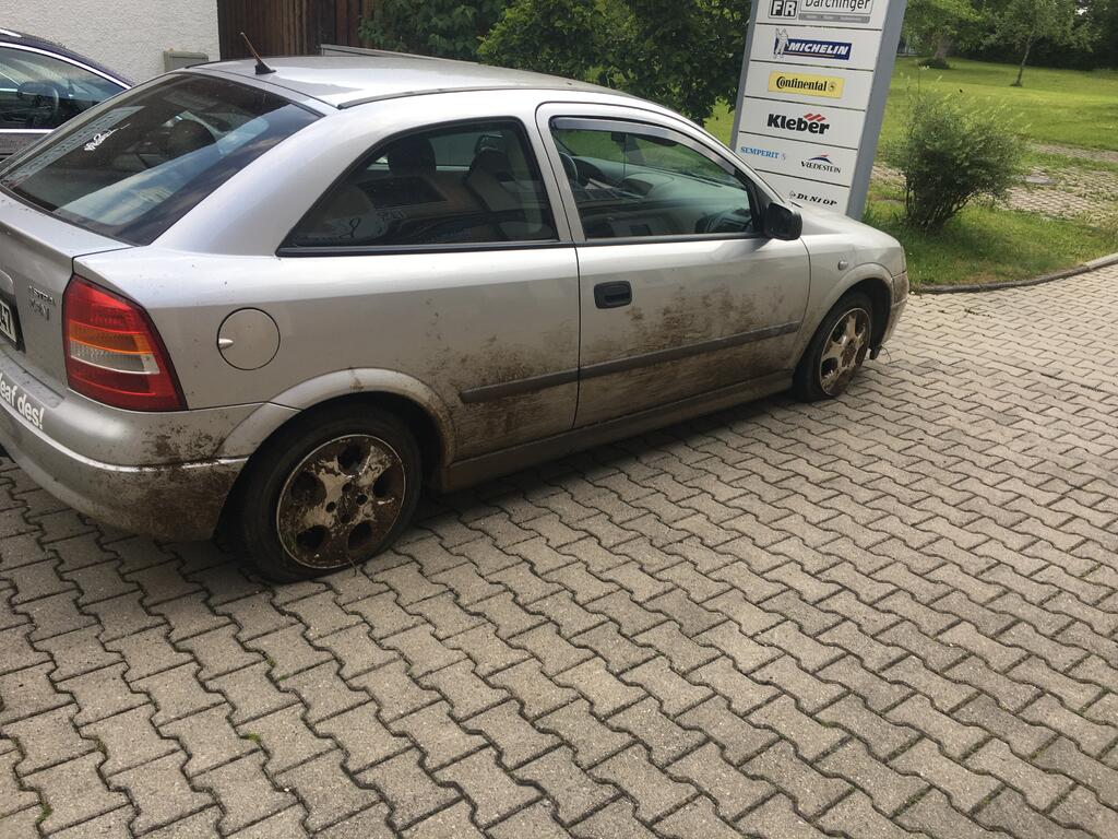

Tractorhead 9,214 #1 Posted June 29, 2021 Especially if you like it, to ride a little quicker. Today in the Morning when i was on the Way to the Company, in a sharp left curved road my rear right Tyre blasts. I instinctively steered again to get back the controll while the car nearly drifts sideways. Shift down and full Throttle to keep the car return in line on the road, but the after hard Full brake it begin to swing again and slide left into a Cornfield. Speed at the beginning was something about 90, so not too fast - i believe. Thanks to my quick reaction and a huge portion of Luck i was able to catch the Car back and set it more less „gently“ into an Field aside without hurt much. At least i was able to drive myself out of the Field and ride to a Tyre Service Station in step speed. After that i contacted the owner of the corn Field, he just said : “ hey Man, you be the the first who feels responsible, so in respect to that forget about it.“ After a pressurewash later and a full complete Check, we need just 2 new Tyres - that‘s all. No damages on the Axles or the Steering system at all. So my advice - please check regularly your Car or Trucktyres to prevent such an issue. It ain‘t funny at all. 6 1 2 Share this post Link to post Share on other sites

Tractorhead 9,214 #12 Posted June 30, 2021 I check every 2. re fueling the tyrepressure, doing that since i started driving ADAC Autorally, back in the 80ies. For me this is an automatically doing task. I thought it make sense to share that, to prevent a more inexpreienced driver come in such situation. I love it to ride on the borderlined last ripple of a Tyre - so between tyre start to slip and tyre loosing slip. In my past a race never be won only on a straight, or by dangerous overtaking maneuvers, a race will be mostly won in high speed driven curves, what is my beloved speedscenario, so i learned it and ride it since. Without that experiences over the years, i be not sure to catch the car that way, that i could and put it more less gently aside. However, this „nearly crash“ reminds me it is a good idea to share that and tell other peoples - please check your tyres regulary. If things are sticking in a tyre a blast can allway‘s happen. 2 1 Share this post Link to post Share on other sites
