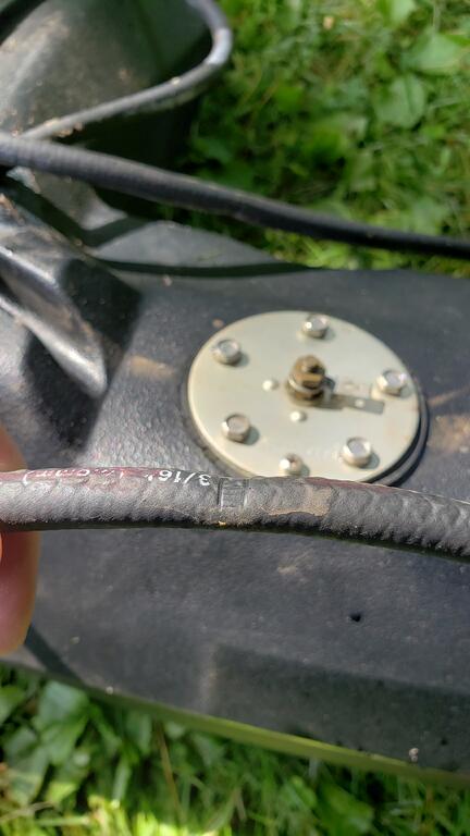

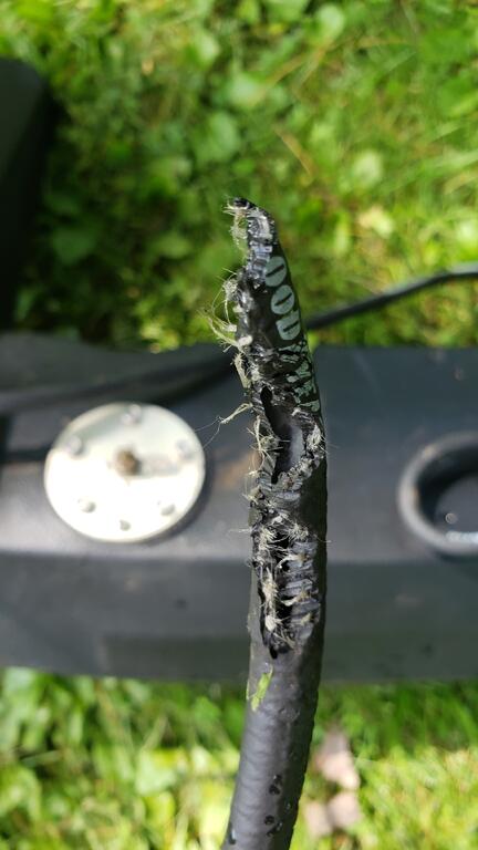

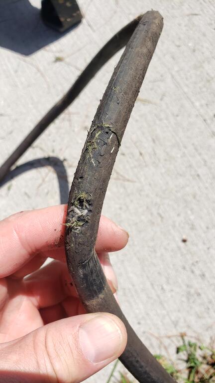

Kevin H 3 #13 Posted June 29, 2021 (edited) Looks like a mouse has gotten the best of me. The first picture is the end of the vent line. I will replace the fuel line. Should I replace the sender gasket too? I hope they are still available. Edited June 29, 2021 by Kevin H Bad text 1 1 Share this post Link to post Share on other sites
Handy Don 16,972 #14 Posted June 29, 2021 (edited) 3 hours ago, Handy Don said: Starving for fuel. Fuel filter clogged, gas tank cap vent clogged, pinched fuel line, fuel line hole letting it suck air, fuel pump pulling air or failing, sticking float in carb Yes! Annoying as all get out, but at least a relatively easy and inexpensive fix. Unless I saw signs of deterioration or other damage to the sender gasket, I would let it be. Its job is to keep debris out and sloshing gasoline in. If it is doing that, it's good. Edited June 29, 2021 by Handy Don 1 Share this post Link to post Share on other sites

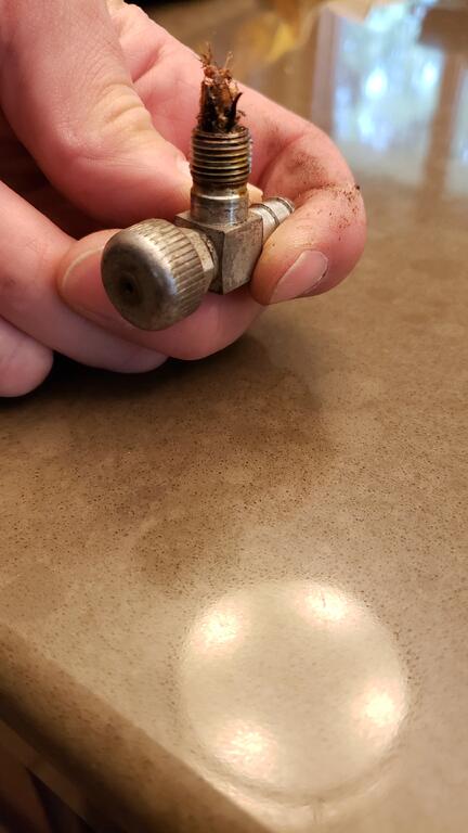

Kevin H 3 #16 Posted June 30, 2021 Glad I decided to remove the shut off valve... Share this post Link to post Share on other sites
