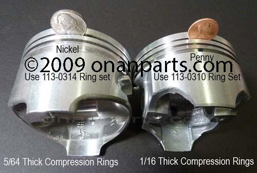

onanparts.com 185 #4 Posted June 28, 2021 There were two different ring sizes found on the P series Onan's. You must measure not only the bore, 3 1/4 is STD, but also the compression ring thickness to determine the correct rings. 1/16 part # 113-0310, or 5/64 part # 113-0314. No caliper or mic handy? Pocket change will do the trick...:) Share this post Link to post Share on other sites
crazy passworD 3 #5 Posted June 28, 2021 Thanks!You made it simple. Now i know what to order. Thanks again Share this post Link to post Share on other sites
