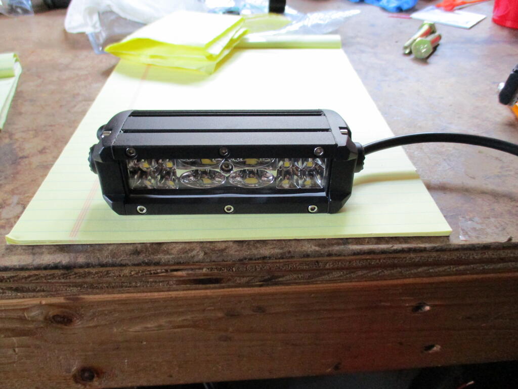

pfrederi 20,010 #10 Posted June 27, 2021 One more experiment. I temp wired a light bar like the one used on a snow horse to the flicker tractor. The was a slight flicker but not bad. pic of unit here. Bottom line in 20 years i have moved snow at night 3-4 times. The last two with LED light bars. They work great. I never really use lights other wise. so the flicker doesn't bother me. I would guess it is part cheap LED bulbs and part fluctuation in current on the older regulators. 1 Share this post Link to post Share on other sites

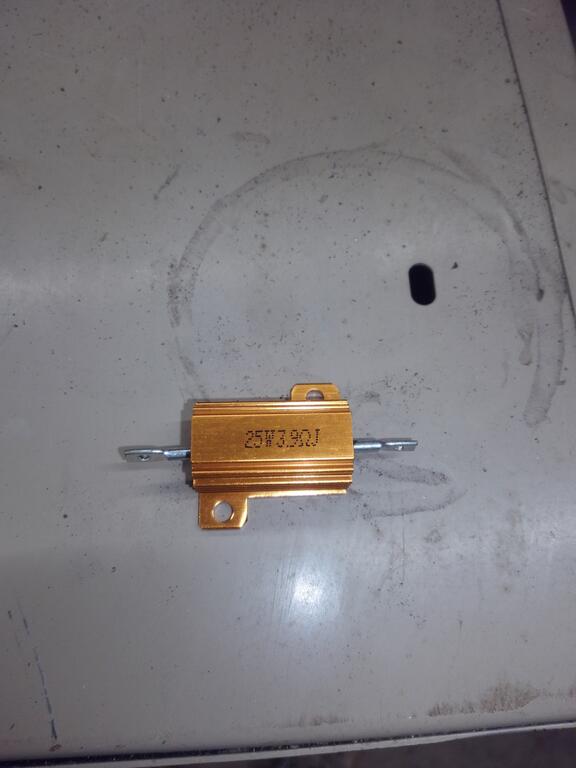

JPWH 6,544 #12 Posted June 27, 2021 You can install a resistor in your light circuit. If you want to try it on me your address and I'll sent you one to try. This is what I use. Jay 1 Share this post Link to post Share on other sites

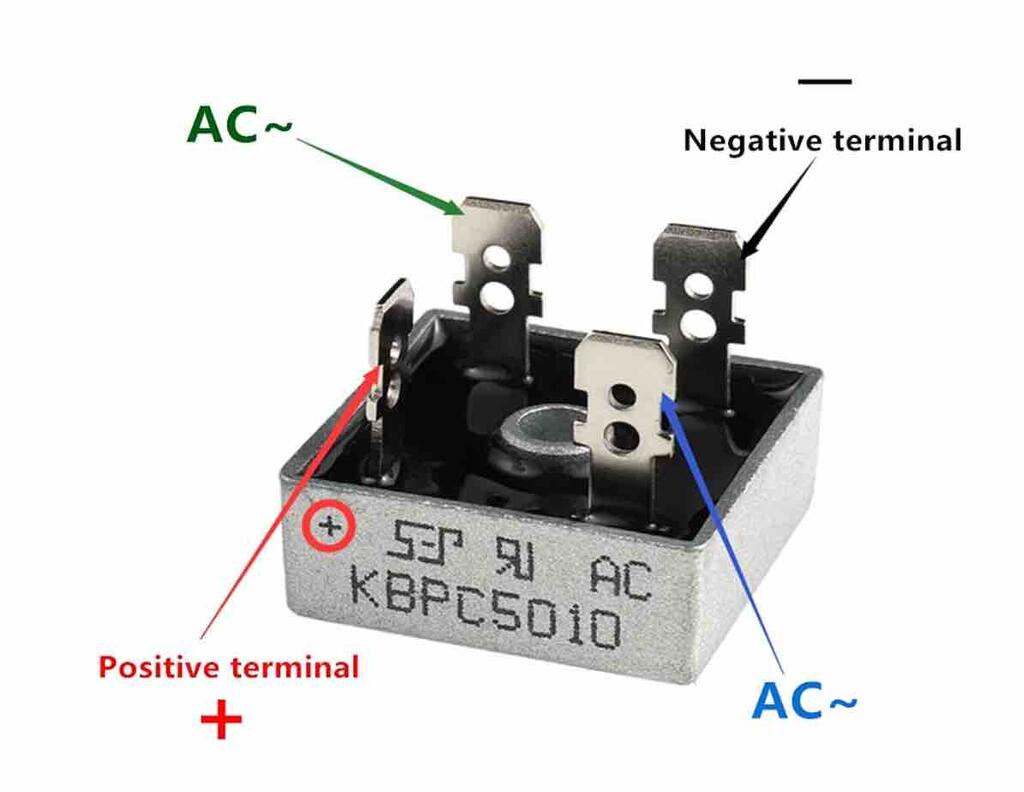

Handy Don 16,048 #14 Posted June 27, 2021 7 hours ago, 19richie66 said: Try running the lights directly off the battery and see if it stops. I believe the light power source on a lot of these tractors are A/C powered from the stator. LEDS need DC power from what I have read. I’ll be following along. 👍 This is exactly right. Check the wiring diagram for your tractor. If it has one lead from the stator for lights and a second one for charging the battery, then your lighting power is A/C. Even connecting directly to the battery doesn't guarantee smooth power. If you have a regulator, then your lighting is already set for DC and the cause of the flicker is something else! Be aware that the DC charging circuit for many WHs without regulators from the engine to the battery yields usually only 3 amps (36 watts). And remember that LEDs direct to the battery mean you are sharing the available power between the lights and charging the battery. The draw of the LEDs matters. For example, a pair of these would use 36 watts by themselves! The other approach is to put a diode bridge in your A/C circuit to convert the A/C to DC. @Tractorhead posted a digram for making one some time back. I'd probably buy one like this. Wire it up like this: 1. Move the stator wire from the engine that goes to the light switch to one of the "AC~" terminals on the bridge. 2. Connect the other "AC~" and the "-- Negative" terminals on the bridge to good solid grounds. 3. Connect the "Positive +" terminal on the bridge to the light switch. 4. MAKE SURE that the LEDs' RED wire is connected to the wire coming from the switch and that (as noted above) they are well grounded. 2 Share this post Link to post Share on other sites
