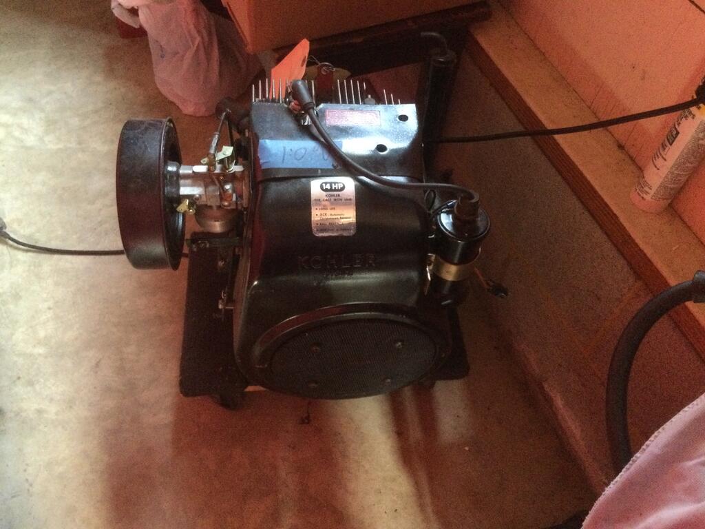

richmondred01 2,383 #13 Posted June 23, 2021 On 6/20/2021 at 2:10 PM, pfrederi said: It would provably be cheaper in the long run and more reliable to just get a bigger engine... Any additional hp you can squeeze out of that will be negligible except to your wallet. Best suggestion I can throw into this conversation is to install a Kohler k321 or a k341. You are about a hour away from me. I’ve got a rebuilt k321 wheel horse spec ready to drop in to that work horse. 2 Share this post Link to post Share on other sites
