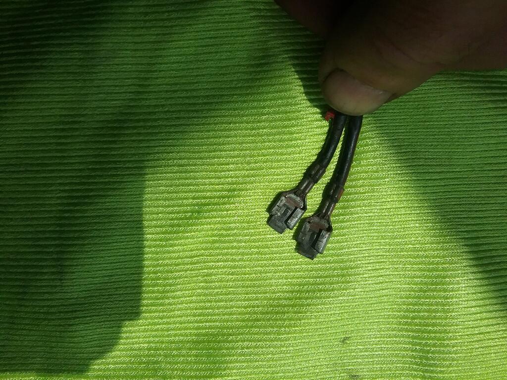

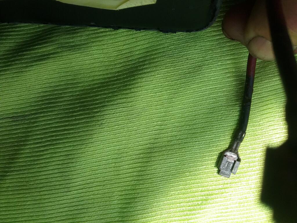

redone 45 #1 Posted June 18, 2021 I wanting the wire ends that fasten into the voltage regulator. From the engine Picture below What ever you may have. Thank you Bill Share this post Link to post Share on other sites
953 nut 63,986 #2 Posted June 19, 2021 Delphi Packard 2965867 Gm 56 Series Female Terminal 16-14 Ga. You can find them at NAPA or other quality auto parts stores or on 2 Share this post Link to post Share on other sites
Handy Don 15,767 #3 Posted June 19, 2021 FWIW, I finally got myself a dedicated crimping tool for the insulated connectors. I think it was about $15 and worth every penny! SO much faster and much better crimps than I ever had before. 1 Share this post Link to post Share on other sites
Achto 30,880 #4 Posted June 19, 2021 2 hours ago, redone said: I wanting the wire ends that fasten into the voltage regulator. From the engine Picture below What ever you may have. I have over 100 of them, I can send you a few. PM sent. 1 1 Share this post Link to post Share on other sites
peter lena 9,729 #5 Posted June 19, 2021 @redone while you are there on your connector issue, also check out or replace the multiple stage connector , regularly found cracking ,and shorting on those. OREGON connectors are what I used , also detailed a smoother wire routing to prevent chafing and wire stress , of course , dielectric grease , pete Share this post Link to post Share on other sites
