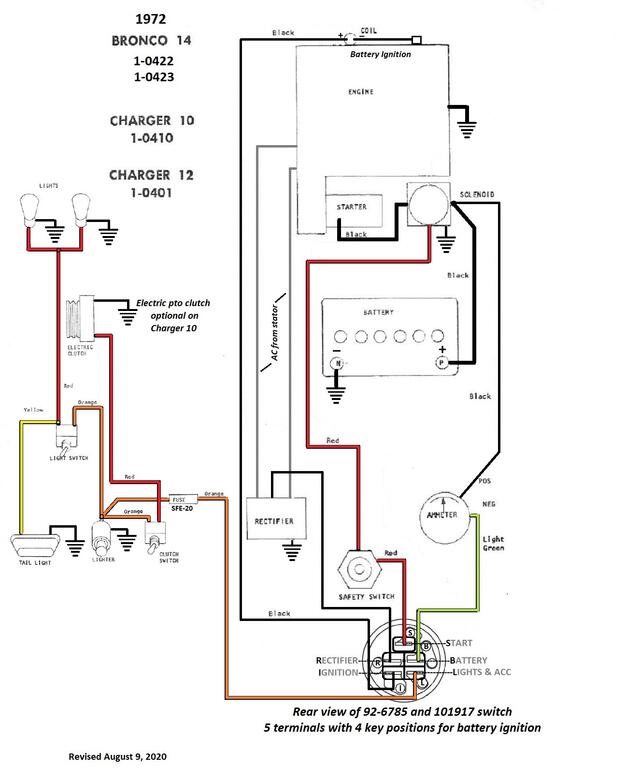

tallen4392 71 #15 Posted June 25, 2021 There is only two white wire going to to the reg looks like one is missing from the starter switch.. Pulled the switch and if I am reading the diagram right there should be a terminal marked r but there is not.. Anyone know what color the wire would be and it looks like it goes to a safety switch than the reg.. Don't know what the last owner did with the other wire strange Share this post Link to post Share on other sites
gwest_ca-(File Mod) 12,489 #16 Posted June 25, 2021 The regulator has 3 terminals? There are later models that used a 2-wire regulator. What are the other terminals on the ignition switch labelled as? Some are not correct and some have the identifier stamped into the terminal. Garry Share this post Link to post Share on other sites
tallen4392 71 #17 Posted June 25, 2021 I traced the wires from the switch one black ends up at the coil ..one goes to the starter solenoid.. one has a factory fuse that goes to the light switch light green goes to amp gauge and there is a orange wire rolled up and not going anywhere looks factory like that that's all 5 wires The reg has 3 terminals on it correct only two are used and go to the engine weird setup Share this post Link to post Share on other sites
gwest_ca-(File Mod) 12,489 #18 Posted June 25, 2021 Are you using this wiring diagram? Do you have the ignition switch shown? It has 4 key positions OFF, RUN with LIGHTS, RUN, START Share this post Link to post Share on other sites
tallen4392 71 #19 Posted June 25, 2021 Yes same same ign switch and wiring Share this post Link to post Share on other sites
tallen4392 71 #20 Posted June 25, 2021 The only wire not hooked up is the orange wire looks like it has been like that forever it is not a hot wire I would think a hot wire should be hooked to the reg but there r no wires hanging down there Share this post Link to post Share on other sites

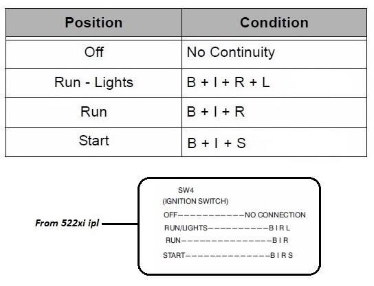

gwest_ca-(File Mod) 12,489 #21 Posted June 25, 2021 37 minutes ago, tallen4392 said: I traced the wires from the switch 1 one black ends up at the coil ..IGNITION 2 one goes to the starter solenoid..START 3 one has a factory fuse that goes to the light switch LIGHTS 4 light green goes to amp gauge BATTERY 5 a orange wire rolled up and not going anywhere looks factory like that that's all 5 wires The reg has 3 terminals on it correct only two are used and go to the engine weird setup Add a wire from the regulator DC+ terminal to the R terminal on the switch. That should make it work. With the key in the RUN position and the engine NOT running you should have battery voltage at the regulator DC+ terminal. If so the charging system should work. If the voltage increase after it starts it is charging. Here is the function chart for your switch Share this post Link to post Share on other sites
tallen4392 71 #22 Posted June 25, 2021 That is the problem there is no r on the ign switch I can tap into a wire and make it work Share this post Link to post Share on other sites

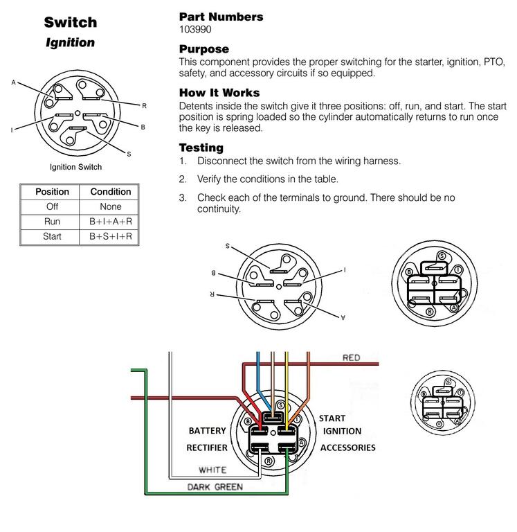

gwest_ca-(File Mod) 12,489 #23 Posted June 25, 2021 What are the terminals labeled as then if there is no R. You may have a different switch. They all look alike but the terminal locations make the difference and the way they function. The original body that holds the 5 wires at the ignition switch has a unique shape. A single terminal and 2 pairs below it. That is the only thing that is common between most switches. Viewing the switch from the rear that single terminal is a good reference so we are all taking the same language. Here is the same switch with 3 key positions. Garry Share this post Link to post Share on other sites
gwest_ca-(File Mod) 12,489 #24 Posted June 25, 2021 22 minutes ago, tallen4392 said: That is the problem there is no r on the ign switch I can tap into a wire and make it work The only available terminal is the I (eye) terminal but may overload the switch under continuous use. With an R terminal the current is shared between the I and the B terminals. Share this post Link to post Share on other sites
tallen4392 71 #25 Posted June 26, 2021 I hooked the orange wire from the switch that was not hooked up.to anything... Hot in the run position now it is charging like it should 13.5 volts at the battery at 1/2 throttle..Thanks for all the help hopefully it will continue to work... Share this post Link to post Share on other sites
