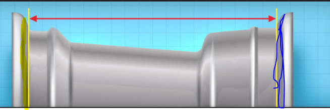

Maxwell-8 4,371 #2 Posted June 17, 2021 This area has to be rust free. May use wire brush and finish with sandpaper. Also use some grease or vaseline on that area and the same area on the tire. You could get them sandblasted but that's expensive where I live. Share this post Link to post Share on other sites
