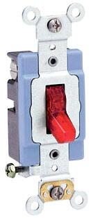

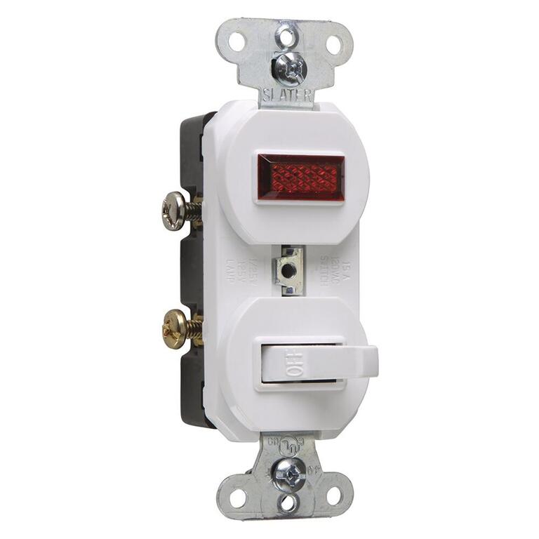

Handy Don 16,784 #5 Posted June 16, 2021 Good idea to isolate sound (it could also have shelves for storing infrequently used stuff). If you decide to have the compressor on/off switch outside the room, consider using a switch with a pilot light so if the compressor doesn't happen to be running when you leave the shop you'll be reminded to shut it off! These are the styles I use for "out of sight" lighting. 3 Share this post Link to post Share on other sites

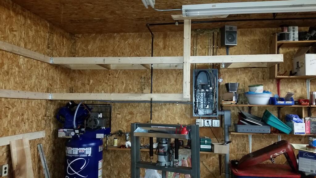

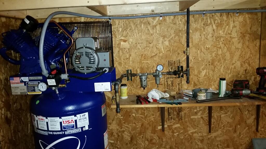

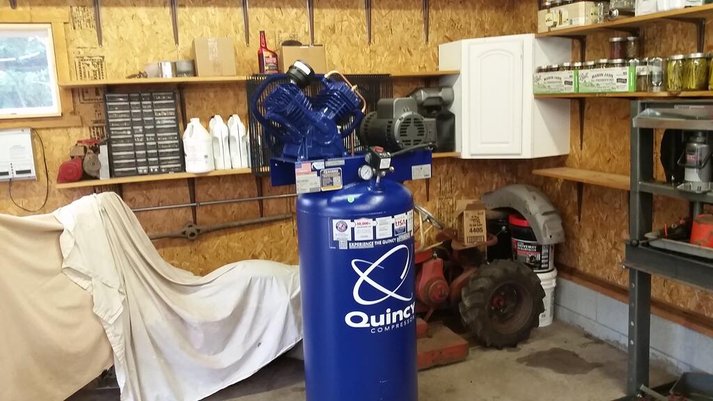

WHX?? 57,047 #11 Posted June 16, 2021 (edited) I was thinkin of doing the same thing seuadr. Not so much for noise but that too but so as not to take up floor space. Build a bump out big enough for the compressor with outside access and like Don said shelving on the compressor side for horse parts and for a blast cabinet that was open to the inside. Never did get around to it and now with the price of lumber . Tucked the Quincy in a corner where the corner cabinet & RJ was and called it a day. It doesn't run that much is fairly quiet and I actually enjoy hearing the beast run! 100 bucks just for the lumber in that 2nd pic and that wasn't including the plywood so I just repurposed the old shelfing 3/4 boards. Edited June 16, 2021 by WHX24 4 Share this post Link to post Share on other sites
squonk 47,053 #12 Posted June 16, 2021 31 minutes ago, WHX24 said: I was thinkin of doing the same thing seuadr. Not so much for noise but that too but so as not to take up floor space. Build a bump out big enough for the compressor with outside access and like Don said shelving on the compressor side for horse parts and for a blast cabinet that was open to the inside. Never did get around to it and now with the price of lumber . Tucked the Quincy in a corner where the corner cabinet & RJ was and called it a day. It doesn't run that much is fairly quiet and I actually enjoy hearing the beast run! 100 bucks just for the lumber in that 2nd pic and that wasn't including the plywood so I just repurposed the old shelfing 3/4 boards. I bet the Quincy goes WHOOMPA WHOOMPA WHOOMPA! 1 Share this post Link to post Share on other sites

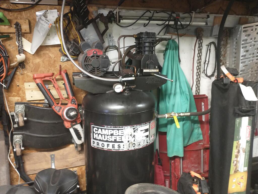

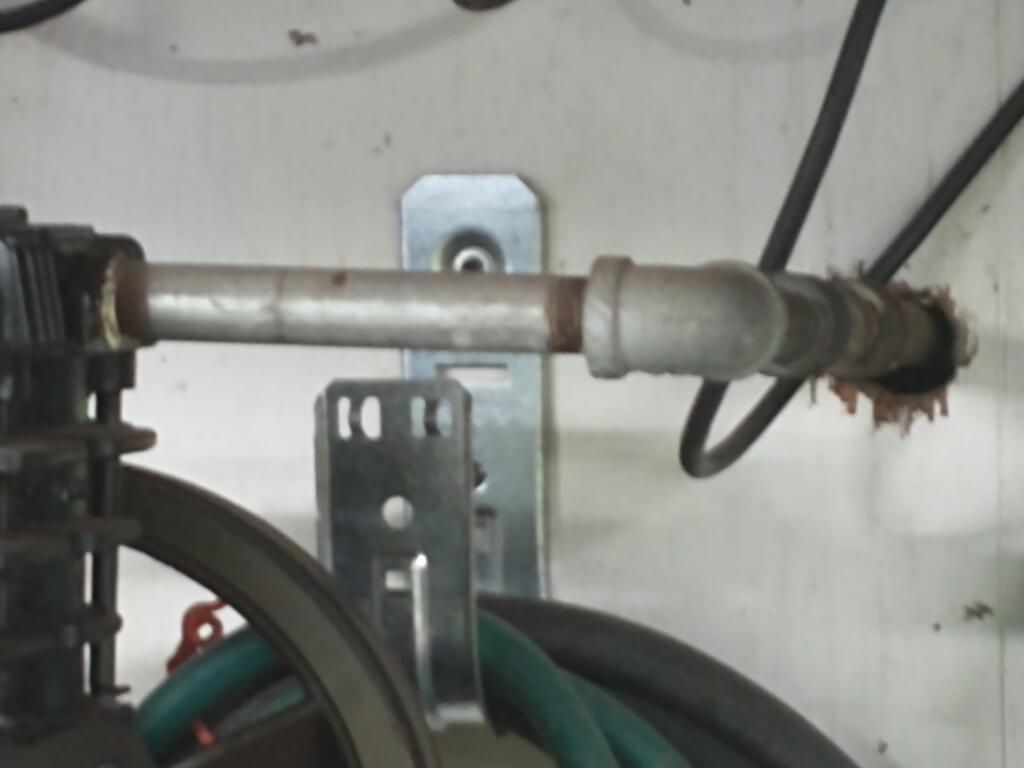

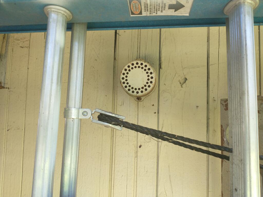

squonk 47,053 #13 Posted June 16, 2021 (edited) Here's my Compressor. Single stage Campbell Hausfeld. Almost 30 yrs. old. I got it for $475 when I was working at the Napa store. Still is on the pallet it was shipped on! We sold a crap load of these. Still has the original belt although I have a spare hanging. Replaced the head gasket about 4 years ago. The big thing I hate about cheapie air compressors, is the crappy air filter. I have this compressor in my back shop. I have run the air intake outside and use the only part of a Tecky engine that won't break,...... The air filter assembly! The air intake makes more noise than the compressor! Edited June 16, 2021 by squonk 2 2 Share this post Link to post Share on other sites
WHX?? 57,047 #14 Posted June 16, 2021 20 minutes ago, squonk said: I bet the Quincy goes WHOOMPA WHOOMPA WHOOMPA! No actually it got a pleasant whirl to it. They got it pulleyed to haul the mail. Share this post Link to post Share on other sites
