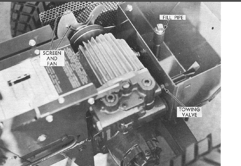

Gregor 4,847 #26 Posted June 30, 2021 Thanks Jeff. Once I get the parts for my fuel tank, I can actually drive this thing around, Get the oil in all the nooks and crannies, and measure the oil again. My trans didn't have a dipstick, or even a tube. I don't understand why anyone would have removed them, but apparently they did. The more I look into this, the more confused I get. I thought you could tell an Eaton from a Sundstrand, by the letter in the model number. S for Sundstrand, E for Eaton. My 876 doesn't have either letter, but the filter is on the right side, and it has the linkage similar to that of my 175, and 141. In front of the trans. It has ATF in it, and is has a dipstick with a plug and brass insert. No by-pass valve My 141 has an S in the model number, filter on right side, with the same style linkage, (in front) and it has the by-pass valve. It has 10w30, and a dipstick like Jeffs My 125 has an E in the model number. Filter on left side. Linkage on top of trans. No by-pass valve, has oil in it, and a dipstick like Jeffs My 175 has an S in the model number. Filter on right side, linkage in front, and a by-pass valve, and had no dipstick at all. I changed the fluid in all these transmissions. I'm sure I out in whatever came out. The trouble with the 175 is, it looks like chocolate milk came out. I am wondering if ATF is correct for the 876. That's what came out of it. BTW @Jeff-C175I am almost 70 years old. I can't remember even once, having FUN with math. Share this post Link to post Share on other sites

pfrederi 20,249 #29 Posted June 30, 2021 (edited) 1 hour ago, Gregor said: Thanks Jeff. Once I get the parts for my fuel tank, I can actually drive this thing around, Get the oil in all the nooks and crannies, and measure the oil again. My trans didn't have a dipstick, or even a tube. I don't understand why anyone would have removed them, but apparently they did. The more I look into this, the more confused I get. I thought you could tell an Eaton from a Sundstrand, by the letter in the model number. S for Sundstrand, E for Eaton. My 876 doesn't have either letter, but the filter is on the right side, and it has the linkage similar to that of my 175, and 141. In front of the trans. It has ATF in it, and is has a dipstick with a plug and brass insert. No by-pass valve My 141 has an S in the model number, filter on right side, with the same style linkage, (in front) and it has the by-pass valve. It has 10w30, and a dipstick like Jeffs My 125 has an E in the model number. Filter on left side. Linkage on top of trans. No by-pass valve, has oil in it, and a dipstick like Jeffs My 175 has an S in the model number. Filter on right side, linkage in front, and a by-pass valve, and had no dipstick at all. I changed the fluid in all these transmissions. I'm sure I out in whatever came out. The trouble with the 175 is, it looks like chocolate milk came out. I am wondering if ATF is correct for the 876. That's what came out of it. BTW @Jeff-C175I am almost 70 years old. I can't remember even once, having FUN with math. Your 876 has Wheelamatic (which in reality is a Sunstrand Hydro gear). it does have a tow valve and if you can push it with out releasing it your hydro is significantly worn. It needs a 1/2" wrench and is in the front of the underseat tool box ATF would have been correct for it. Edited June 30, 2021 by pfrederi Share this post Link to post Share on other sites
Gregor 4,847 #30 Posted June 30, 2021 36 minutes ago, pfrederi said: Your 876 has Wheelamatic (which in reality is a Sunstrand Hydro gear). it does have a tow valve and if you can push it with out releasing it your hydro is significantly worn. It needs a 1/2" wrench and is in the front of the underseat tool box ATF would have been correct for it. Duh You are correct. I remember it now. It's just not where all the other valves are. It's a good thing this 175 is my last tractor. It is getting too hard to keep track of things. Besides, I think it's going to be about 6 months before I can get any parts. Share this post Link to post Share on other sites

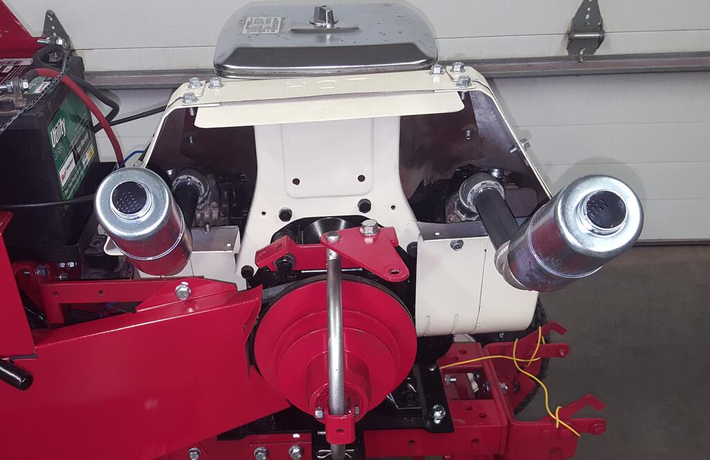

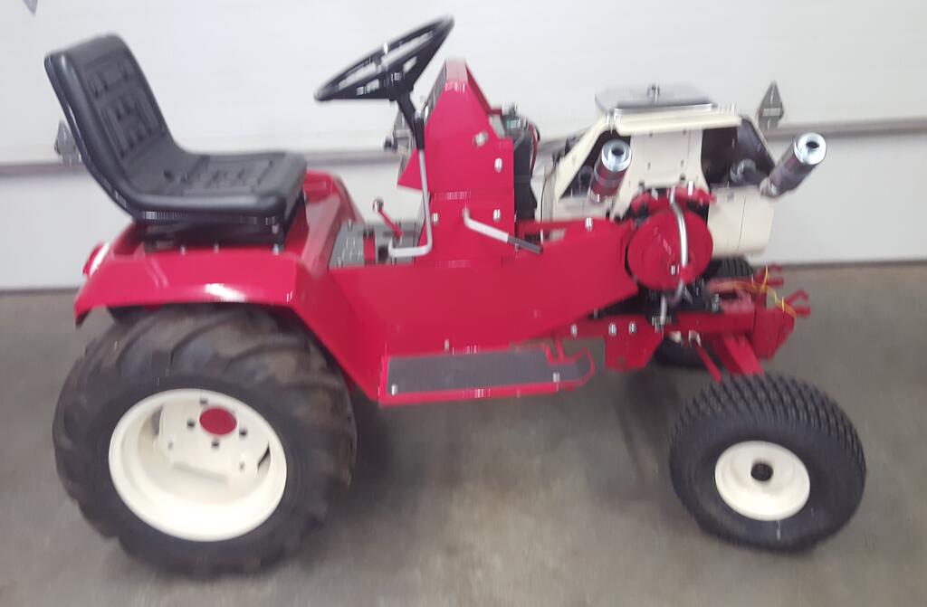

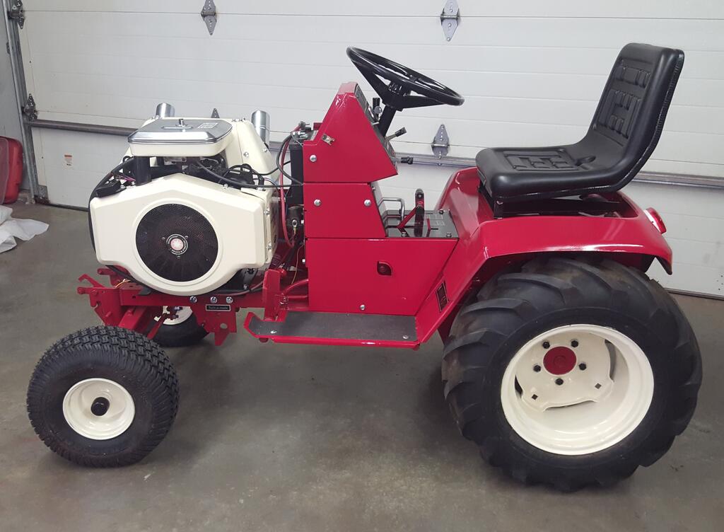

Gregor 4,847 #34 Posted July 2, 2021 Finally got to take the C-175 out for a gallop this morning. I received my fuel tank grommet and valve, so it no longer has to be tethered to a life line any more. According to tractordata, those aren't the correct fronts tires and wheels, but they were on there when I got it, so I replaced them with new tires. I still don't like the Deestones, but I bought them, I had them, figured I ought to use them. Maybe I'll get tired of looking at them and call Ed in Ohio. I think if I were to raise the fender pan 1/2", I could sneak 26" tires under there. We'll see. The Briggs twin sounds pretty good with dual exhaust. Just can't decide to point them up, or down. Still waiting on a few parts from Lincoln. Once I get the new hood, and get it painted an installed, the tractor will get it's new key chain and serial number plate. Share this post Link to post Share on other sites
Jeff-C175 7,207 #35 Posted July 2, 2021 (edited) 43 minutes ago, Gregor said: take the C-175 out Daggone you do work fast, don'tcha!? Looks wonderful Greg. I think the front tires look fine and the mufflers pointing up too. Maybe the latter will change when you get your hood on though, might change the look? Did you try straight out yet? Keep the front tires, the Briggs is not 'stock' either, so the machine is not a 'virgin' anyway... Edited July 2, 2021 by Jeff-C175 Share this post Link to post Share on other sites
