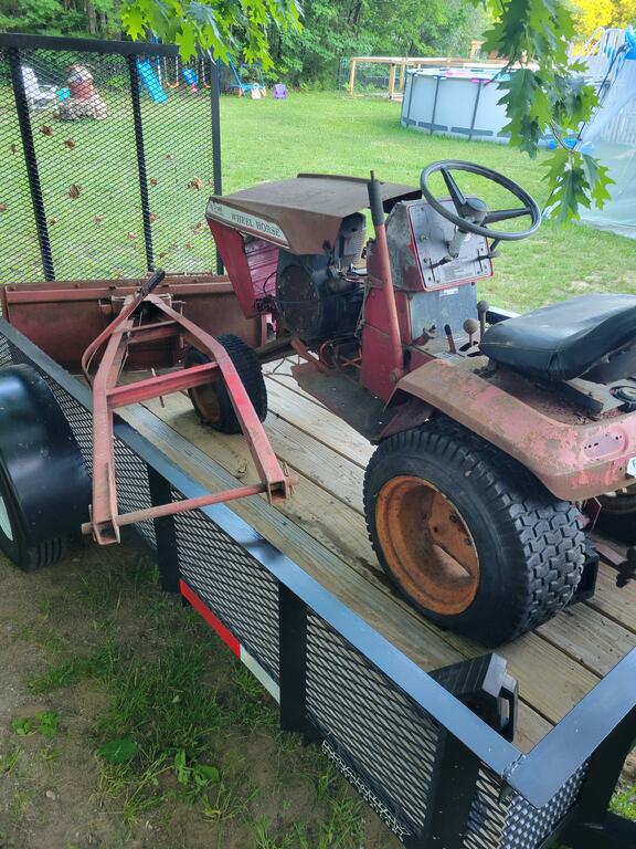

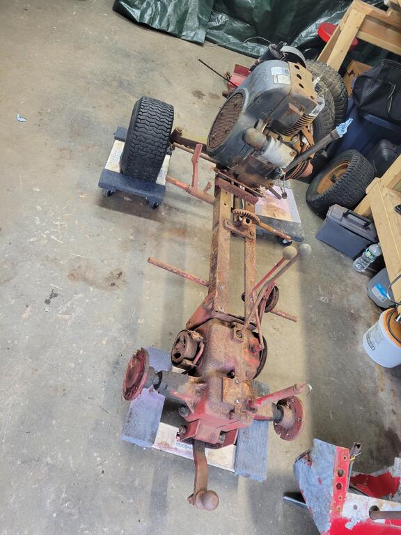

OldWorkHorse 3,156 #1 Posted June 12, 2021 So I acquired a 82 C-125, after stripping it of parts for what I could save, anyways so what is left is a nice frame a working tranny that needs new seals and a motor but how do u drain the oil from these K301AS shakers, I felt around under the engine couldn't feel a plug... I haven't crawled under it to look so could be in plain sight but fig I'd ask for sum help and any info on these engines anything different other then the oil pan on my k301s. Thanks for any info or photos! Share this post Link to post Share on other sites

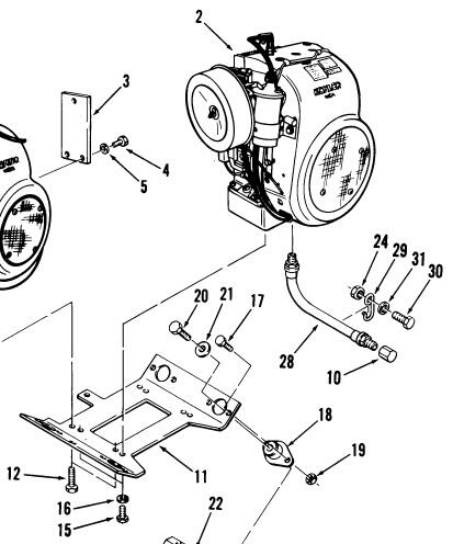

gwest_ca-(File Mod) 12,371 #2 Posted June 13, 2021 1 1 Share this post Link to post Share on other sites
Gregor 4,848 #3 Posted June 13, 2021 The "A" in your model number denotes a special oil pan. My 125 has a short pipe with a cap, coming right out of the bottom. 2 1 Share this post Link to post Share on other sites
tunahead72 2,635 #4 Posted June 13, 2021 1 hour ago, OldWorkHorse said: ... I haven't crawled under it to look so could be in plain sight ... There's your answer. 29 minutes ago, Gregor said: ... My 125 has a short pipe with a cap, coming right out of the bottom. Likewise on my C-105, with maybe a 3" extension. 3 1 Share this post Link to post Share on other sites
SylvanLakeWH 31,767 #5 Posted June 13, 2021 8 hours ago, gwest_ca said: Number 28 drain hose and 10 cap. Same as my 1982 C105. 1 Share this post Link to post Share on other sites
OldWorkHorse 3,156 #6 Posted June 13, 2021 Oh lovely. I saw a rubber hose hanging down kinda under engine thought was a weird place for a breather tube since there is no end cap on it. Guess I know where the oil is... thank you guys for the info! 1 1 Share this post Link to post Share on other sites
