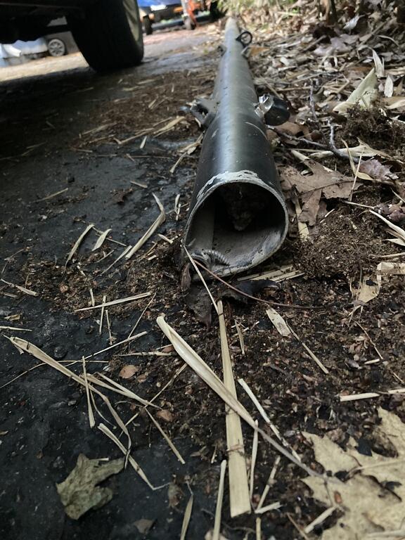

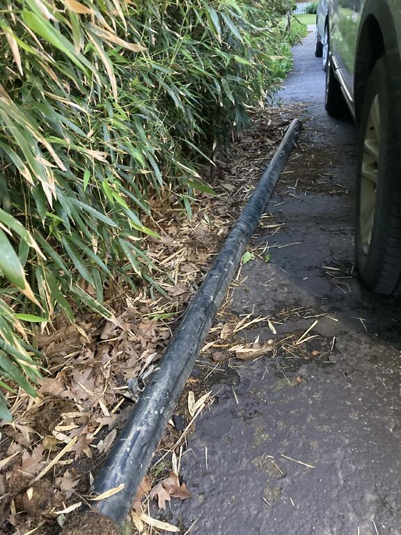

SylvanLakeWH 30,652 #1 Posted June 10, 2021 Been looking for a nice sailing mast to convert to a flag pole for about a year… finally got one off CL for decent price delivered. Good shape. 23’ tall. Going to go with about 16’ tall (from grade) so I can handle it myself… Looking for advice on how to anchor it. I’m thinking about 3-4’ deep hole, 18” wide, filled with concrete… Sleeve will be an issue since it’s not round… should I just permanently sink it in concrete or any good ideas for a sleeve? Maybe pvc and sand / wedges? Ideas / methods of getting it plumb straight are welcome. Any thoughts appreciated… 2 Share this post Link to post Share on other sites

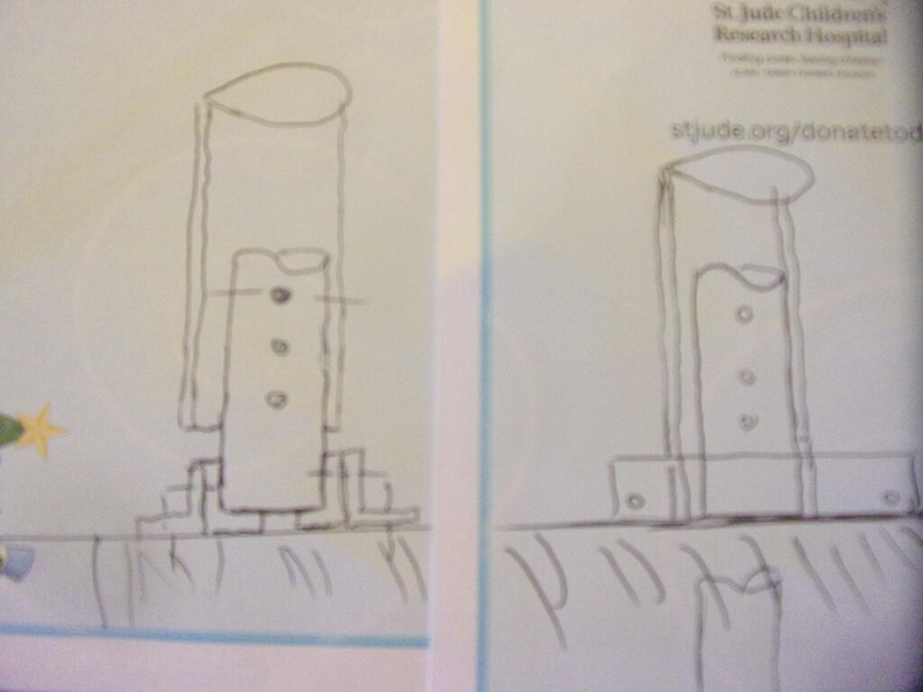

Ed Kennell 45,045 #4 Posted June 10, 2021 I like Tuul's idea of finding a pipe that fit inside mast. But I would add 4 pieces of angle iron that would allow the pole to be tipped over and raised easily.. Pardon my hi-tec cad system 4 1 Share this post Link to post Share on other sites
Wheel Horse 3D 3,824 #5 Posted June 10, 2021 2 hours ago, The Tuul Crib said: Find a piece of pipe that just fits inside the mast and sink it into the concrete enough to slide the pole over it and fasten it with a thru bolt. If you have to take it down for any reason you can. Definately! PO of our house concreted in the main mast of our flagpole. At some point the truck on top got damaged and is now sharp. In the right wind conditions the flag can flip over the top and get damaged by the truck. Now I have to cut or something to get the pole down and replace the truck. 1 2 Share this post Link to post Share on other sites

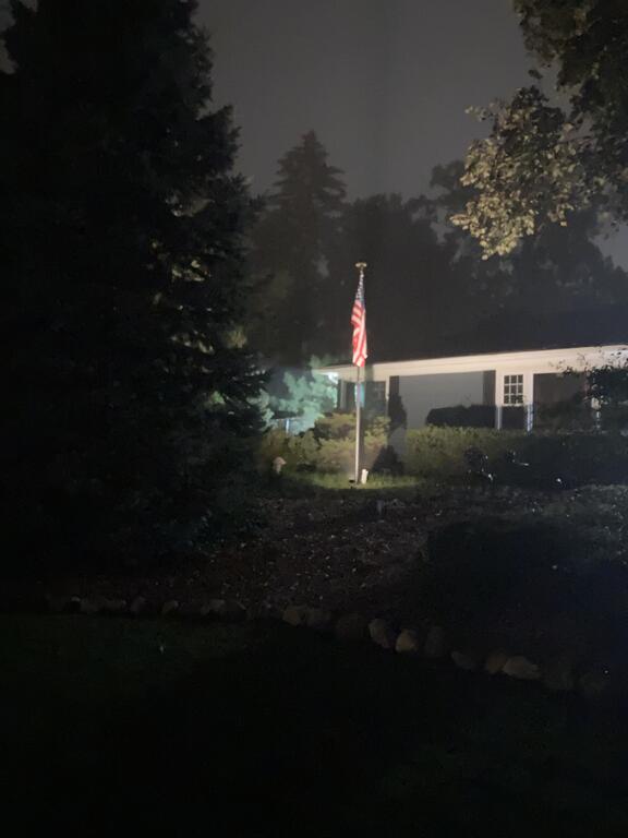

SylvanLakeWH 30,652 #11 Posted February 6, 2022 On 7/30/2021 at 10:24 AM, Jeff-C175 said: Maybe we'll just wait for you to post a link to where you found one? Or, maybe another new member will join shortly to tell you where you can get them. I just saw this. I have a low voltage led spot light on mine. Works great! 1 Share this post Link to post Share on other sites
