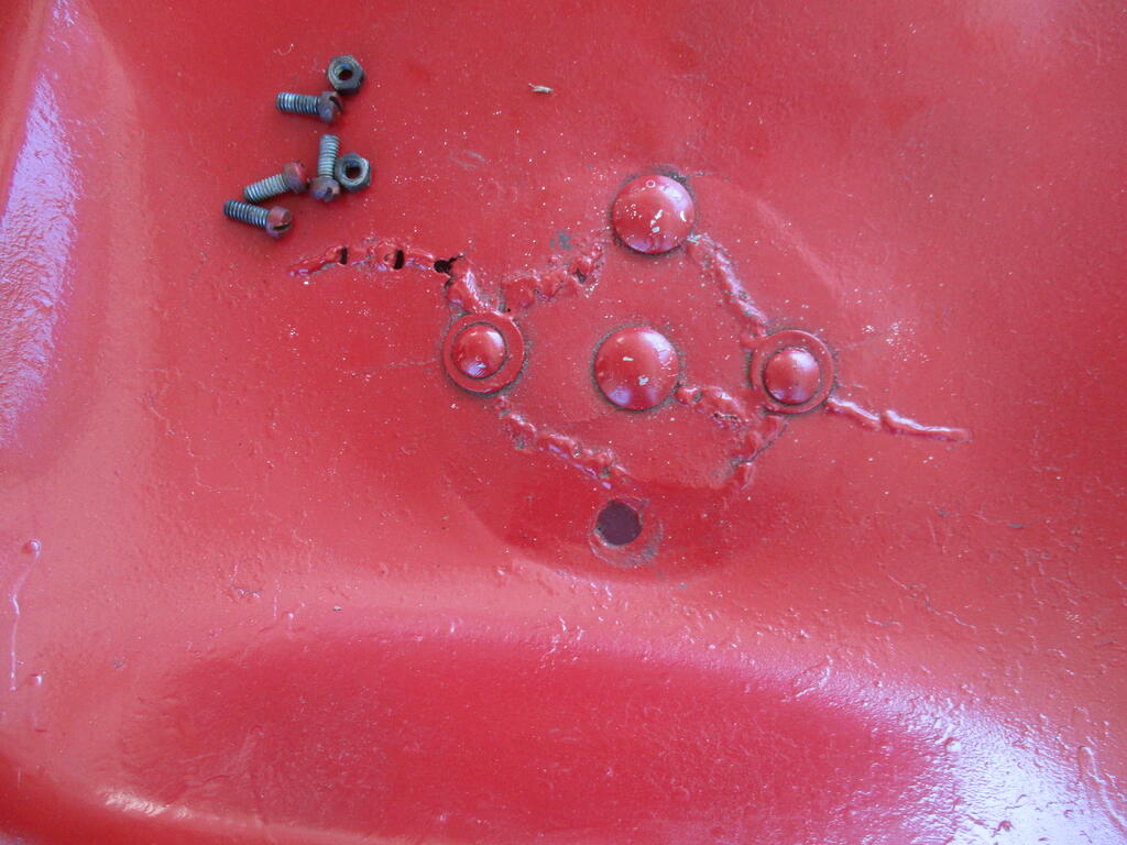

Kenneth R Cluley 689 #2 Posted June 9, 2021 Here is picture of casting, and P.O. idea of hood retention system. I would like to try aluminum insert brazed into area cut out. Anyone successful with this repair? Or alternate method of repair? 1 Share this post Link to post Share on other sites
Pullstart 70,694 #3 Posted June 10, 2021 I’m going to go on a limb and say clean all that crap out, then PC-7 epoxy you a filler and drill/tap it or insert a captive nut while it’s wet. This aluminum welds absolutely terrible! Macon, GA. Just drove through there... they have an amazing Mexican restaurant and an even better Wings joint in their shopping mall. Share this post Link to post Share on other sites
