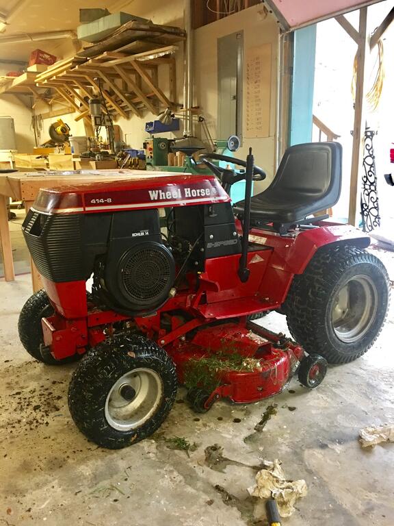

414-8 12 #1 Posted June 8, 2021 I have been looking for a wheel horse for a while to build a stock puller .I found one at a good price this weekend and bought it a 414 -8, the price was right ,it has a safety switch problem but does start with the solenoid jumped ,then won't turn off with key .now that I got it home and played with it I think it may be to nice to strip I am having a hard time trying to decide if I should keep it as a work tractor or make my puller out of it ,it has nice seat nice paint new front tires ,a mower deck, should I strip this nice tractor and beat it or fix wiring failure and cut grass on Sunday mornings .I have spent a few hours tracing wires looking for bad ground or bad switch can't find it .I got a feeling it may be they key switch but wiring is not my cup of tea, 6 1 Share this post Link to post Share on other sites

JCM 11,152 #6 Posted June 8, 2021 That tractor looks real nice from here, don't see a lot of nice ,clean 414-8's around. Just my opinion. 1988 or 89 ? 3 Share this post Link to post Share on other sites

Maxwell-8 4,371 #14 Posted June 8, 2021 414-8's make great pullers. they have the 8 pinion 8 speed. But your's looks to nice to go pulling with. That's a 2000$ Horse here in the condition it looks like in you picture Great score Share this post Link to post Share on other sites

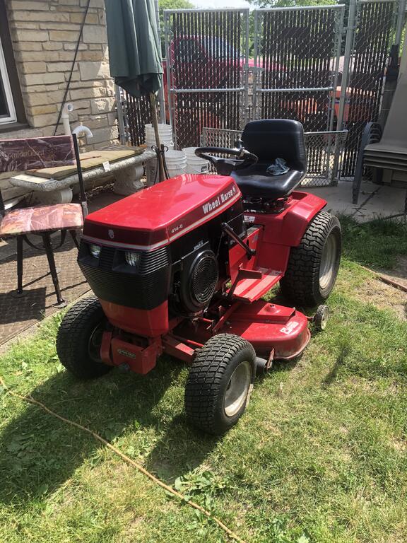

peter lena 9,893 #22 Posted June 8, 2021 @414-8, hope you retain what you have , they are getting scarce , on your rear lights , walmart has an exact bolt on size shape led light for $ 6 , have them on all three of mine , very good low light protection near a road . also added a ground cable from the side of battery ground rail , to the corner of my engine block , 1st and last pictures , also note the added washers 1st picture , to tighten up and smooth out pto lever , battery tender plug in cable , last picture . the ground cable enhances all electrical areas , pete Share this post Link to post Share on other sites
