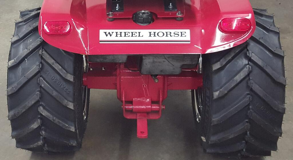

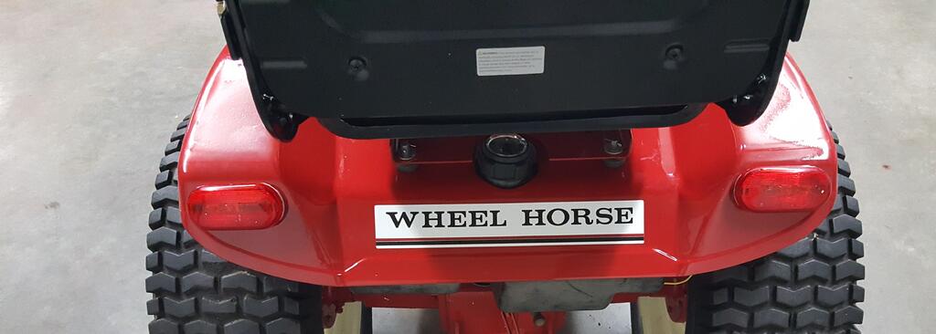

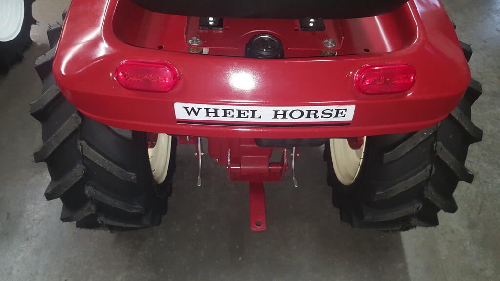

Gregor 4,848 #29 Posted November 30, 2021 (edited) 23 hours ago, stegs said: The c-141 had 22 inch tires (maybe, but only 7.5 inches wide) The 141 stock tire was 23X8.5-12 as per Tractordata.com. Here is the stock turf tire Here is 23X10.5-12 Carlisle Super Lug (wheel spacers required) The bottom set of tires are Carlisle Tru Power not Super Lug Edited December 1, 2021 by Gregor 1 Share this post Link to post Share on other sites
Paul Dietrich 19 #30 Posted December 1, 2021 Gregor, which tire is the Deestone ? Share this post Link to post Share on other sites
Gregor 4,848 #31 Posted December 1, 2021 (edited) 28 minutes ago, Paul Dietrich said: Gregor, which tire is the Deestone ? In the pic directly above, neither. The top set is stock tires. What ever they are. The bottom set, Carlisle. It is the same tractor. Edited December 1, 2021 by Gregor Share this post Link to post Share on other sites
Maxwell-8 4,371 #32 Posted December 1, 2021 7 hours ago, Gregor said: In the pic directly above, neither. The top set is stock tires. What ever they are. The bottom set, Carlisle. It is the same tractor. How wide are those alloy rims? 7" is stock Share this post Link to post Share on other sites
Gregor 4,848 #33 Posted December 1, 2021 1 hour ago, Maxwell-8 said: How wide are those alloy rims? 7" is stock 10" nominal 1 Share this post Link to post Share on other sites
