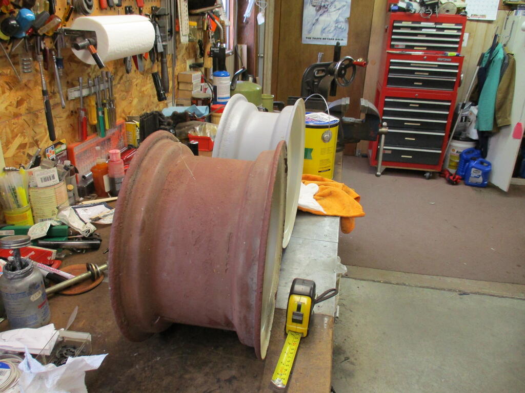

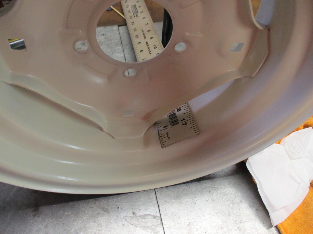

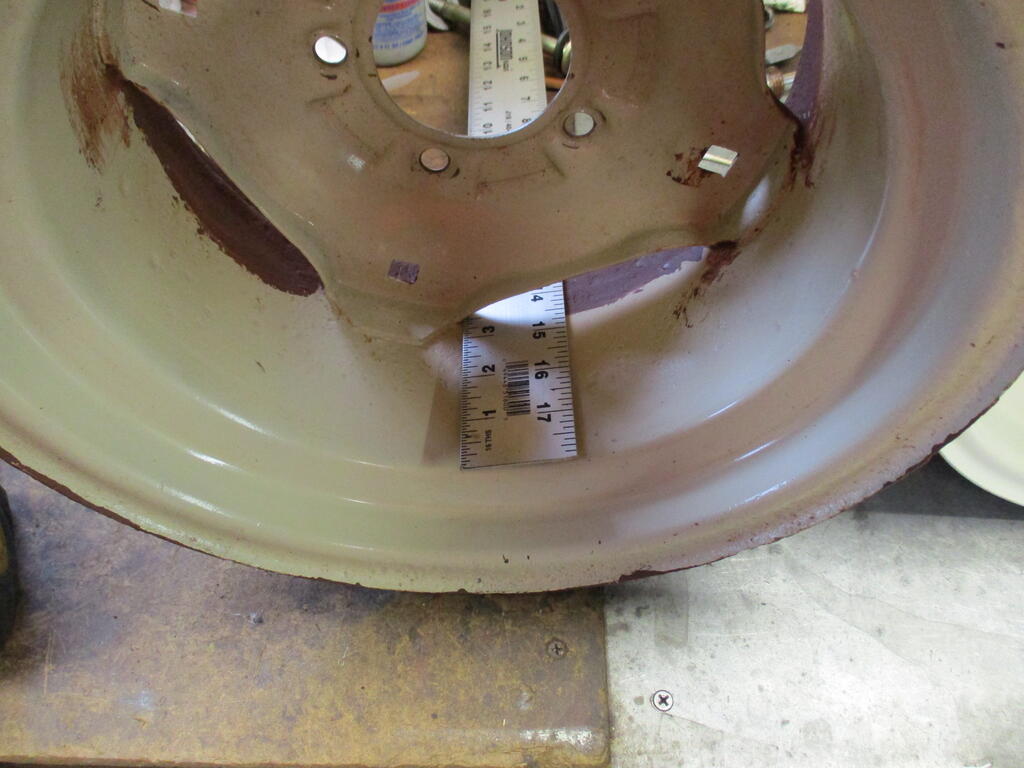

pfrederi 21,184 #6 Posted June 4, 2021 First lets make sure we re discussing the correct "rim width" Some early 300 series (308 and 310) came with 5" wide wheel. Later they and most other horses used 7" wide rims. 23 8.50 will work fine on the 7" rims 10.50 will fit but look bulgy. Quick way to see what size rims you have look at pics. First shows difference between 5" and 7" secon pic shows how to measure and what a 7inch would show..third is a 5" Share this post Link to post Share on other sites

tplace 5 #9 Posted June 5, 2021 4 hours ago, pfrederi said: First lets make sure we re discussing the correct "rim width" Some early 300 series (308 and 310) came with 5" wide wheel. Later they and most other horses used 7" wide rims. 23 8.50 will work fine on the 7" rims 10.50 will fit but look bulgy. Quick way to see what size rims you have look at pics. First shows difference between 5" and 7" secon pic shows how to measure and what a 7inch would show..third is a 5" Thanks for the explanation, I should have thought of that, makes perfect sense. Mine are 7", I'm good to go with the 8.50" 2 Share this post Link to post Share on other sites

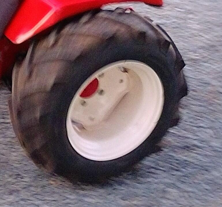

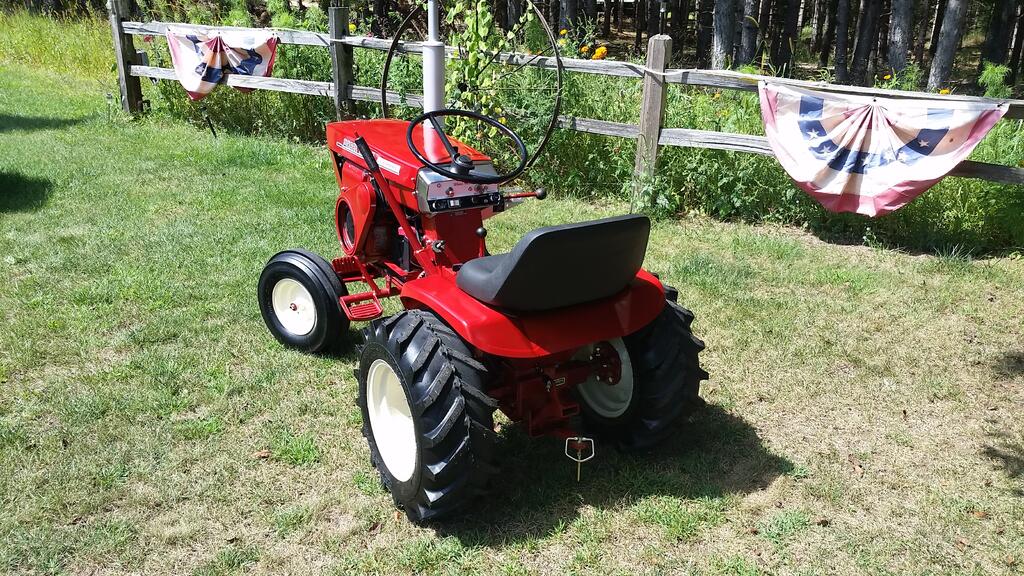

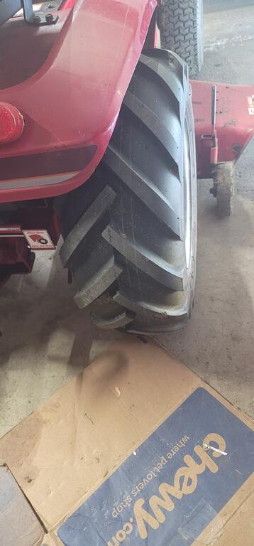

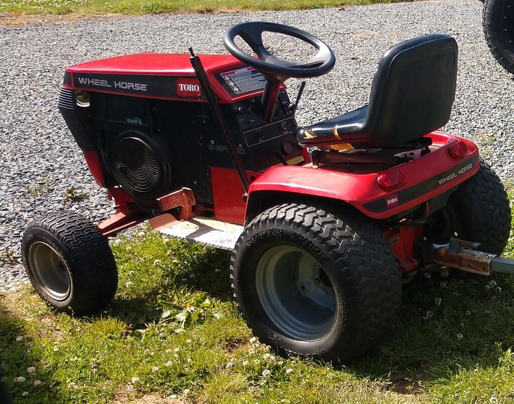

Lee1977 7,786 #12 Posted June 5, 2021 4 ply 9.50's work well on 7" rims. The 2 ply 9.50's round up in the center with very little air in them. I took a set of 2ply tires off my 520 right after I got it. Here is a picture of the 2 ply 23 x 9,50 x 12 when I got the 520. Here is a picture of the 4 ply 24 x 9.50 x 12 that is on it now No Uni-drive is just the name of the transmission. They are not limited slip, but the do real well as long as you are going straight. 1 Share this post Link to post Share on other sites

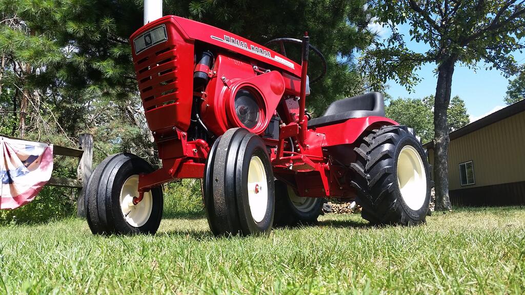

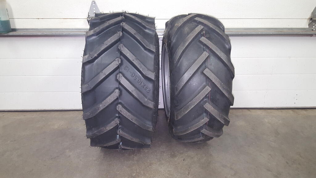

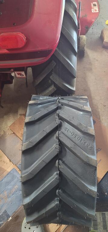

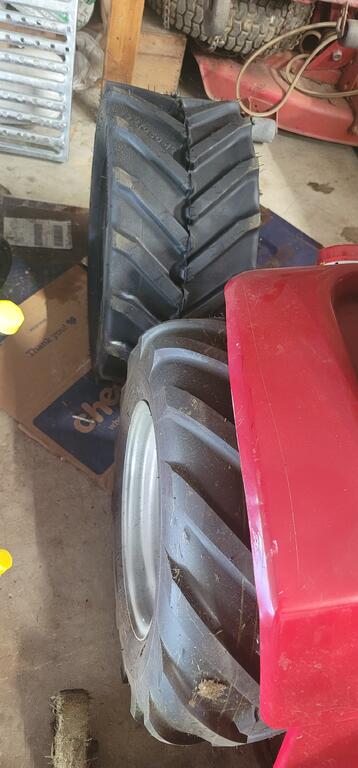

kpinnc 18,979 #13 Posted June 5, 2021 If your rims are 7.5 inches wide, you can use 23x10.50-12 TURF tires. For ag style cleat tires, I would stay at 23x8.50-12. The bars are stiff and force all the "flex" to the sidewall. The pics below represent both sizes on a 7.5 inch rim. 1 Share this post Link to post Share on other sites

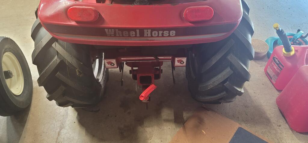

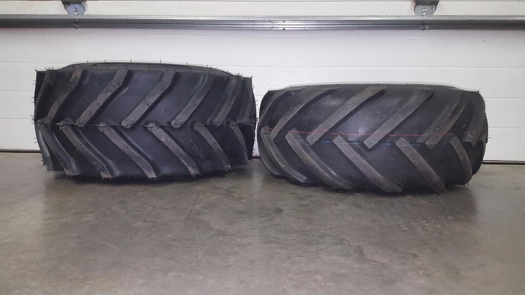

Gregor 4,848 #22 Posted November 29, 2021 I have Deestone 12 X 10.5 - 12 on a tractor. I also have Carlisle 12 X 10.5 - 12 Super Lug on a tractor.These are on the same size rim. There is about 1/2" difference in height, but a big difference in width. Notice in the second pic, you can see the rim sticking up above the tire. 1 Share this post Link to post Share on other sites
Snoopy11 5,731 #23 Posted November 29, 2021 8 hours ago, Gregor said: I have Deestone 12 X 10.5 - 12 on a tractor. I also have Carlisle 12 X 10.5 - 12 Super Lug on a tractor.These are on the same size rim. There is about 1/2" difference in height, but a big difference in width. Notice in the second pic, you can see the rim sticking up above the tire. Looks pretty there buddy! 8 hours ago, Maxwell-8 said: AG are very stiff and with a 7" rim you can not go wider then 10". ATV tires are made for 7" rims. That is what every ATV has. with those you can go up to 12.5" wide. I personally like that fat tire look. But that is my personal preference. I thought about doing the same with width. What I ran into though is an issue with my plow blade subframe. So... right now... there isn't much clearance between my 18x8.5-8 tires and the plow blade frame. So, I would have to use wheel spacers if I went wider on tires. I don't know if anyone else would have a similar issue as I have, but I just thought I would put that out there, just in case! I also like the bulging over the rim look! Don Share this post Link to post Share on other sites
Maxwell-8 4,371 #24 Posted November 29, 2021 9 hours ago, Gregor said: I have Deestone 12 X 10.5 - 12 on a tractor. I also have Carlisle 12 X 10.5 - 12 Super Lug on a tractor.These are on the same size rim. There is about 1/2" difference in height, but a big difference in width. Notice in the second pic, you can see the rim sticking up above the tire Any idea of the actual tire width from the right one? Share this post Link to post Share on other sites
Gregor 4,848 #25 Posted November 29, 2021 9 minutes ago, Maxwell-8 said: Any idea of the actual tire width from the right one? Took me a bit to find this. 1 Share this post Link to post Share on other sites
