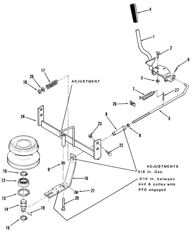

gwest_ca-(File Mod) 12,483 #5 Posted June 5, 2021 If adjustment does not work the pto clutch friction material may be worn out from slipping. Share this post Link to post Share on other sites
gwest_ca-(File Mod) 12,483 #6 Posted June 5, 2021 The 3/8" clearance means the spring is collapsed 3/8" and should provide enough pressure to drive the mower. Share this post Link to post Share on other sites
