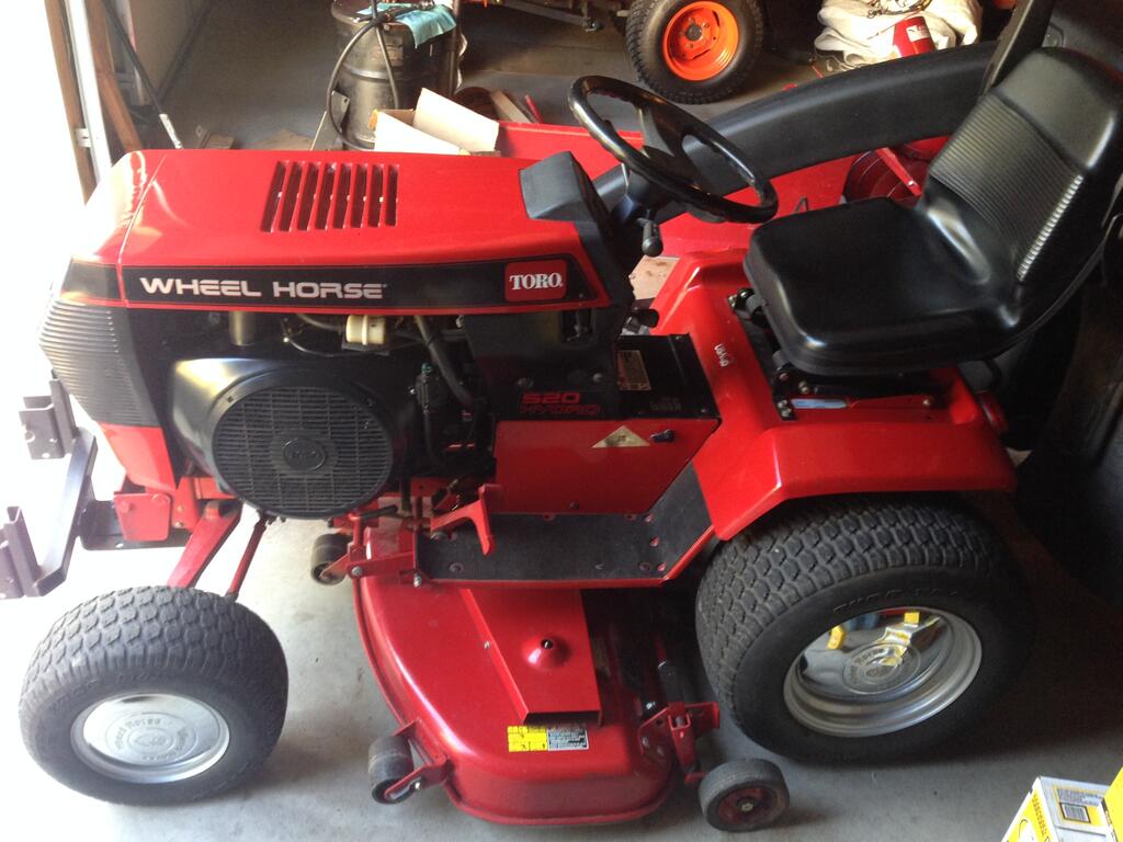

Daron1965 644 #1 Posted June 3, 2021 I found a 520H in very good shape. Some rust on the deck. 653 hrs. Original tractor with hubcaps. Asking $950 Im not real familier with them. Can you guys please tell me the good and bad? I may make it a garden plow tractor if I get it. What do you think. 2 Share this post Link to post Share on other sites
horseyheaven 113 #2 Posted June 3, 2021 The 520H is a good tractor. I personally like the Onan engines, even though some will say stay away from them. Make sure you listen for any valve train noise like a tic tic sound. I bought one that was running and still ran good. It had a tic sound and after I got it, I found out it was a loose valve seat. That tractor had 1300 hours on it and it was not really well cared for. So, I fixed it with another block that I found that was like new. So, you need to watch out for things like that, but overall, they are good. If you get it, make sure to blow out the cooling fins on the motor after each mowing with compressed air and when grass begins to collect on the flywheel screen when you are mowing, be sure to brush it off. If you maintain these engines and keep them cool, they will run a long time. Another thing that I have done to all of my Onans, (four now) is slot the belt guard on the rear cylinder to help with cooling and air flow. You will also want to make sure the grommet is around the oil filter for optimum cooling. It may not hurt to do a compression check of the engine if the seller is okay with it. I purchased a used Onan engine once that I heard run and it ran great. When I was ready to do the transplant onto another Wheel Horse, I did a compression check to see the condition of the motor before I put it on. Guess what? It was only running on one cylinder because it had a broken rod. The pieces were all laying in the oil pan and it ran great with no vibration or knocking. I was fooled. So, there are many things that can happen. The working hour meter on this tractor was showing 900 hours. I am not telling you this because I want to scare you away, just telling you what happened to me. Compression on my good running Onans is around 120 psi on each cylinder. I do have one with unknown hours that is down to about 90 psi on each bank and it still runs good. As far as the tractor goes, the 520 is rock solid and tough. I use mine year around (one 520H, one 520HC, one 416-8, and one D-160) with mower decks, snow blades, snow blowers, tillers, and front end loaders. The newest 520 I have is 30 years old and it never misses a beat. The parts support is through Toro and most things are still available. However, there are many parts suppliers here Wheelhorsepartsandmore.com and Onanparts.com that carry many things you may need. It it were me, and I were in the market for another garden tractor, I would buy another 520H or HC. Good luck on your decision. Let me know if you have any more questions. 5 1 Share this post Link to post Share on other sites
tom2p 2,394 #3 Posted June 4, 2021 (edited) well maintained 520 is a great tractor ; this was Wheel Horse top garden tractor for years and many feel it is the 'King' this was a $6K garden tractor (new) 20hp opposed twin Onan produces around 32-33 ft lb torque which few other similar garden tractors will match Eaton 1100 transmission is durable if the tractor was not parked / stored inside - probably a good idea to pass unless the price is too tempting possible / potential issues that can surface include electrical system (wiring harness / connector) - ignition module - and valve seats there is / was (?) a Wheel Horse dealer in your area (Beaver County PA) - Town and Country in Rochester PA ; if they are still there you could stop by and discuss with them Edited June 4, 2021 by tom2p 2 Share this post Link to post Share on other sites
WheelhorseBob 1,550 #4 Posted June 4, 2021 I really like mine. I own two Onan Horses and like them a lot. If abused and not maintained they can be problematic but what isn’t. Onan parts prices are frequently brought up. I will tell you oem for oem they are cheaper than Kohler. I’m rebuilding a k341 Kohler and the prices are horrendous for oem! 1 Share this post Link to post Share on other sites
kpinnc 18,322 #5 Posted June 4, 2021 My two cents- the 520-H is awesome, as has already been said IF it was reasonably maintained. Rust on the deck is normal, unless there are big holes in it. If the deck is a 60, there is almost as much steel in there as a new commercial zero turn. It's nearly bulletproof and probably fixable. If it's a 48, it's still a heavy built deck. Check everything the seller will let you check. Run it, drive it, engage the deck. The Onans are smooth runners and any odd noises should be looked into. At the same time, 600+ hours is alot of residential work time, so it isn't gonna work like a new one. The difference is how much time and money you are willing to spend on it making it perform like new- if that is your intention. If it runs well, it will likely continue to do so for another 1000 hours of you maintain it. 1 Share this post Link to post Share on other sites

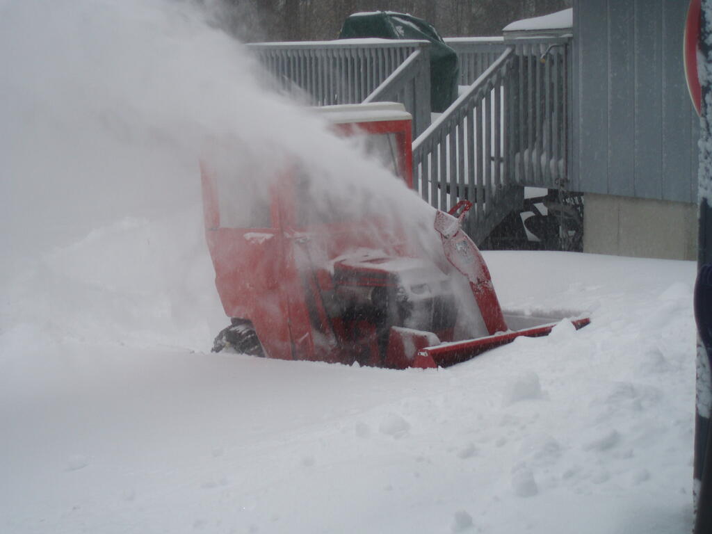

squonk 46,729 #6 Posted June 4, 2021 I had one 520. If your good with electric you should be able to keep it running. Pay attention to the bolts that hold the PTO end plate on the engine for loosening up. It happened to me. Lucky for me I noticed it when I just drove the tractor out of the shop so I could sweep the floor. I still had the snowblower and cab on. Lost about a quart of oil in a minute. If that happened when I was snowblowing, it would have blown up! 1 Share this post Link to post Share on other sites

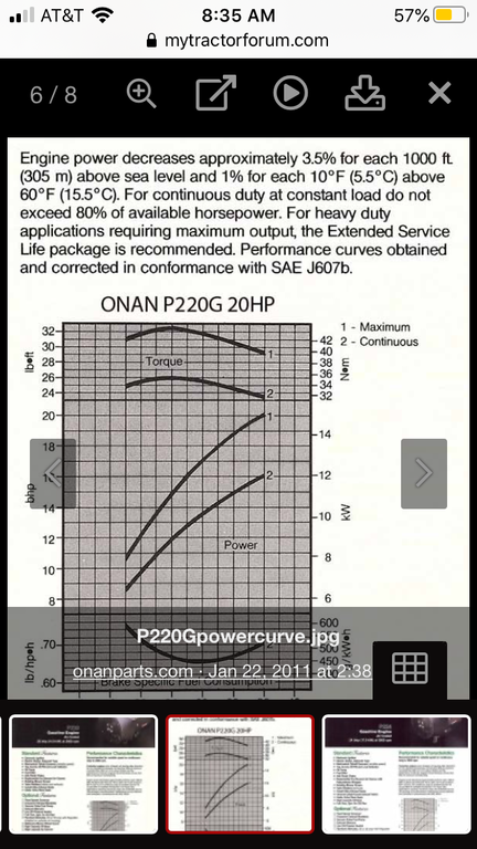

onanparts.com 185 #15 Posted June 5, 2021 On 6/3/2021 at 3:25 PM, Daron1965 said: I found a 520H in very good shape. Some rust on the deck. 653 hrs. Original tractor with hubcaps. Asking $950 Im not real familier with them. Can you guys please tell me the good and bad? I may make it a garden plow tractor if I get it. What do you think. At 653 hrs the Onan is barely broke in! An abused Onan will go several thousand+ hours no problem. A properly maintained Onan can easily make it to 3000-4000 hrs. They were designed to be rebuildable. New parts are still made here in the U.S.A. and that is a factor in the cost. Cummins/Onan has not gone offshore. Only a few exceptions are carbs and coils. Made in Japan since the mid 1980's. Everything else made here! They have stood the test of time, many decades.:) The comment about imported aftermarket gaskets is spot on. Avoid them! They are cheap to buy for a reason. Crappy materials. Same goes for any of the garbage Chinese knockoff Onan parts. Failure rate is high. Used Onan parts are out there in the millions! New and NOS, New Old Stock parts, are easy to get. The older Onan's and WH GT's are an investment. They are worth keeping alive. :) 1 Share this post Link to post Share on other sites
