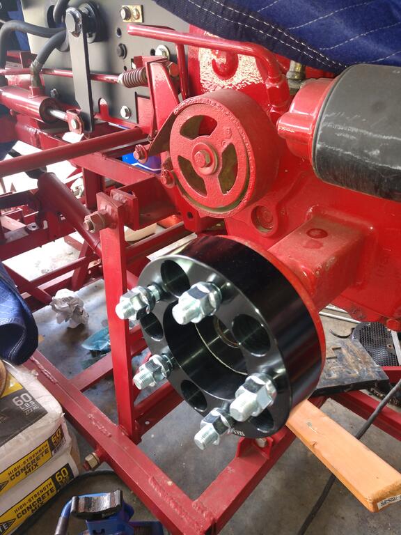

kpinnc 19,036 #5 Posted June 4, 2021 5 on 4.5 pattern. I have them on 3 tractors and they are great. You'll need 7/16 button cap screws or really tall heads on the bolts to mount them, because torquing the OEM bolts is difficult because the holes are designed as bolt centric, and they set too deep in there to get onto the bolts with a socket. One more thing- if you go with automotive spacers, most have 1/2 inch studs, and our tractor wheels use 7/16 bolts. You'll have to ream the bolt holes on the wheels to 1/2 inch, but it's a small enough difference that they can still be reused with the 7/16 bolts. 5 1 Share this post Link to post Share on other sites

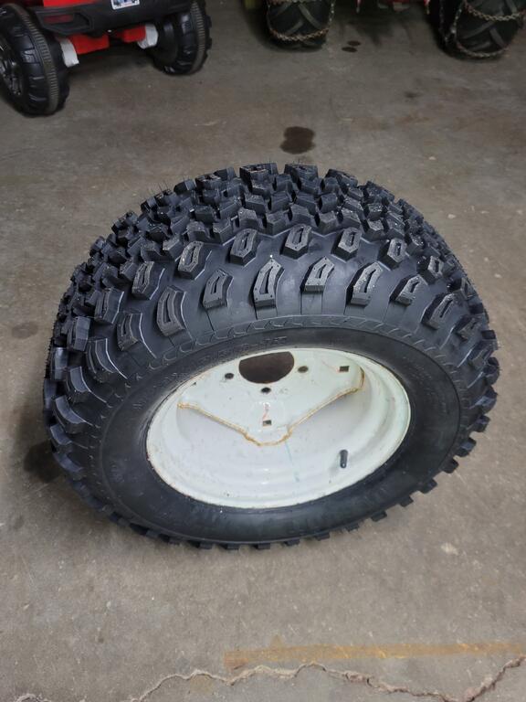

BeninCT 451 #8 Posted June 4, 2021 Amazing the level of info here as always! Thank you all for taking the time. I have a couple great tires that I mounted on a set of free wheels without checking them. Worst part is, I think I scrapped the EXACT set of spacers I would need maybe a month ago when we took them off my sons Jeep. Didnt know I needed them until a few days later anyway. Grrrrr. Will find a set and use the amazing detailed instructions here plus some great help via PM to get them on. Any good post has to have pics so here are the wheels and tires. Going to really make my 312 look nice and I’m hoping they will get me out of needing the rear tire chains when plowing my flat asphalt driveway in winter. Weights included of course. 2 Share this post Link to post Share on other sites
kpinnc 19,036 #9 Posted June 4, 2021 (edited) I would just flip those wheels around. They look like standard 7.5 wheels used on our tractors- but they appear to have been previously mounted "dish side in". Good looking tires BTW. Edited June 4, 2021 by kpinnc 3 Share this post Link to post Share on other sites
ebinmaine 81,047 #10 Posted June 4, 2021 9 minutes ago, kpinnc said: I would just flip those wheels around. They look like standard 7.5 wheels used on our tractors- but they appear to have been previously mounted "dish side in". Good looking tires BTW. Maybe a couple more pictures of the other side of the wheel? In the above post it looks like the top picture is the correct INSIDE of the wheel. Has flat spots on the area around the lug holes. 1 Share this post Link to post Share on other sites

BeninCT 451 #13 Posted June 5, 2021 5 hours ago, ebinmaine said: Maybe a couple more pictures of the other side of the wheel? In the above post it looks like the top picture is the correct INSIDE of the wheel. Has flat spots on the area around the lug holes. @kpinnc I am in FL but will measure. Not sure I considered installing them the other way.... cant wait to get home to see! Don’t have another pic.... 1 Share this post Link to post Share on other sites

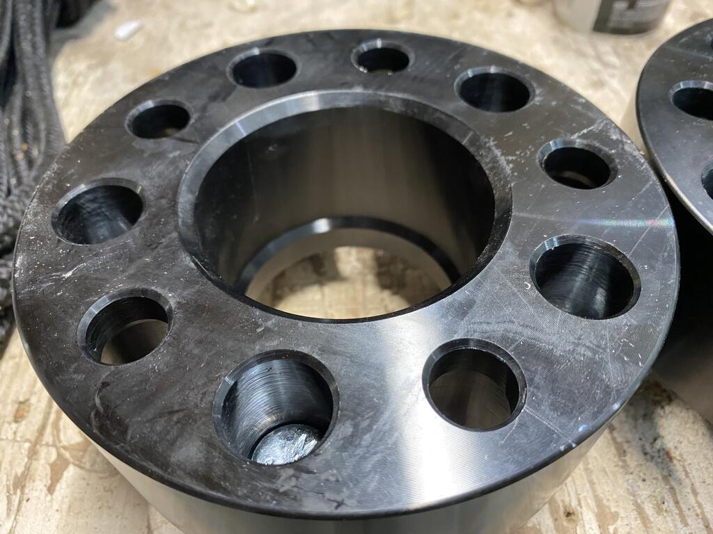

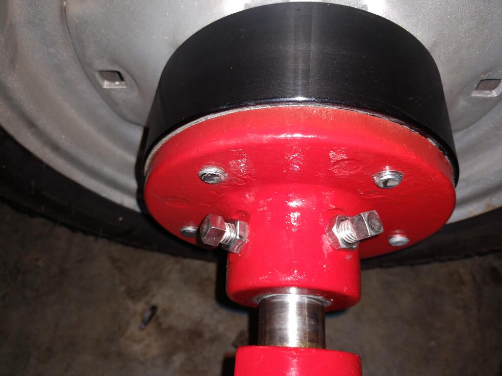

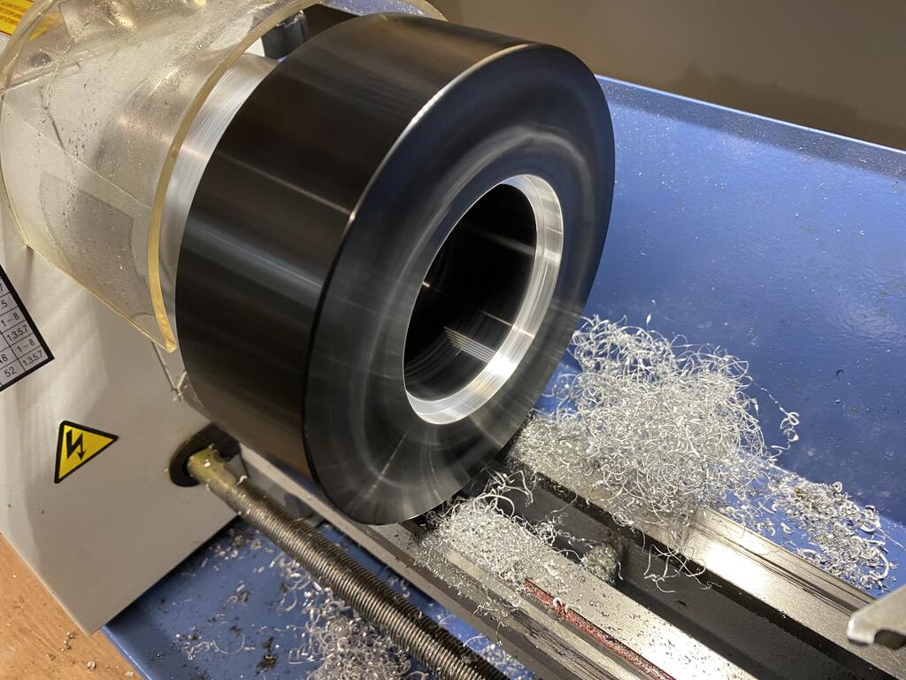

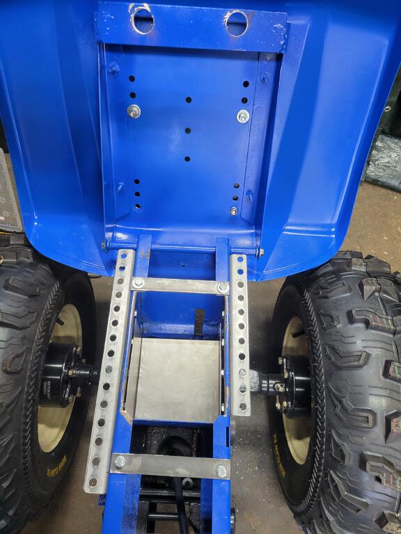

BeninCT 451 #20 Posted October 14, 2021 Finally put these on as we anticipate the fall/winter. Turned out well but in addition to drilling out the wheels fo for the studs on the spacers I had to put the spacers on the lathe and turn a little recess to accommodate the raised center portion of the axle hub. This was an added step but only took maybe 20 mins to do both and maintains the hub centric mounting rather than relying on the reamed out bolt holes. Anyway couldn’t have done it without you fellers! Thank you- Need to now make a receiver hitch weight rack and some front wheel weights and maybe some of those rubber tire chains. 2 Share this post Link to post Share on other sites

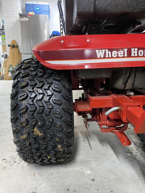

BeninCT 451 #21 Posted October 14, 2021 Wide ass looks good- 2 1 Share this post Link to post Share on other sites
