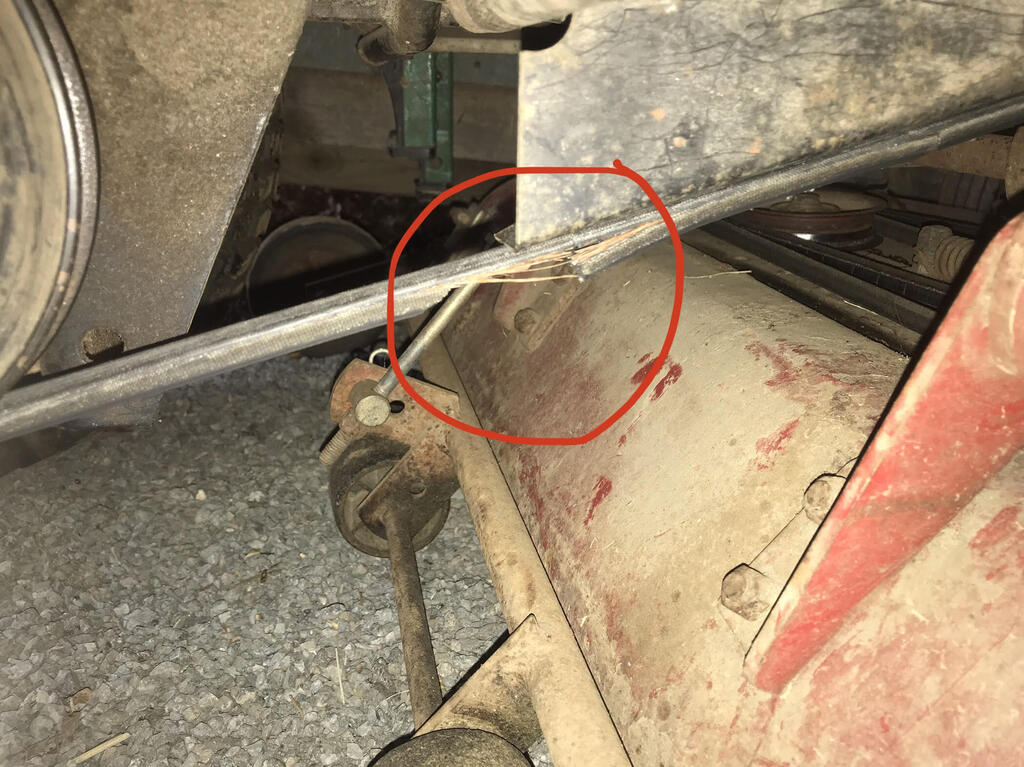

David_JH 23 #1 Posted June 2, 2021 (edited) The drive belt on my '84 GT-1100 is about to snap. I'm looking for a new belt, and I was wondering what the best brand to buy would be. I think it's an 82 inch. There are a bunch of brands (such as Husqvarna, Huskee, Craftsman, and a bunch of obscure brands I've never heard of) that make 82 in belts, but idk which one would be the best. Any thoughts? Here's a picture of the current belt. I don't want to drive it until I have a new one. Thanks! Edited June 2, 2021 by David_JH 1 Share this post Link to post Share on other sites

Handy Don 16,918 #7 Posted June 2, 2021 It may be the angle of the photo, but is that belt riding outside the belt guard? If so, it is likely rubbing up near the engine and that is a formula for premature belt failure. 4 1 Share this post Link to post Share on other sites
pfrederi 20,833 #8 Posted June 2, 2021 Looks like it on the wrong side of the guide. 3 1 Share this post Link to post Share on other sites
Pullstart 70,513 #9 Posted June 2, 2021 14 minutes ago, Handy Don said: It may be the angle of the photo, but is that belt riding outside the belt guard? If so, it is likely rubbing up near the engine and that is a formula for premature belt failure. Good eye! From that side angle, we shouldn’t be able to even see the tear... 2 Share this post Link to post Share on other sites
Jeff-C175 7,209 #10 Posted June 2, 2021 36 minutes ago, pfrederi said: Looks like it on the wrong side of the guide. I love the smell of burning rubber in the morning.... NOT! 4 Share this post Link to post Share on other sites

David_JH 23 #13 Posted June 2, 2021 2 hours ago, Handy Don said: It may be the angle of the photo, but is that belt riding outside the belt guard? If so, it is likely rubbing up near the engine and that is a formula for premature belt failure. Thanks for pointing that out! I’m pretty new to wheel horse tractors and I probably would’ve installed the new one the same as the old one. No wonder the belt is so shredded 🤣 1 Share this post Link to post Share on other sites

David_JH 23 #22 Posted June 3, 2021 16 hours ago, Jeff-C175 said: I love the smell of burning rubber in the morning.... NOT! I would catch a whiff of rubber every once in a while, but I every time I checked to see if anything was wrong, I didn’t see anything I thought looked suspicious, so I would just keep driving. And the smell would go away after a minute or so. But now I know exactly what the problem was, and I’ll make sure to install the next drive belt properly. 1 Share this post Link to post Share on other sites
