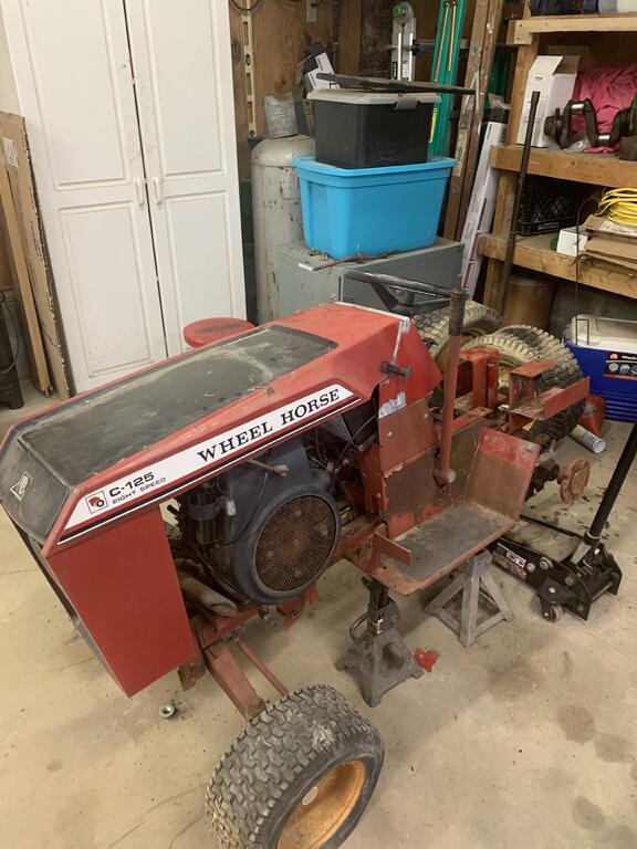

rsmall5206 6 #1 Posted June 2, 2021 Hello i recently got given to me a c-125 with 4 gears snd hi/lo range. I have tried to put it to gear but it seems to be stuck in neutral and same for the hi/lo. This has been sitting for a while outside any suggestions Share this post Link to post Share on other sites

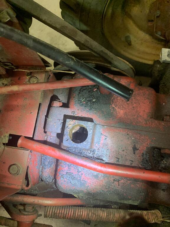

rsmall5206 6 #13 Posted June 2, 2021 Another dumb question how do you take the shifter off? The boot was completely junk Share this post Link to post Share on other sites
stevasaurus 23,746 #14 Posted June 2, 2021 There is a Dog Point set screw under the shifter boot. It has a lock nut on it. Take a long 1/8" Allen Wrench to reach in from underneath the tower and loosen the lock nut...turn out the set screw and lift out the shifter. It takes me longer to type this then to do it. 1 Share this post Link to post Share on other sites

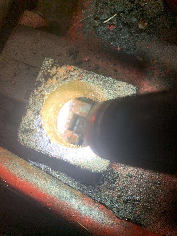

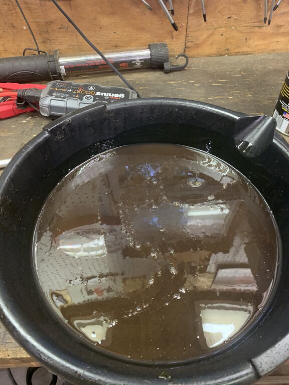

rsmall5206 6 #18 Posted June 3, 2021 Ok so I pulled the shifter was not able to pry anything. Looks rusty inside. Drained oil and bunch of water came out first then oil. Is it junk? Share this post Link to post Share on other sites
tunahead72 2,635 #20 Posted June 3, 2021 4 minutes ago, rsmall5206 said: ... Is it junk? ... Probably not, but I'll let the other guys point you in the right direction here. These trannies are tough, and respond well to repairs. I've never taken one apart myself, but there's several good videos here that will show you how, and lots of advice free for the asking, I wouldn't hesitate if mine needed to be done. 1 Share this post Link to post Share on other sites

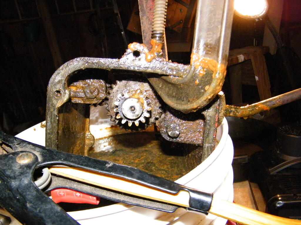

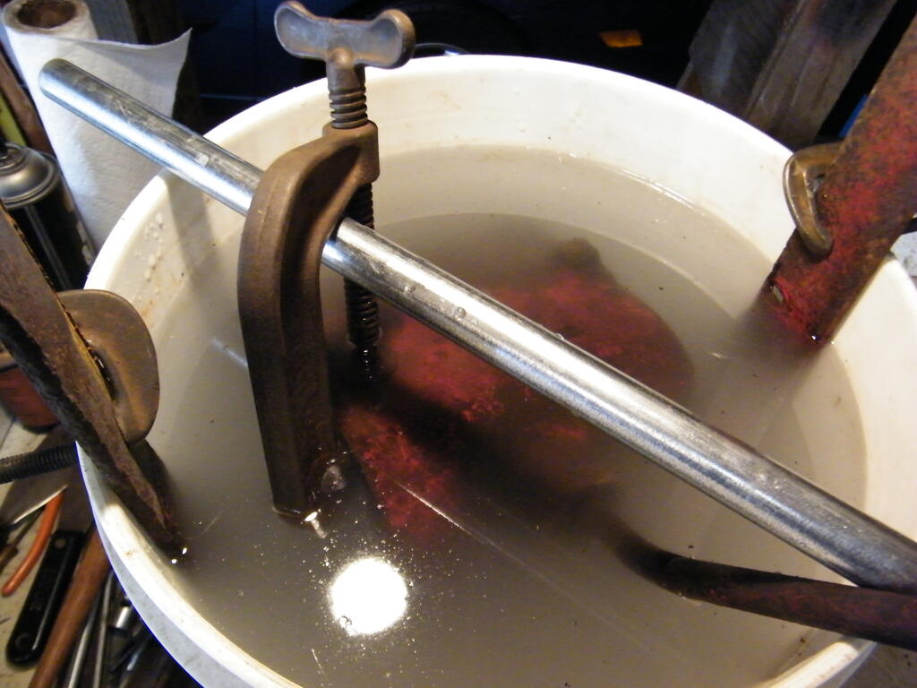

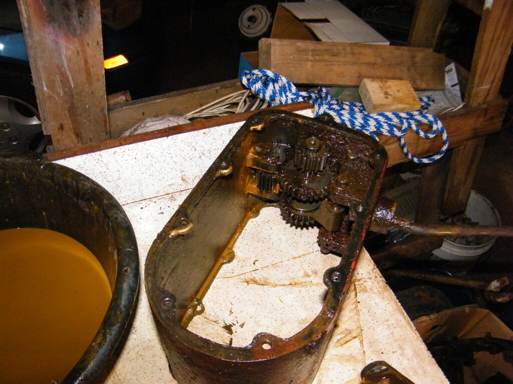

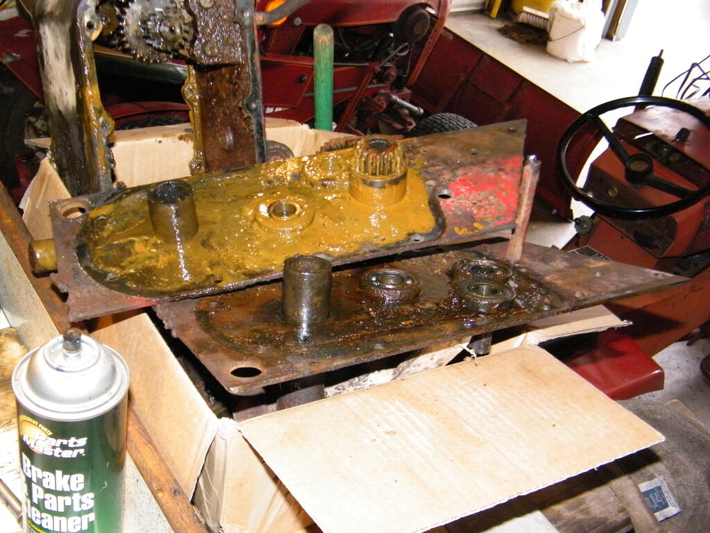

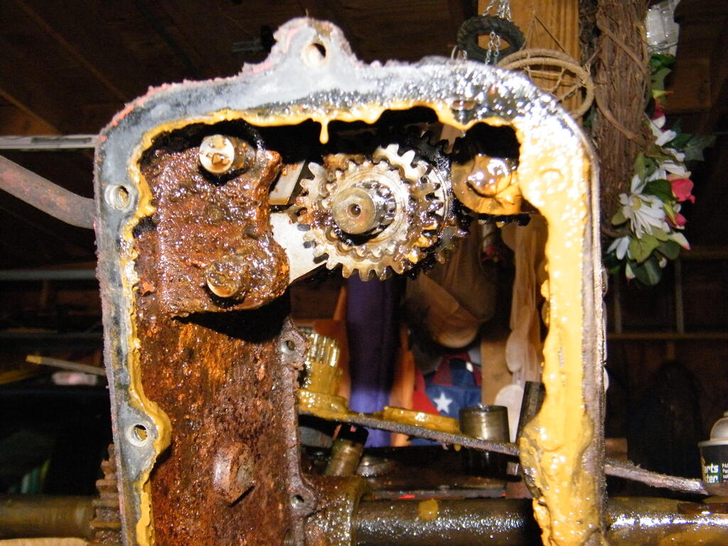

stevasaurus 23,746 #23 Posted June 3, 2021 Electrolysis is probably the answer here. It is easy and cheap. I was able to save this rusted trans... All you need is a 5 gallon bucket, a box of washing soda (not baking soda), water and a battery charger...oh, and a sacrificial piece of steel or iron. Explain the process later. This is the set up... Then the process starts... After a few days...part are rust free and movable. Just need to wire brush to put back together. The above picture is about 1/2 done. 1 Share this post Link to post Share on other sites
