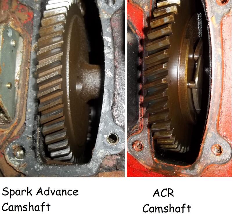

953 nut 67,488 #6 Posted June 1, 2021 10 hours ago, phil t said: guy that was helping me as soon as i turned my back started turning every screw on the carb and he did know what he was turning. Next time your friend comes over hide all the tools and duct tape his hands behind him! Looks like Ed and Jim have you covered. Be sure the ignition points are set properly, they set the ignition timing. Ignition timing on Kohler engines. Gapping the ignition points at .020 has always been the standard answer to how points should be set. That probably will get you into the ballpark where the engine will run, but with a bit of additional effort you can improve the engine’s power and performance. The Kohler engine manual in the Red Square files section covers two methods for setting the ignition timing, Static Timing and using a Timing Light. This manual is a relatively new manual and it overlooks the fact that many of our engines were built prior to the ACR (automatic compression release) camshaft. Earlier engines (mostly 1965 and earlier) had a Spark Advance camshaft that can not be timed using Static timing. At rest (and very low RPMs) the timing is retarded to fire slightly after TDC. The timing mark (SP) on your flywheel is at twenty degrees before top dead center but at rest the points on these engines break about ten degrees after top dead center. The only reliable way to check or set the timing on these engines is with a timing light. There are a couple ways to determine what camshaft you have. Presuming the camshaft in your engine is the one it was born with the data plate on the engine has a suffix that can tell you what camshaft was used. The table below will tell you the suffix applicable to your engine. The other way to determine what camshaft you have is to remove the cam gear cover and take a look. If you see a mechanism attached to the cam gear it is the ACR cam. The following engines have the spark advance camshaft; K-141, Suffix prior to “C” K-161, Suffix prior to “J” K-181, Suffix prior to “D” K-241, Suffix prior to “D” 1 2 Share this post Link to post Share on other sites

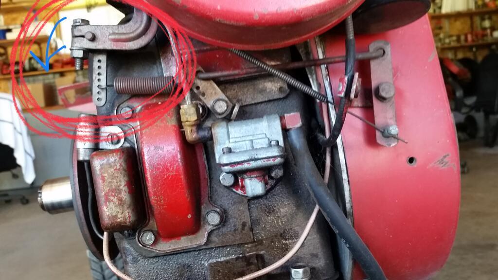

ptracy70 2 #10 Posted June 2, 2021 Thanks for all of your advice. i went out and reset points and governor and its running 80% better. im going to buy new points and condenser im sure that will help also. for some reason, after having the engine off and then put on, i dont have full throttle position on dash? i have some older pictures i took before i removed it and ill try to match where stuff was.it only goes half way. i wish i could post a video of before and after.on here to show how good or bad its running. let me know if i can.thanks again.phil. 1 Share this post Link to post Share on other sites
