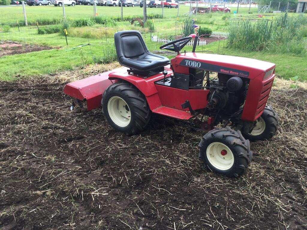

JimmyJam 542 #1 Posted May 31, 2021 (edited) So I have a tiller that I use for our community garden each spring. I use my C-121 (12hp, 8-speed) to do so. Easy, peasy with a composted, mulched rich soil. However, my question is has anyone used a 1976 B-80, 8-speed and tiller on a dense clay, virgin garden? Or it better to use a moldboard plow and disc harrower? Can a B-80 perform that duty? 1st photo is my C-121 at Community Garden. Last photo is my 1976 B-80 used to plow snow (unfortunately under-powered to push wet, heavy deep snow...I swapped their duties). Edited May 31, 2021 by JimmyJam 2 Share this post Link to post Share on other sites
