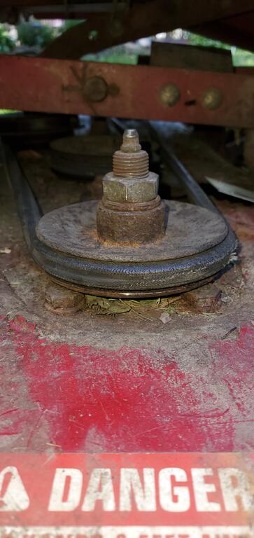

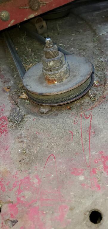

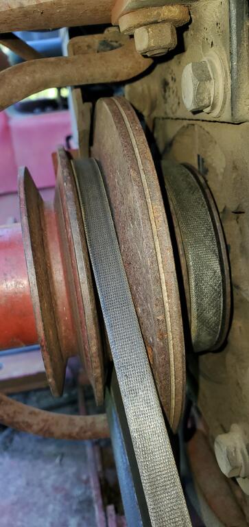

chobeegators 5 #6 Posted May 31, 2021 (edited) Here are some pictures. Not sure if this is what you were wanting. Edited May 31, 2021 by chobeegators Forgot to add photos Share this post Link to post Share on other sites

daveoman1966 3,884 #8 Posted May 31, 2021 You could start by getting an OEM deck spindle drive belt. The one you have is SHOT...I can see that it has rolled-over and THAT ALONE may be your whole problem. 1 1 Share this post Link to post Share on other sites

OutdoorEnvy 1,816 #10 Posted June 1, 2021 On 5/31/2021 at 3:36 PM, chobeegators said: Here are some pictures. Not sure if this is what you were wanting. Is that belt on right? looks like it may be on backwards maybe? Can't tell but it should be flat on the outside you can see. The V part should be inside the pulley. Share this post Link to post Share on other sites
chobeegators 5 #11 Posted June 1, 2021 36 minutes ago, OutdoorEnvy said: Is that belt on right? looks like it may be on backwards maybe? Can't tell but it should be flat on the outside you can see. The V part should be inside the pulley. This is the one I just replaced. It had rolled over on itself. Share this post Link to post Share on other sites
Jeff-C175 7,209 #12 Posted June 2, 2021 (edited) @chobeegators Your PTO clutch material looks very thin in the photo and if it's getting very hot it's probably slipping. But you've also got a problem with the deck belt apparently. Note the thickness of your friction material, not much left of it. Probably been riding the rivets for a LONG time. Here's the new one that I just installed. Friction material is thicker than the backing plate: This is the one that came out, note that it is not quite, but durn near down to the rivets, and it's STILL a LOT thicker than yours! It's real easy to pull the PTO bell to inspect it. And, while you have it off, re-grease the the roller bearing with some Lucas "Red N Tacky" grease. You only need a little bit, don't overdo it. Edited June 2, 2021 by Jeff-C175 1 1 Share this post Link to post Share on other sites

chobeegators 5 #15 Posted June 3, 2021 23 hours ago, Jeff-C175 said: @chobeegators Your PTO clutch material looks very thin in the photo and if it's getting very hot it's probably slipping. But you've also got a problem with the deck belt apparently. Note the thickness of your friction material, not much left of it. Probably been riding the rivets for a LONG time. Here's the new one that I just installed. Friction material is thicker than the backing plate: This is the one that came out, note that it is not quite, but durn near down to the rivets, and it's STILL a LOT thicker than yours! It's real easy to pull the PTO bell to inspect it. And, while you have it off, re-grease the the roller bearing with some Lucas "Red N Tacky" grease. You only need a little bit, don't overdo it. Thank you for the pictures, that helped me out a lot. Going to start looking for new friction material tomorrow. Share this post Link to post Share on other sites
