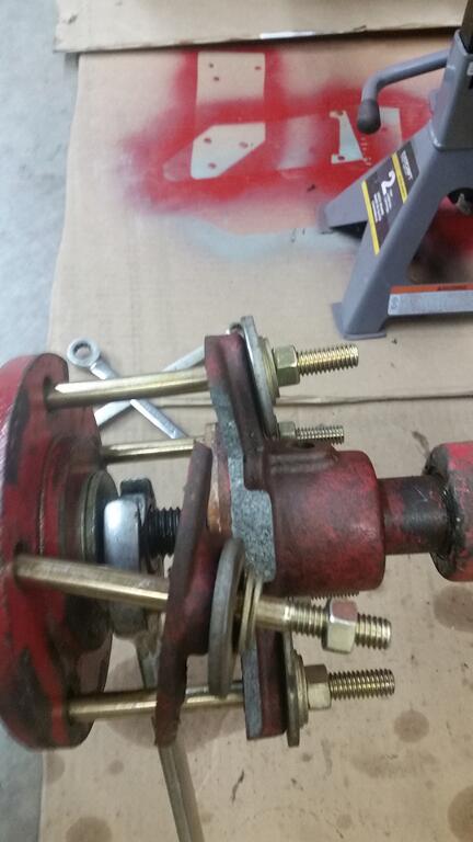

GMcC 13 #1 Posted May 30, 2021 Recently purchased a 1973 Wheel Horse 12-8 ( no name/Raider) . 1st timer thus getting my feet wet. Rear axle seals leaking, attempted to remove left hub ( removed set screw, filled hole with penetrant oil over the course of week, secured a hub puller, heated up and still the flange broke ) Thus question is; can I split the case to remove the axle to permit me to place it into a press in order to remove the balance of the hub ? Been viewing a manual I downloaded, but it was a scanned copy thus images somewhat blurry. I do consider my mechanical skills pretty good and do not mind a challenge. Just looking for some “been there done that” advice. Thanks in advance. Share this post Link to post Share on other sites

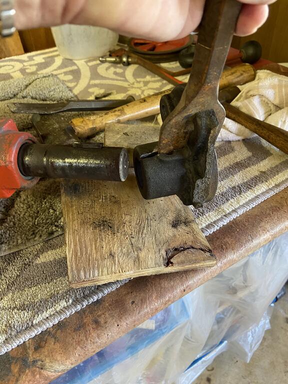

stevasaurus 23,739 #6 Posted May 30, 2021 Make sure your axles are 1 1/8"...they should be. You could place an add in the Classifieds / Wanted Section, Or get in touch with A-Z Parts...he is one of our Vendors. Check the Vendor Section. When I cut off hubs, I use a 4" grinder, cut in 2 places and then use a cold chisel to crack the hubs. It is an easy job. 2 Share this post Link to post Share on other sites

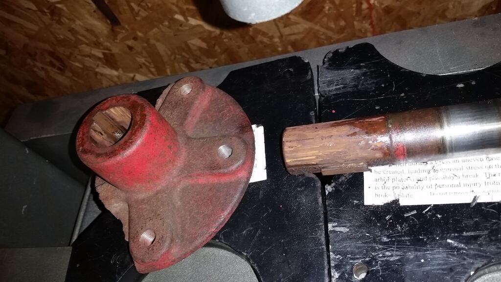

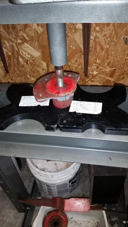

GMcC 13 #8 Posted May 30, 2021 Success, finally. Cutoff wheel through keyway, cold chiseled into the “slot”, somewhat split open to some degree then finessed the hub off!! One down, one to go. 2 1 Share this post Link to post Share on other sites
stevasaurus 23,739 #9 Posted May 30, 2021 You can open the trans, take the differential apart, un snap the "C" clip and pull out the axle with the hub still on. Maybe press it off with out breaking. Nice job cutting the bad hub. Thanks for the pictures. 1 Share this post Link to post Share on other sites

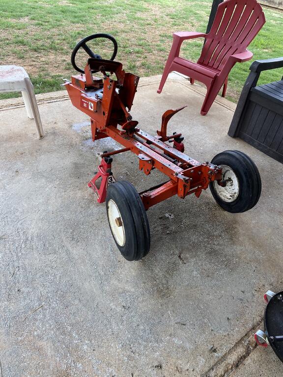

GMcC 13 #11 Posted May 31, 2021 (edited) Started on left side, old habits( drivers side). Did not even attempt to pull rt side as was warmed up with the cutoff wheel and went to town on it. Figured now that tranny is on bench might as well go all the way with freshening up the whole tractor. Edited June 2, 2021 by GMcC 1 1 Share this post Link to post Share on other sites
