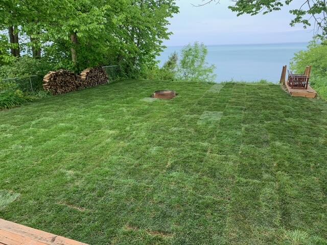

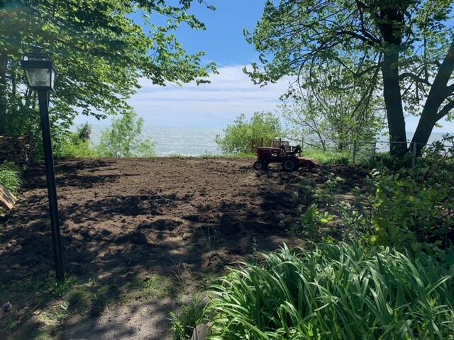

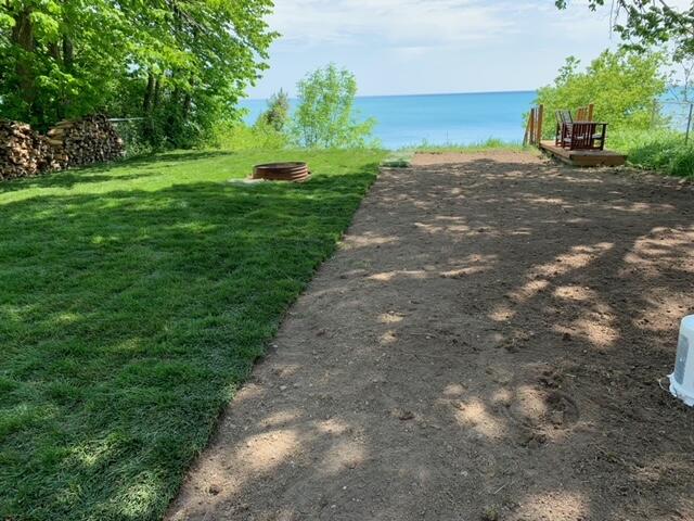

ondeadlin 32 #12 Posted June 3, 2021 Pictures! As requested ... Used the tiller and the belly blade to remove a lawn of weeds this weekend, and then laid sod. 1 3 Share this post Link to post Share on other sites

Handy Don 16,601 #14 Posted June 3, 2021 (edited) 3 hours ago, ondeadlin said: Pictures! As requested ... Used the tiller and the belly blade to remove a lawn of weeds this weekend, and then laid sod. If the weeds were thriving and not scraped off for discard elsewhere, you may have just tilled in all their seeds and "planted" them under the sod. it may take a year or so, but probably "they'll be back". Very inviting spot with a terrific view. Lake Michigan? Edited June 3, 2021 by Handy Don Share this post Link to post Share on other sites
ondeadlin 32 #15 Posted June 3, 2021 (edited) 2 hours ago, OutdoorEnvy said: Wow! Killer view! That is really pretty. I hope that wood walk way goes down to a walleye catching machine Thanks! That's Lake Huron in the background and where we are the wave action is too strong for anyone to have a dock. I get out there in the canoe once in a while, though, and there's decent fishing right off the shore. And I do love that view. Even as I was raking (and raking and raking) this weekend, I was feeling lucky to be doing it with that view. Edited June 3, 2021 by ondeadlin Share this post Link to post Share on other sites
ondeadlin 32 #16 Posted June 3, 2021 (edited) 22 minutes ago, Handy Don said: If the weeds were thriving and not scraped off for discard elsewhere, you may have just tilled in all their seeds and "planted" them under the sod. it may take a year or so, but probably "they'll be back". Very inviting spot with a terrific view. Lake Michigan? I did work pretty hard to scrape/rake and discard the vast majority of the old "lawn." Which was a PITA, of course, but ... yeah, you're right, it'll be the better move long-term. It's Lake Huron, off Michigan's thumb. We've got a little three-season A-frame that's just behind that lawn, old school 50-foot wide lot, long and narrow. Edited June 3, 2021 by ondeadlin 2 Share this post Link to post Share on other sites
