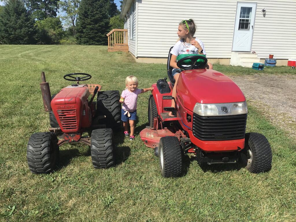

Pullstart 66,318 #2 Posted May 28, 2021 (edited) The Xi models are pretty much all proprietary to their own attachments, unless you’re handy enough to make different mounts. Most things like blowers and decks are the same as previous models, but the mounts are much wider and beefier. I think the Ford/New Holland GT tractors (GT20/GT22) were just rebadged Xi models, so that’s a possibility too. Edit* pictures... it’s amazing how much larger the Xi series really is than previous models! Edited May 28, 2021 by pullstart Photos Share this post Link to post Share on other sites
