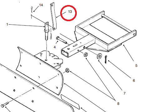

Stepney 2,356 #26 Posted May 29, 2021 9 hours ago, rmaynard said: I'll grab a photo next time I take it out. The 57 Economy and the Case have kinda put the Horses out of a job, except for mowing, at this point. I cut the weld on the downpressure bar and found a shackle that's just the right width and depth. Put a notch in the bar, so all I have to do is reach under, and slide it over the notch. Then just thread the screw through it. Most of my Horses are hydro lift though. So with them, I just use a section of chain. I prefer to use my foot for downpressure, the 50" blade never seems to cut just how I want it so I have to manipulate it. 2 Share this post Link to post Share on other sites

71_Bronco 1,072 #38 Posted August 3, 2021 I think what they should have done, is make the post a threaded stud. Then retain it with a washer and a lock nut, so you could easily put the nut on with a ratchet + extension. Lock nut would prevent it from vibrating loose. I have small hands, and its a bit of a pain even for me to reach in and put the hairpin clip in. Most times I use a pair of long needle-nose to try to pop it in. Share this post Link to post Share on other sites
