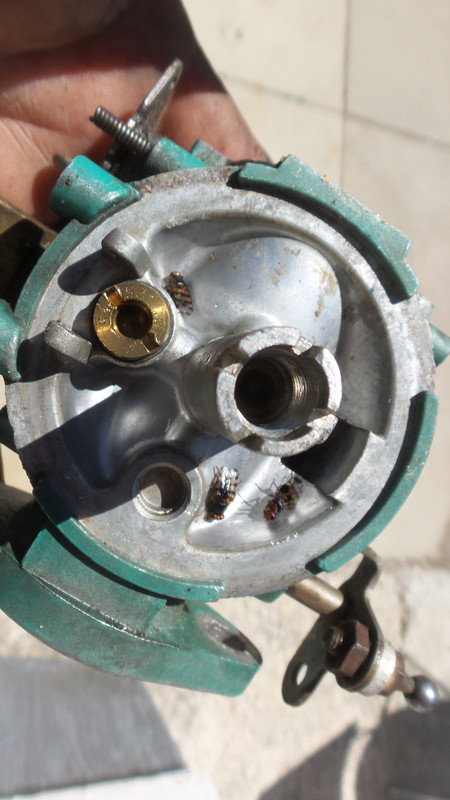

bc.gold 3,406 #1 Posted May 27, 2021 (edited) Barn find this carburetor perfect throttle body bushing and shaft decided to install on the Alis 720, installed the carburetor floods removed and disassembled found flies were causing the problem. Edited May 27, 2021 by bc.gold 1 2 Share this post Link to post Share on other sites
Maxwell-8 4,371 #2 Posted May 27, 2021 You never know what the cause a problem can be haha But how to the got in there? 1 Share this post Link to post Share on other sites
bc.gold 3,406 #3 Posted May 27, 2021 8 minutes ago, Maxwell-8 said: You never know what the cause a problem can be haha But how to the got in there? That has me puzzled as well. Share this post Link to post Share on other sites
pacer 3,179 #4 Posted May 27, 2021 That beats my find of a dirt daubers build inside a cylinder ---- at least they had an access - the spark plug had been left out. But .... FLIES ... in a carb???? Share this post Link to post Share on other sites
