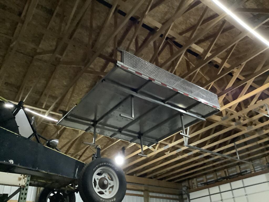

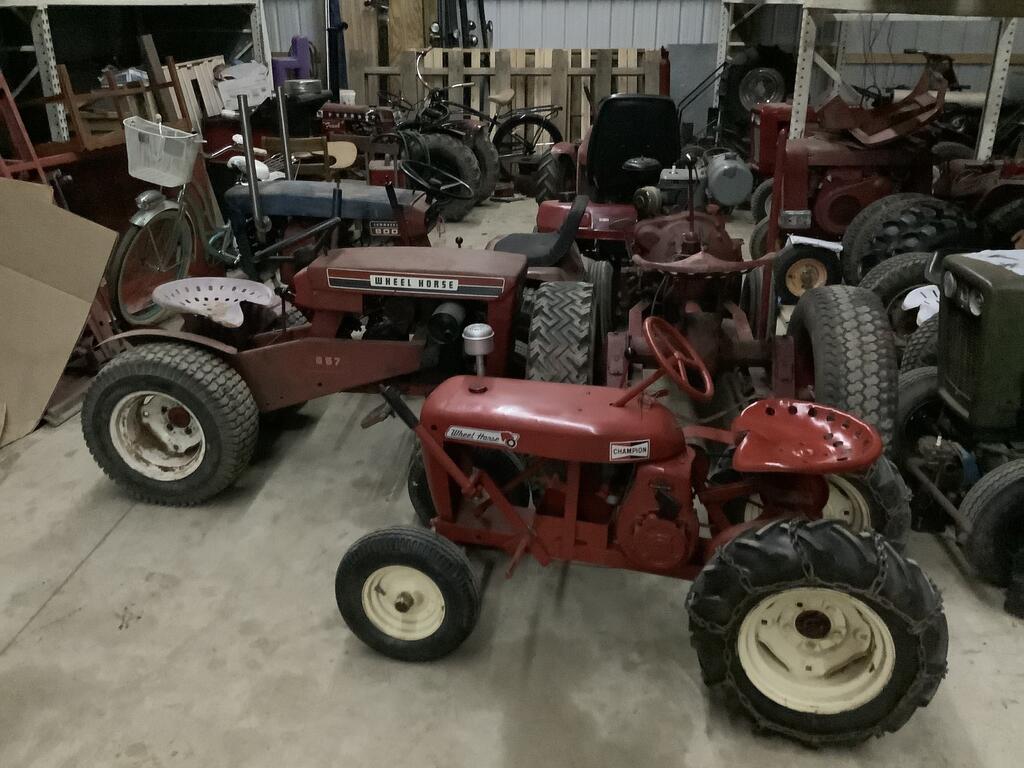

Pullstart 71,117 #131 Posted June 9, 2021 Early, I know... but I’m playing with layouts. With the Senior, gas jugs and genny in the back of Norman, I think I can get 5 tractors including the lever steer, a FEL and a walk behind on the flat bed. Now figuring out where to put ramps and a spare tire... 1 1 Share this post Link to post Share on other sites
Achto 32,360 #132 Posted June 9, 2021 (edited) 7 hours ago, pullstart said: Now figuring out where to put ramps and a spare tire. Can you make the ramps so that they stick into or hang off from the stake pockets on the flat bed? Edited June 9, 2021 by Achto Share this post Link to post Share on other sites
Achto 32,360 #133 Posted June 9, 2021 (edited) 11 hours ago, pullstart said: and if they are 5/8”? Last line from the article that you posted earlier. • Reinstall the wheel. Torque lug nuts to 175 lb-ft. I believe factory spec is 140 lb-ft, These are dry specs,10% lower torque if you use never seize on the threads. Edited June 9, 2021 by Achto 1 Share this post Link to post Share on other sites
ebinmaine 80,374 #134 Posted June 9, 2021 5 minutes ago, Achto said: Can you make the ramps so that the stick into or hang off from the stake pockets on the flat bed? You set that up just right and you could make bed sides that ARE the ramps. You'd have a great way to keep the material on the bed that's supposed to be there and also extended length ramps which would be extremely handy on a flatbed that is probably a little taller than your average truck at the back. 1 1 Share this post Link to post Share on other sites
Pullstart 71,117 #135 Posted June 9, 2021 45 minutes ago, ebinmaine said: You set that up just right and you could make bed sides that ARE the ramps. You'd have a great way to keep the material on the bed that's supposed to be there and also extended length ramps which would be extremely handy on a flatbed that is probably a little taller than your average truck at the back. Kind of like Norman’s bed deck... those ramps sure are heavy! I could easily build a 12’ ramp half as light, with the right material. 3 Share this post Link to post Share on other sites

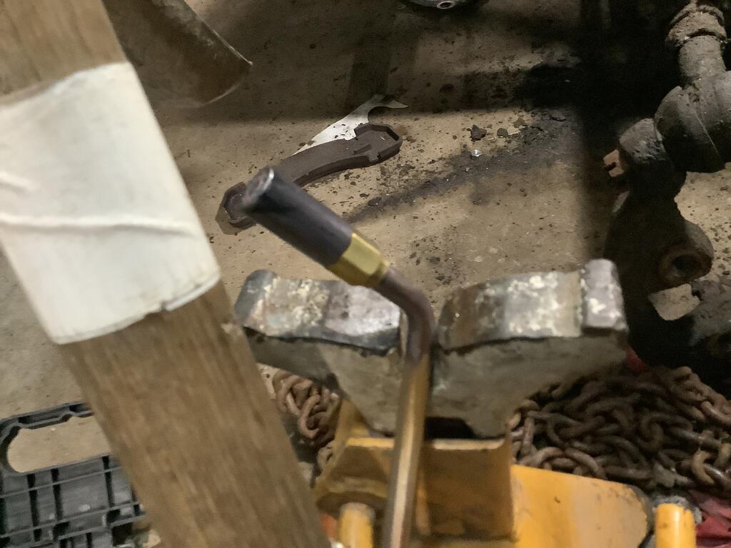

Pullstart 71,117 #136 Posted June 9, 2021 19 hours ago, lynnmor said: The jack and chains would still have a bit of give and act as a heavy spring. My idea is to have something heavy and solid under the pin. JMHO. There is hydraulic pressure under the pin, trying to drive it up and out. The chains are creating a press style application to push up. I have, however, been trying his with my little cutting tip. I found a good sized rosebud that the gas supply company said would surely work with my acetylene bottle. They sold me the next size up tip as well, but acetylene is so heavy it might not rise to the regulator quick enough to work. I also got a full bottle of oxygen, I was under 50 psi in my tank (otherwise read as empty). Either way, today I’ll be putting as much heat as I can to the axle. I’ll do this with the jack pressure relieved and my chain away from the heat, until it’s good and hot then I’ll chain and jack it. 1 Share this post Link to post Share on other sites
Pullstart 71,117 #137 Posted June 9, 2021 The new rosebud is helping and the pin is moving! Slowly but slowly! 1 3 Share this post Link to post Share on other sites

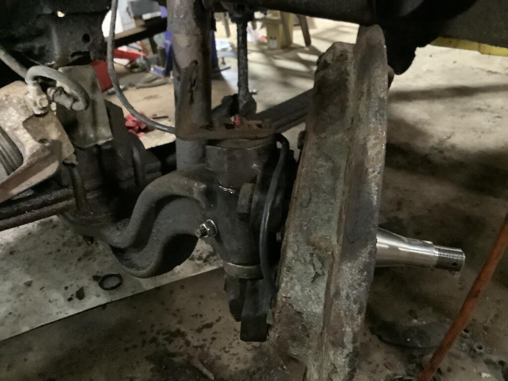

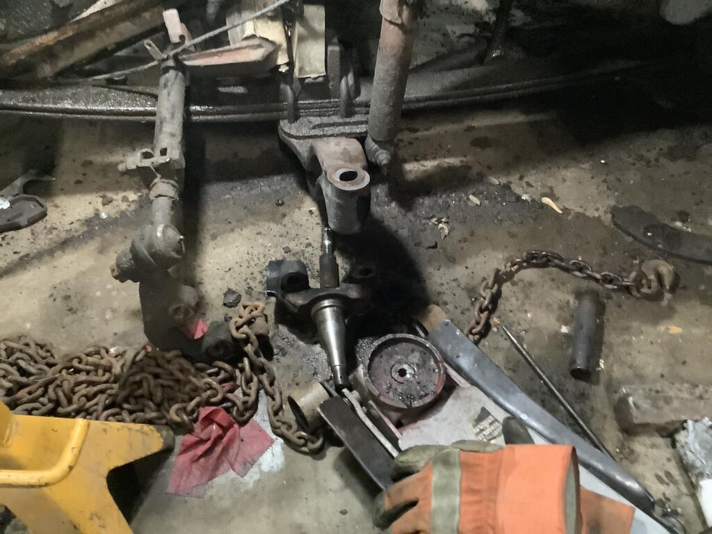

Pullstart 71,117 #138 Posted June 9, 2021 Start to finish, 33 minutes of super hot torch and big heavy hammer. My hands are toast! The pin is out! 1 7 Share this post Link to post Share on other sites
Pullstart 71,117 #139 Posted June 9, 2021 The existing grease on the top cap had to be chiseled out. Everything else was lubed quite well. Wired. I had to use my die grinder to open up the new bushings, but it’s tight! 1 Share this post Link to post Share on other sites
