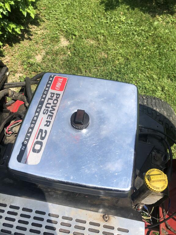

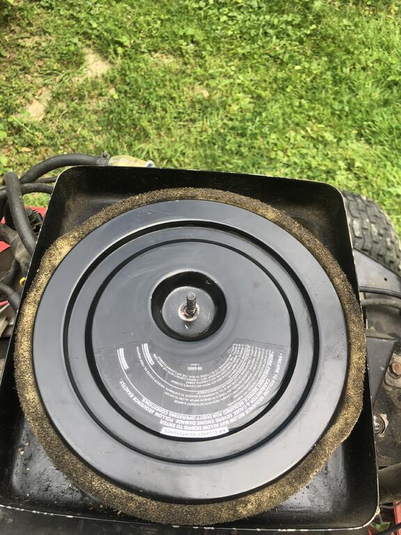

kawimaniac2145 6 #1 Posted May 26, 2021 i had a topic on another post, and have a new issue, what would cause the engine to run fine with the air filter off. when i run it at high rpm with the air filter off it runs fine, but once i put the black, or the chrome air filter on it surges at high rpm. and runs fine at idle. it also sort of runs on one cylinder when going downhill. i know i need an air filter and pre filter i am ordering one. p.s. how do i get to the carb adjustment screw. cause the muffler is in the way. pictures of air filter and carb adjustment screw. thanks for anyone who is able to help, i appreciate it alot. Share this post Link to post Share on other sites
lynnmor 8,915 #2 Posted May 26, 2021 Don't do a thing till you replace the extremely over-used air filters. The air filter light should have come on, is the hose still attached? Your engine does not have an idle mixture screw, if it doesn't run right after doing the air filter maintenance, pull the carburetor and clean it out. It may need an accelerator pump and a float adjustment or replacement. Has the valves ever been adjusted and how many hours are on the engine? 1 Share this post Link to post Share on other sites

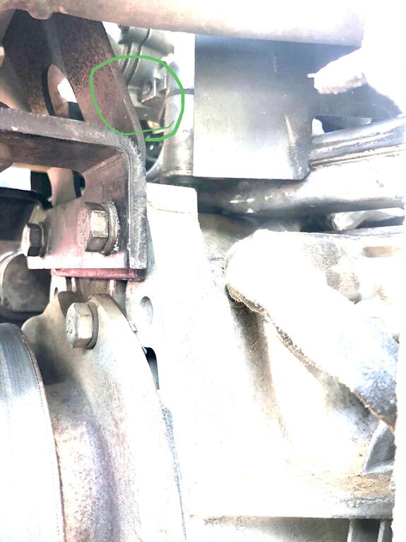

lynnmor 8,915 #5 Posted May 26, 2021 There is to be a hose from the bottom of your air filter housing to the sensor behind the instruments on the left side. See the hex shaped fitting in your first photo. The hose often breaks off the sensor nipple. You really need to do the carburetor right, my guess is that the float is way off or faulty. 2 Share this post Link to post Share on other sites
