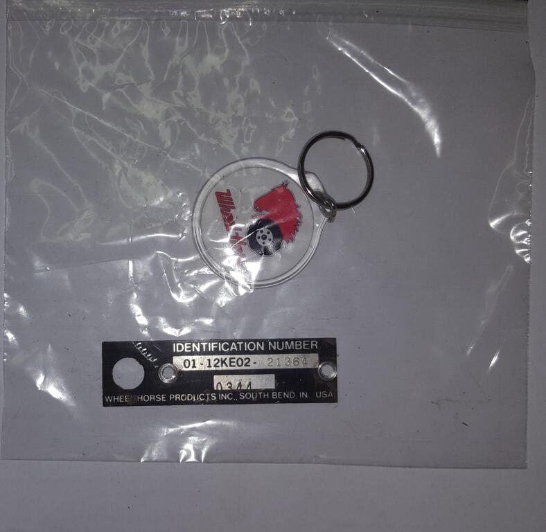

Gregor 4,848 #5 Posted May 3, 2021 (edited) 35 minutes ago, kpinnc said: "put-put-put-me-on-a-tractor"... It will be in time. Today is May 3. I put the serial number tag and new key chain in a baggie. Those are always the last 2 things I put on a tractor. It means it's done. We'll see how long this takes. I didn't even bother trying to remove the steering wheel. Once I discovered I could get my side grinder in there, I cut thee shaft in half. I knew i would at least, booger up the wheel, and the cap, trying to remove it, so I didn't try. When I rebuilt my Masseys, I got them to this point. I took them to the driveway and flipped them over about 75% on to their backs for power washing. They both have Sundstrand hydros in them. Didn't hurt them. This is an Eaton. Will flipping it over, bother it at all? Hydro systems always scare me, I just don't know enough about them. Edited May 3, 2021 by Gregor 1 Share this post Link to post Share on other sites

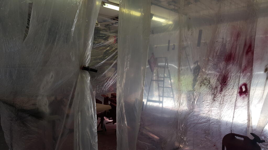

Gregor 4,848 #8 Posted May 7, 2021 My garage has been transformed into a paint booth, once again. The tin work, and larger parts are still at the blaster, but I have a lot of the smaller parts painted. Switching from red lacquer, to Rustoleum, Regal Red, is quite a change, These cans put out some paint. A LOT of paint. Maybe too much paint at times, but it sure covers nice. These parts are drying, waiting for the next batch. And my garage is a he!! of a mess. AGAIN! 3 Share this post Link to post Share on other sites

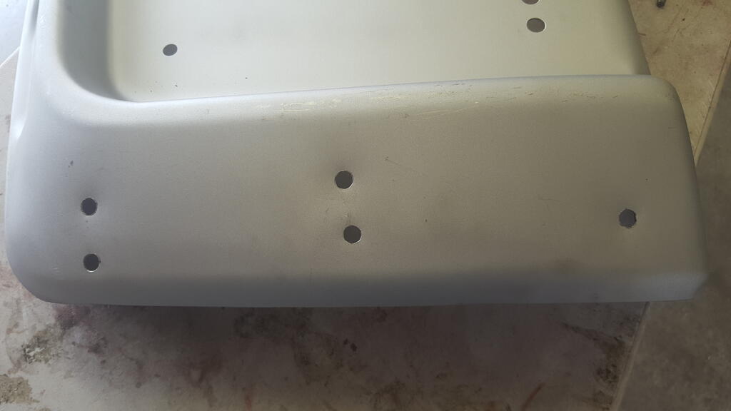

Gregor 4,848 #10 Posted May 19, 2021 I got my parts back from the media blaster today. Once again, my garage has been transformed into a paint booth. I can start painting tomorrow I didn't notice until today, someone had drilled holes in the fender pan. Although I am not too good at this, I will try to repair them. Whatever I do, has to be better than 5 holes. 1 Share this post Link to post Share on other sites
ebinmaine 79,686 #11 Posted May 19, 2021 24 minutes ago, Gregor said: drilled holes Could be used for a handy dandy mount for accessories. Maybe a horn. Spare joust holder, etc.... Share this post Link to post Share on other sites

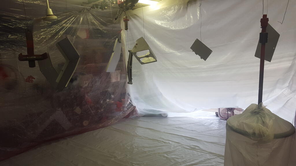

Gregor 4,848 #12 Posted May 20, 2021 My garage is no longer a paint booth. All the red is painted. The hood and everything else, is in the house, drying for a couple of days. I will try to tape off the hood, and paint the black portion, when it's good and dry. I am always happy to get my garage back. Except this time, it' been invaded by Lawn Boys. 2 1 Share this post Link to post Share on other sites

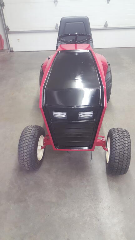

Gregor 4,848 #16 Posted May 24, 2021 The 125 is coming along, slowly, very slowly. The big hole in the middle I think is where the engine goes, but it's been so long, I can't quite remember. I don't have the black painted on the hood yet, I will attempt that tomorrow. I haven't heard anything from the machine shop, so I can't even order a rebuild kit yet. These are not the forever wheels, they are Massey wheels. I'm not sure if that is the forever seat yet or not. Haven't decided. This Regal Red seems quite a bit darker than the Chinese Red lacquer I have been using. There are a few pieces on the tin work that could have used some attention, but from past experience, I know I usually don't make them much better, I just make them different, so I left them alone. The fender pan is not original to the 125, but the original plastic one was pretty broke up. 3 4 Share this post Link to post Share on other sites

Gregor 4,848 #18 Posted May 24, 2021 I got the black painted this morning. I am not real happy with it, but it is what it is. I've always said, I don't really restore these things, I just sort-a preserve them a little longer for the next guy, who may have the talent, and equipment to do it right. Still have not heard back from the machine shop on the motor, but if this thing never moves again, at least I'll be able to see where I'm not going. 7 2 Share this post Link to post Share on other sites

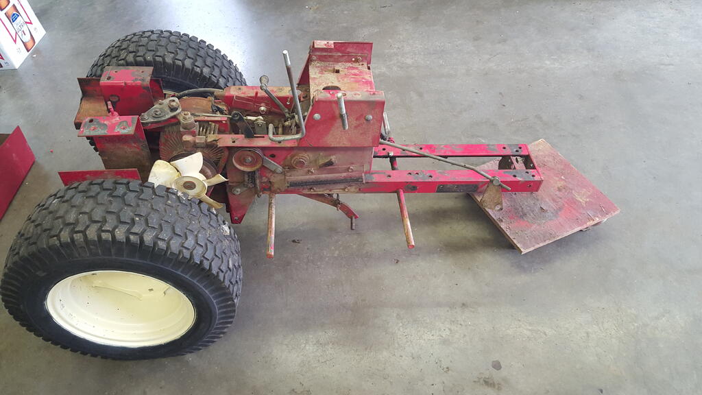

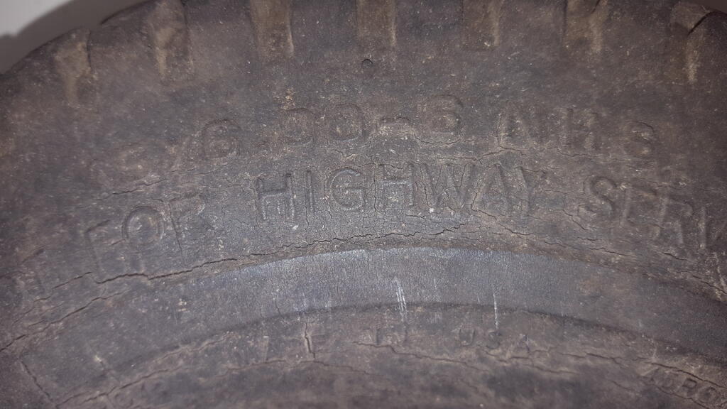

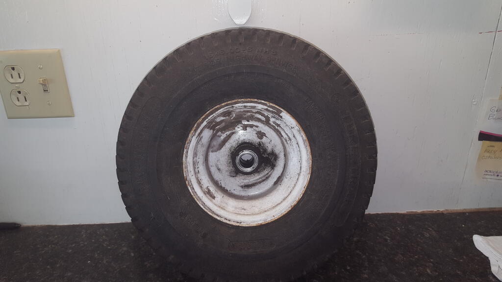

Gregor 4,848 #22 Posted May 25, 2021 I thought I had started a thread on my 175 under the "Wheel Horse Tractor" forum, but if I did, I can't find it, so I'll start over. I have been slowly amassing parts for the 175 in anticipation of getting to it after the 125 is done. These are the tires and wheels I took off the front. According to Tractor data .com, they are not correct. To be honest I didn't pay any attention to how the tractor was sitting, before I took them off. I don't know if it was low in the front or not. The tires I have on it now are from one of my Masseys. They are 16 - 6.50 X 8. The tractor does seem high in the front, but with it being jammed into storage with all the other tractors, it's hard to tell for sure. Is 15 - 6.00 X 6 the right size for this tractor? 1 Share this post Link to post Share on other sites
Jeff-C175 7,209 #23 Posted May 25, 2021 My part manual say 16 X 6.50 - 8 Share this post Link to post Share on other sites
