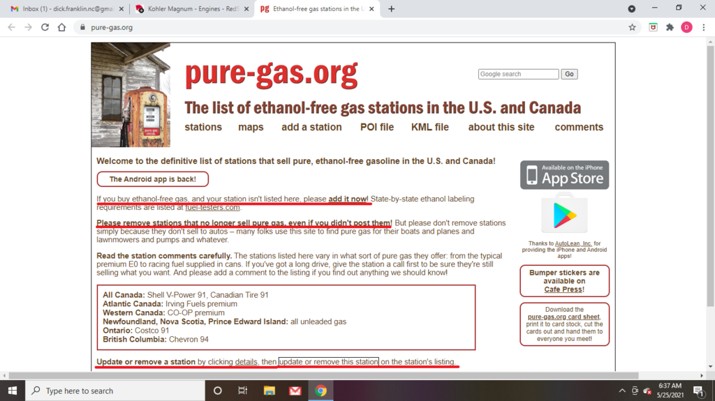

953 nut 67,488 #6 Posted May 24, 2021 If you are using gas with ethanol STOP! You can find a station that sells ethanol free gas here https://www.pure-gas.org/ 1 Share this post Link to post Share on other sites

The Tuul Crib 7,354 #9 Posted May 24, 2021 49 minutes ago, 953 nut said: If you are using gas with ethanol STOP! You can find a station that sells ethanol free gas here https://www.pure-gas.org/ How often do they update this list ? Share this post Link to post Share on other sites
953 nut 67,488 #10 Posted May 25, 2021 10 hours ago, The Tuul Crib said: 11 hours ago, 953 nut said: You can find a station that sells ethanol free gas here https://www.pure-gas.org/ How often do they update this list ? Much like RedSquare the pure-gas site is a user driven site. A new station can be added or one that no longer has ethanol free gas can be removed to keep the site up to date. If a station listing in your area isn't up to date you can do everyone a favor and correct it. 1 Share this post Link to post Share on other sites
