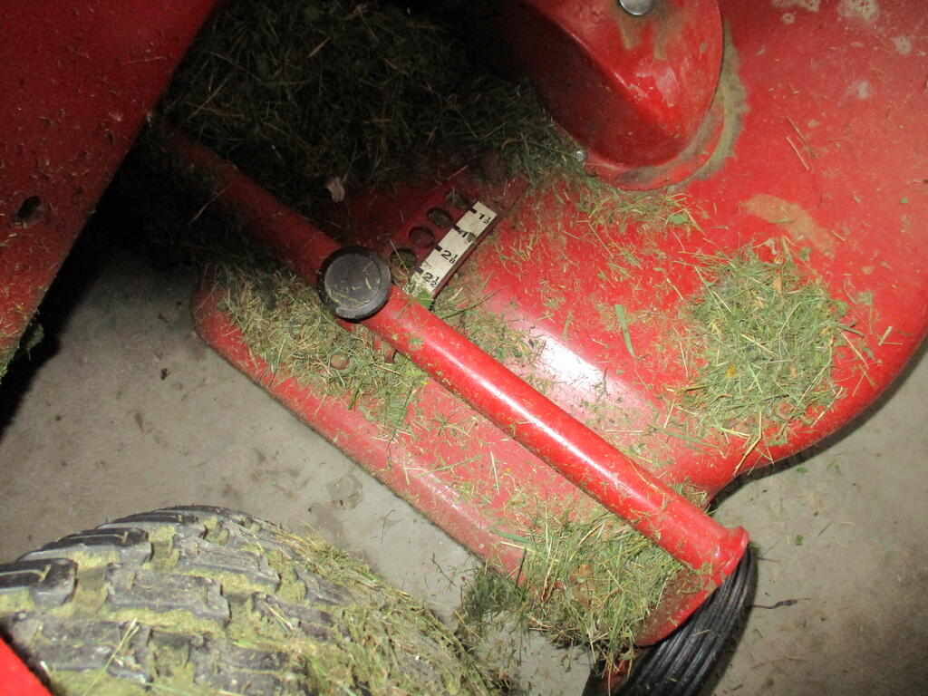

Kate 5 #3 Posted May 24, 2021 (edited) deck is 1548SC01 12795 I'll go look on the deck Yes,like #1. Edited May 24, 2021 by Kate Right picture Share this post Link to post Share on other sites

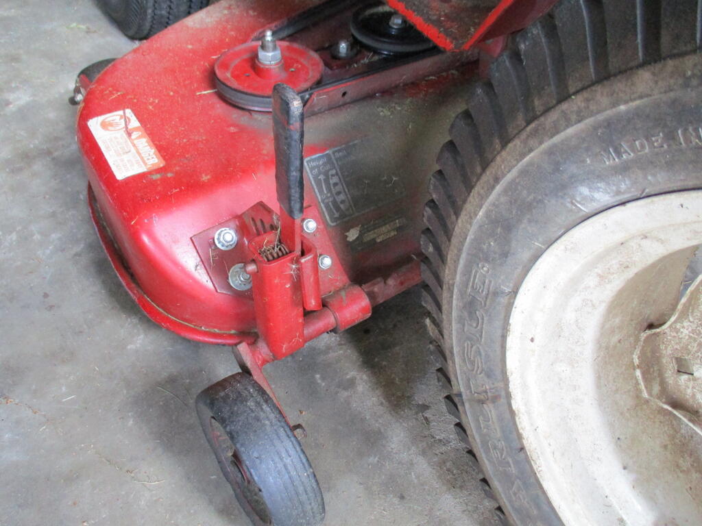

pfrederi 20,613 #4 Posted May 24, 2021 (edited) You can download the manual for your deck here. Clock on the fuzy picture below Yours is like first picture above. With deck lifted pull that lever out and move it to the rearmost hole. Edited May 24, 2021 by pfrederi Share this post Link to post Share on other sites

Kate 5 #6 Posted May 24, 2021 Now I see why this was never changed. I found the black handled piece in the corner of the shed. There is a bolt holding the height at one level. My gosh I have a mess. Guess I will mow and then rake. Thank you so much pfrederi. That made complete sense once I figured it out. I appreciate the help! 1 Share this post Link to post Share on other sites
