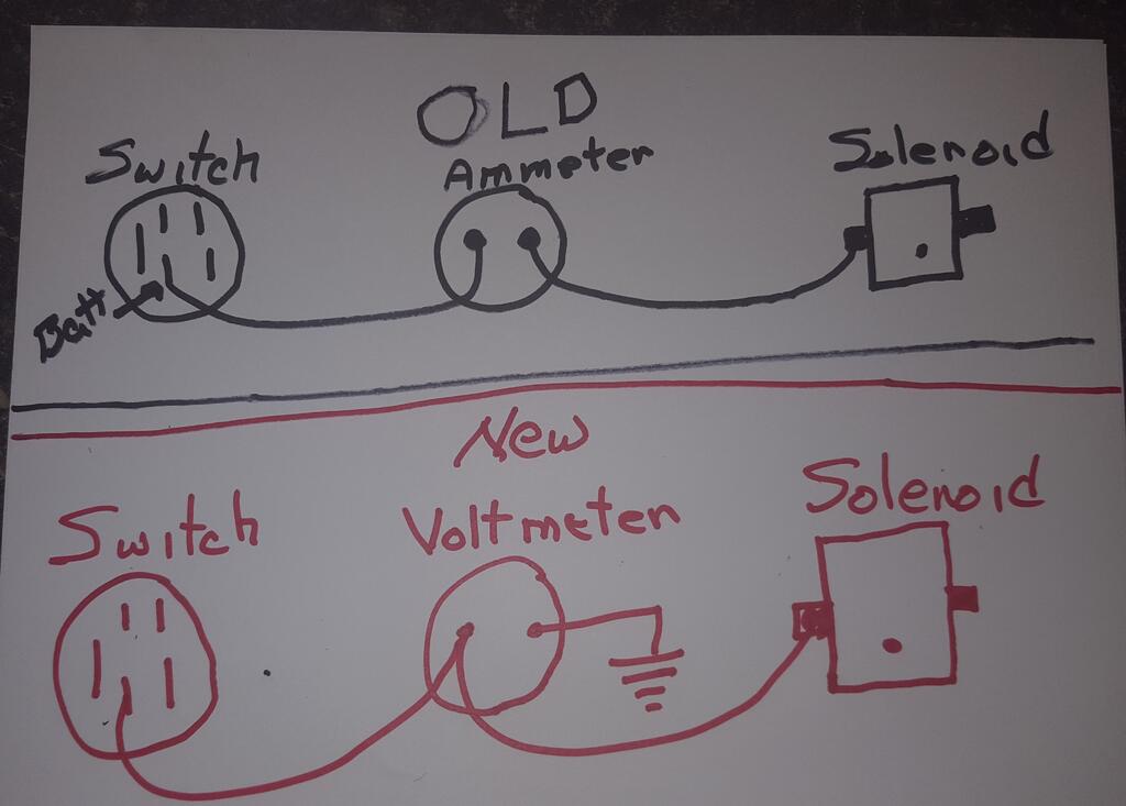

Gregor 4,848 #1 Posted May 22, 2021 I am switching my C-125 from an Ammeter to a Volt Meter. Please tell me if I am doing this right. Thanks Greg 1 Share this post Link to post Share on other sites
ebinmaine 81,281 #2 Posted May 22, 2021 Voltmeters want to be on a circuit that's only live with key on. If that's the case you're good to go. 2 Share this post Link to post Share on other sites
Gregor 4,848 #3 Posted May 22, 2021 (edited) 8 minutes ago, ebinmaine said: Voltmeters want to be on a circuit that's only live with key on. If that's the case you're good to go. I'll have to check that. I don't think it is. Might have to move it to accessories position. Edited May 22, 2021 by Gregor Share this post Link to post Share on other sites
ebinmaine 81,281 #4 Posted May 22, 2021 3 minutes ago, Gregor said: I'll have to check that. I don't think it is. Might have to move it to accessories position. I think that's where one of mine is. I don't know enough about ALL the tractor systems to say for sure... I've also used the "I" terminal. I like to have a reading while cranking the engine so I can check battery condition. 2 Share this post Link to post Share on other sites
ranger 1,871 #5 Posted May 22, 2021 If the positive battery lead is going to the solenoid, then voltmeter, then battery terminal on ignition switch, the voltmeter will show a voltage whether ignition is on or off. 2 Share this post Link to post Share on other sites
Gregor 4,848 #6 Posted May 22, 2021 9 minutes ago, ranger said: If the positive battery lead is going to the solenoid, then voltmeter, then battery terminal on ignition switch, the voltmeter will show a voltage whether ignition is on or off. Agreed Share this post Link to post Share on other sites
Tuneup 1,459 #7 Posted May 23, 2021 Attach it to the ignition ON terminal or the (+) lead of the coil but the wiring suggestion is correct. I have one on my C-125 and can check what I did (3 years ago) if you like. Nothing special to do tomorrow 1 1 Share this post Link to post Share on other sites

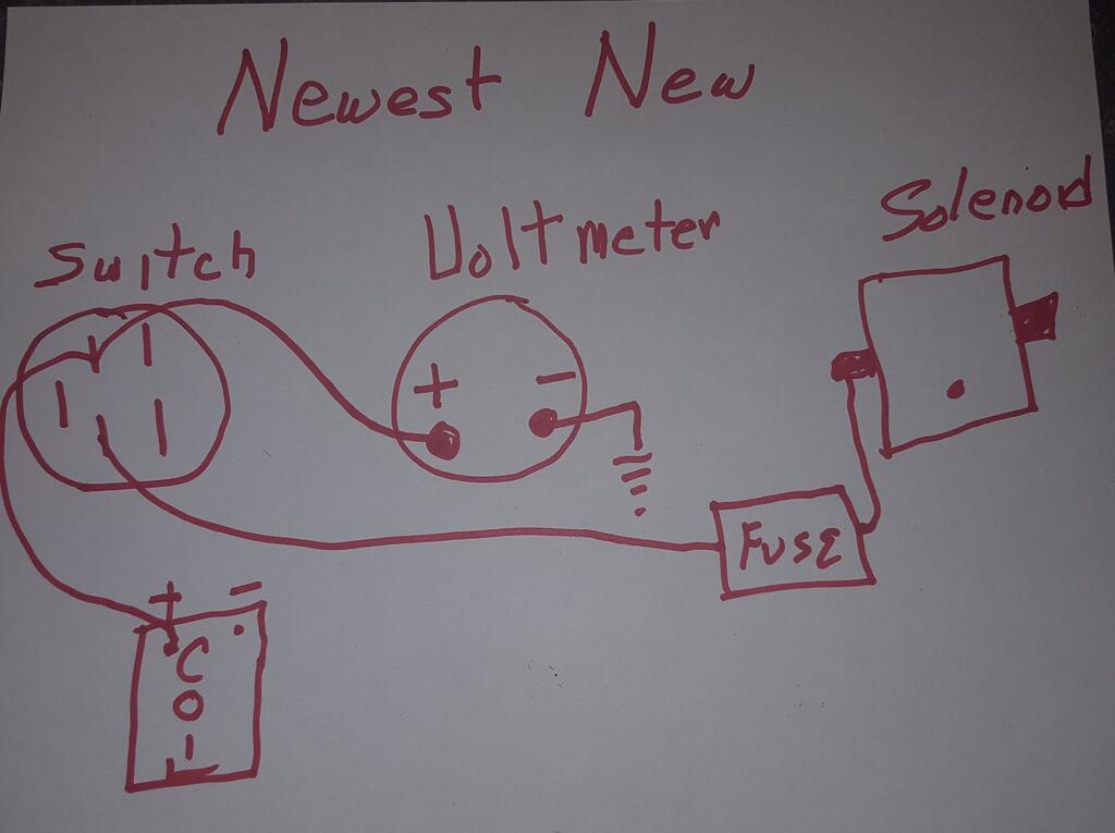

Gregor 4,848 #8 Posted May 23, 2021 My newest new. The coil wire actually goes through the PTO interlock switch, but I didn't draw that in. 3 Share this post Link to post Share on other sites

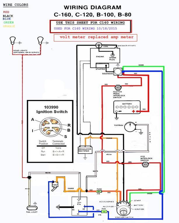

953 nut 70,651 #9 Posted May 23, 2021 @BOB ELLISON did the hard work for you, check out his drawings. First one has the amp meter, second has volt meter. 2 3 Share this post Link to post Share on other sites
Tuneup 1,459 #10 Posted May 23, 2021 Ah, yes, very nice! 1 Share this post Link to post Share on other sites
Gregor 4,848 #11 Posted May 23, 2021 I was going to go on the accessories terminal , but others suggested the ignition terminal, so I went with that. 1 Share this post Link to post Share on other sites

Gregor 4,848 #13 Posted May 23, 2021 The above wiring diagram does not show the coil wire going through the PTO interlock switch, as it appears on the diagram for the 125. 1 Share this post Link to post Share on other sites

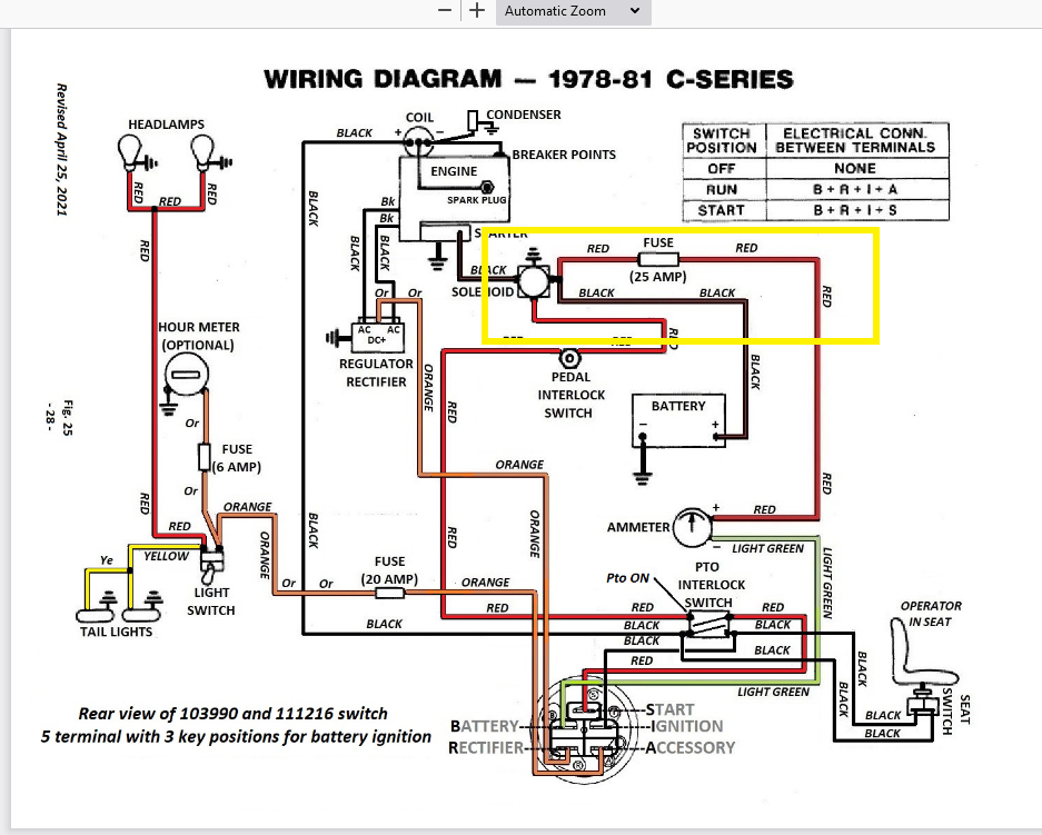

squonk 48,427 #14 Posted May 23, 2021 44 minutes ago, Gregor said: My newest new. The coil wire actually goes through the PTO interlock switch, but I didn't draw that in. That configuration is ok but be aware if the fuse blows or there is a connection problem in the fuse holder, the tractor will quit. Share this post Link to post Share on other sites
19richie66 17,951 #15 Posted May 23, 2021 Shouldn’t that side of the solenoid come from the battery positive? No fuse in the solenoid. Share this post Link to post Share on other sites
squonk 48,427 #16 Posted May 23, 2021 Assuming that connection is on the same post as the positive battery cable, That fuse will basically handle the entire electrical circuit of the tractor. Share this post Link to post Share on other sites
Gregor 4,848 #17 Posted May 23, 2021 (edited) Per wiring diagram, fuse is on the battery side of the solenoid. That's all I know. My 141 also has the fuse on the battery side of the solenoid. Edited May 23, 2021 by Gregor Share this post Link to post Share on other sites
squonk 48,427 #18 Posted May 23, 2021 (edited) That fuse is fine. The problem lies in the fuse holder. These style fuse holder: Or this: Are notorious for getting dirt, gunk, bugs broken tension springs ect. that will stop the tractor dead. Be sure to use a weatherproof holder like this: Be sure to put it where you can get at it and if you ever sell the tractor, be sure to tell the new owner about it. Edited May 23, 2021 by squonk 1 1 Share this post Link to post Share on other sites
